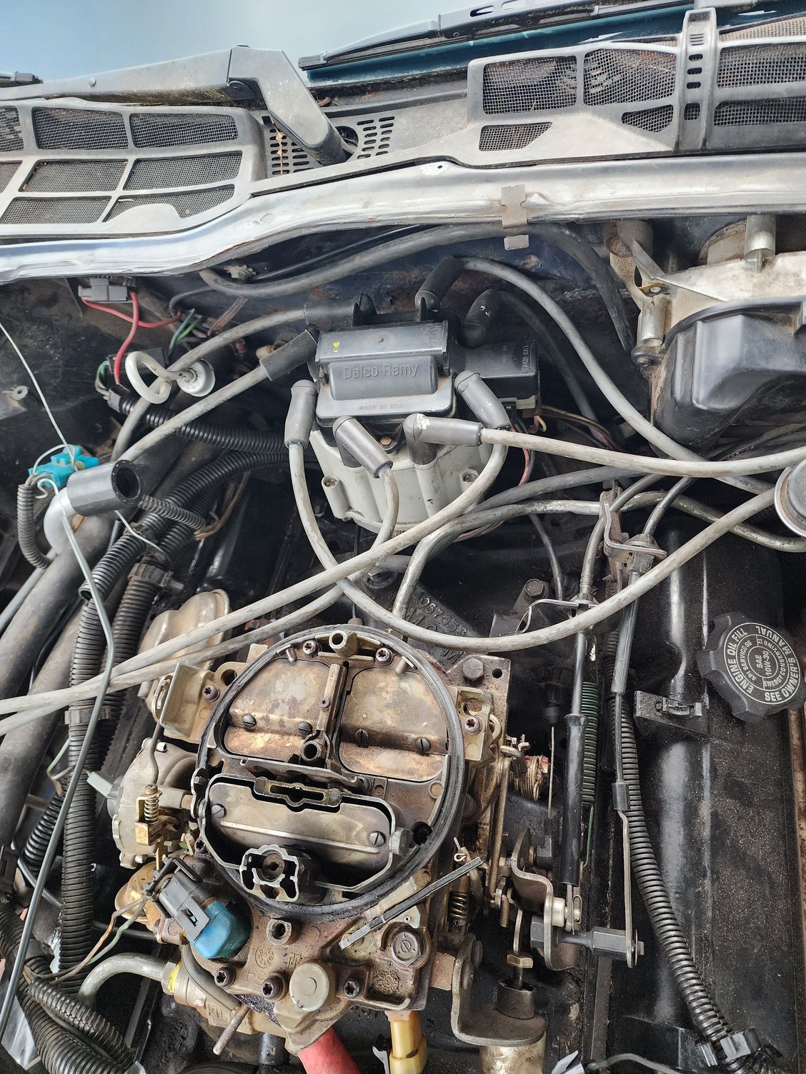

Hey yall, I got a 84 firebird 305. Bought it for the low from an older gentleman that stated he couldn't get it to run good. I bought it for $1500. Not in horrible condition. Body is clean. Original motor. Built Trans. Guy stated it had a 3200 stall and shift kit.. needless to say I started messing with it, I unplugged the EGR sensor.... rpms leveled out. Then I noticed a very...very faint popping. It has a small mis. Looking at the diagrams for the dizzy, and then the firing order I am pretty sure he's got the wires crossed somewhere. Any help would be greatly appreciated! Side note. Guy started doing an emissions delete (michigan) and never finished. I honestly don't even know where he started and finished off at. I wanted to keep everything original but I think we might throw the 383 in it.

Some more pics of it. (Yes I live in a trailer park lmao) just bought it 2 weeks ago..

Well, the plug wires DO go to the correct sides of the engine.
Check that #5 and #7 are not mixed up - easy to do.
