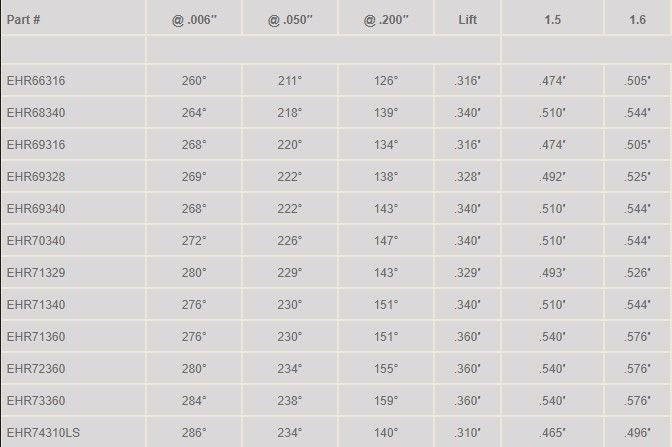

Spec 1: 286/296 on a 110 has 71° overlap. (240/250 @.050 .375/.360 lobe on a 110 LSA)
Spec 2: 277/287 on a 110 has 62° overlap. (231/239 @.050 .343/.348 lobe on a 110 LSA)
You could go any number of ways with that advertised number. I picked something that looked close and had a good fit with the .050" and lobe lift.
Note to mention the increased lift in the overlap triangle. Just a first glance I think you can see where 20 HP has gone. But I'll bet torque below peak is way up.
What's the compression ratio? Stil 10.8:1?

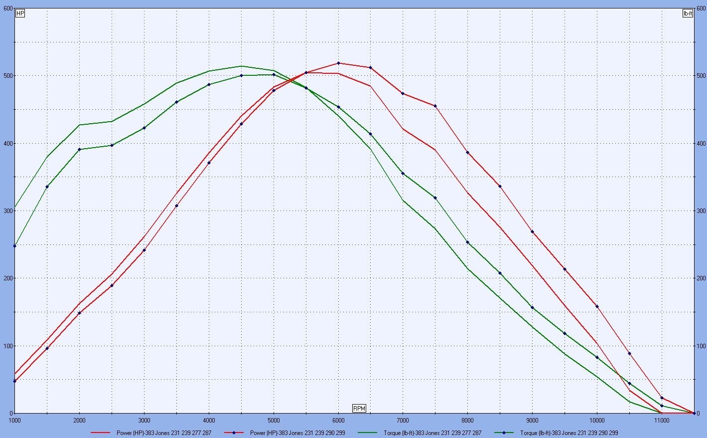

Take the actual numbers as you will. I used my heads and went with 10.5:1 with small tube open headers. Also went with a dual plane manifold. This is as it would be dynoed.
But comparatively speaking, his 20 HP loss is spot on.
And predictably, the torque is up below peak for the small cam.
That said, the larger cam would probably like a single plane intake and would easily go to 7000 RPM.

Digging into it a little further:
With a target SCR of 11:1, that smaller cam puts the dynamic compression at 8.8:1 when installed on a 106 ICL angle. (Take DCR however you want however I've found a reasonable correlation between the DCR number and this range of SBC's. DCR doesn't apply evenly across all platforms or applications)
That may or may not play nice with pump gas and everyday driving. I'd say the tune would have be spot on.

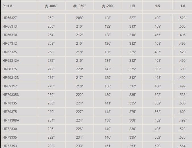

FYI he is calling the grind number 73353-75348 meaning it is closer to 292/233 than 277/231 I would think? I would assume that is the lobe it would be based on?
Based on that then yes, the profile becomes much slower. That info is helpful.
73353:
Call it 290/231. (Using the % difference between seat and .050 timing.)
75348:
299/239 or thereabouts.
That'll certainly take a load off of the cranking compression / DCR.

I'll also add for the 240/250: grind 75375-78560.

For reference, here's how the "short" 231 stacks up against the "long" version. 290/231 vs 277/231.
Predictable.
And again, just for comparative purposes rather than output.

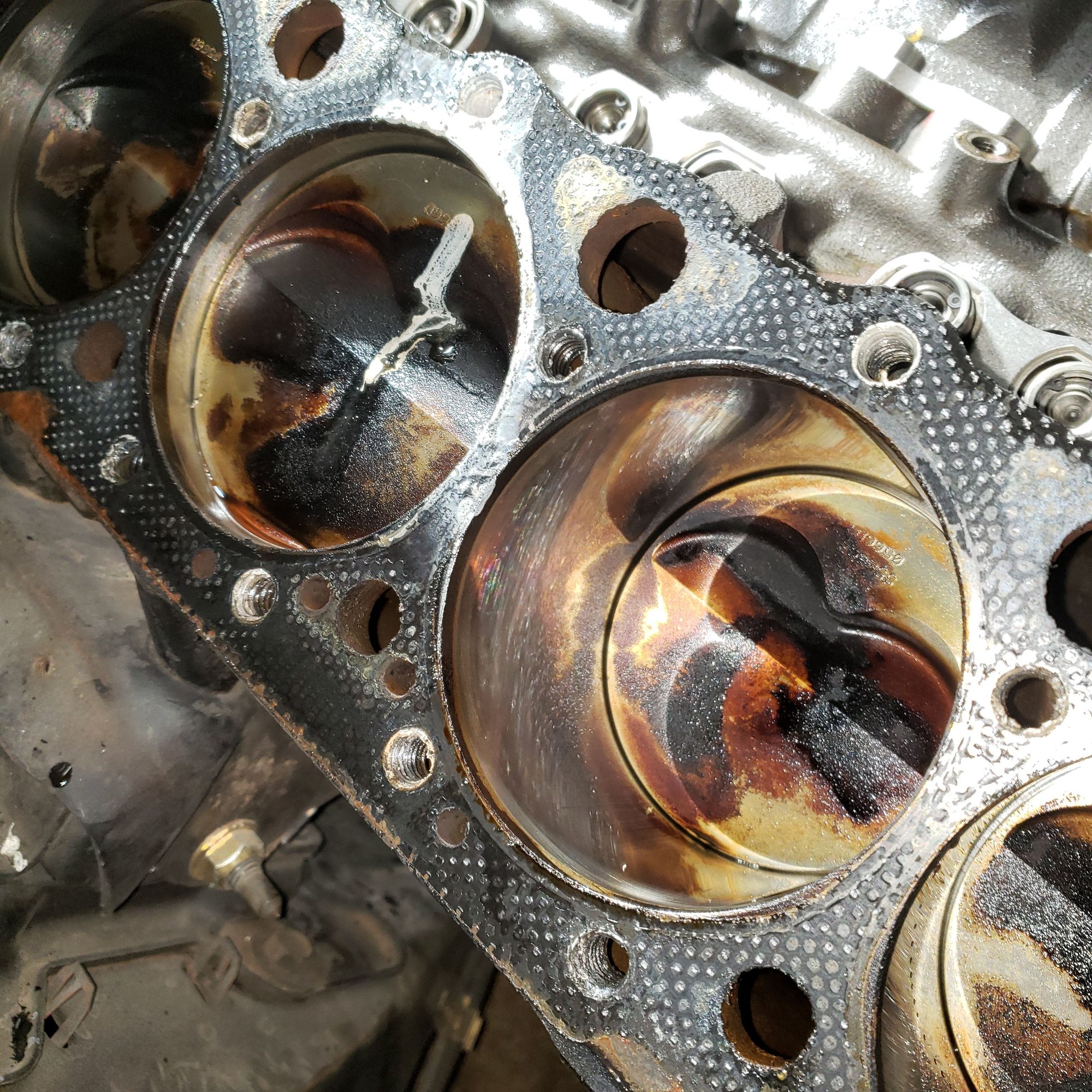

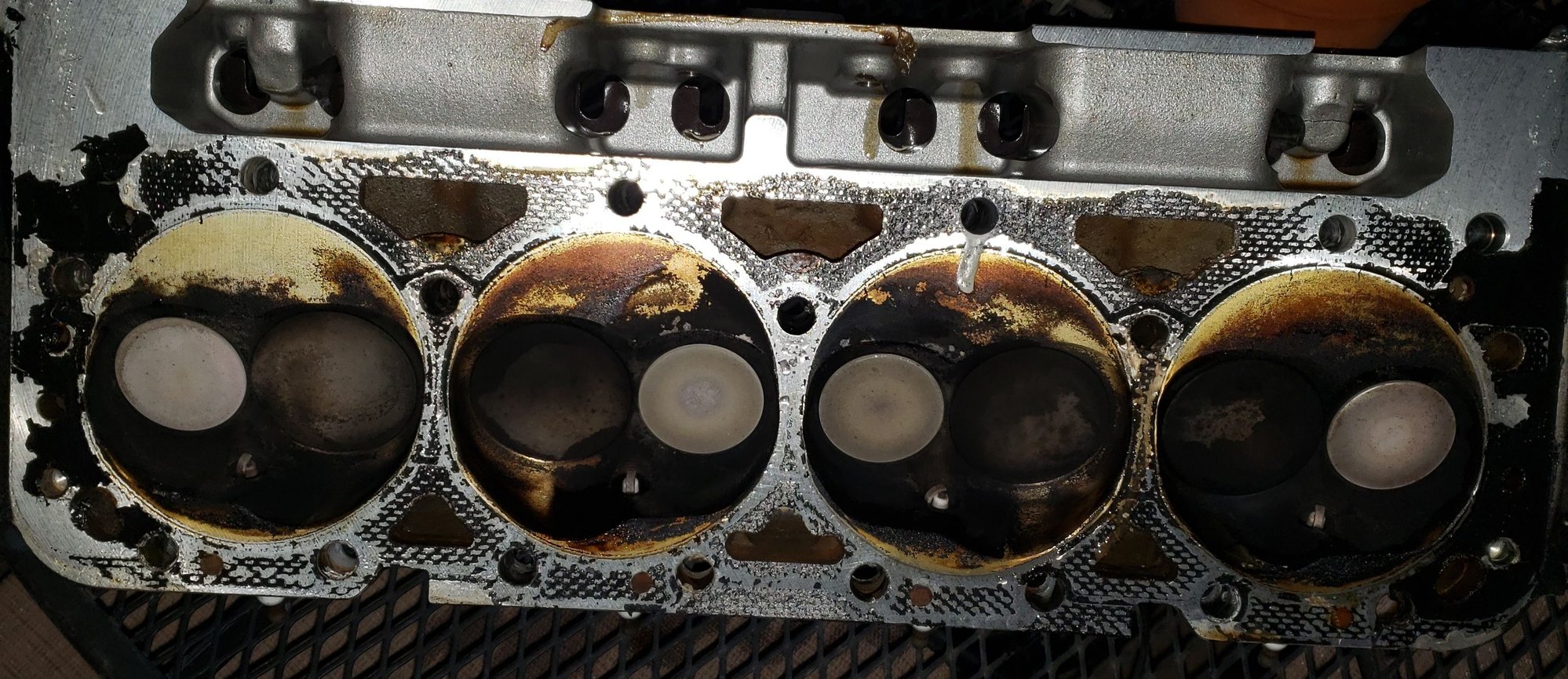

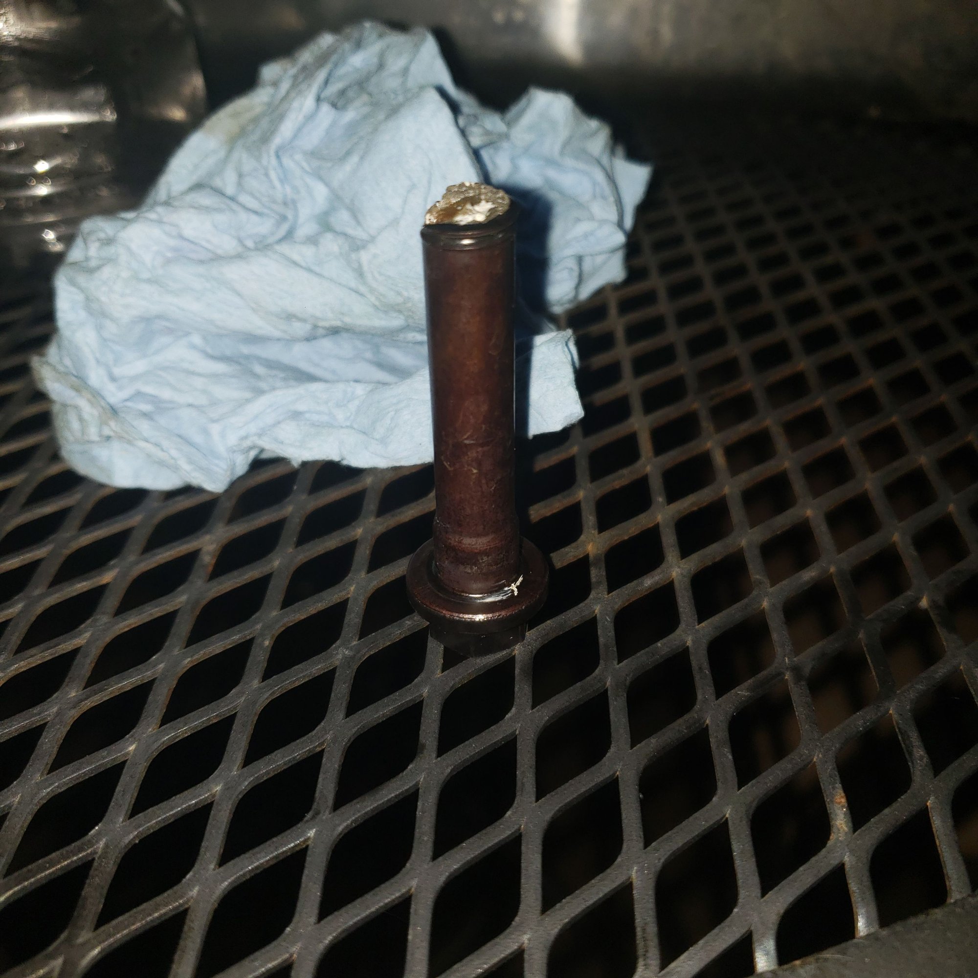

I am still not 100% sure what caused my head bolt failure. It was suggested to me that it could have potentially been detonation. That being said, I have found ZERO evidence to support this.
That being said my 383 is very well tuned with SFI. I did find the quench/chamber caused a weird burn/soot pattern on the pistons. The 383 is getting opened up from 0.041" to 0.053" quench from the Felpro 1003 head gaskets going on to it. I will know more on how that turns out when I get it running. I am also replacing the Rhoads lifters with stock GM lifters. They literally work too well and had my DCR at about 9.5:1 at low rpm and the knock sensor would occasionally pickup enough to pull 1-2° of timing. The frequency was few and far between though and was often caused on light throttle tip-in with a locked torque converter in overdrive under 1,500 rpm.
No signs of engine destroying detonation. #3 has some thread sealer I was disolving with brake clean that spilled out on to it, which is the weird white spot. I cannot say I have ever seen pistons that had spots with NO carbon buildup on them. I stuck a bore scope in this when it had 500 miles on it and it looked much the same.
Head bolt failure? When did THAT happen?
Now this could be interesting. Plenty of talk on the effectiveness of a tight quench and what tight actually means.
.040" has always been my target but where that figure comes from I can't actually say. Maybe Vizard?
Now I've a build decision to make as to whether to use my my go to head gasket at .026" x 4.100" (Clevite/Reinz 5746) and a .008" PtH clearance for .034" or back off a little and use the .039" x 4.080" gaskets I also have on hand. That'll open up the quench to .047". Either way, one is tight beyond familiar territory for me although several have suggested it's be fine in my case, or open it up to a less than best gap. But best compared to what?
Compression would move from a fairly iron headed high of 10.4 to a more user friendly 10.12:1. Subject to change should I get into dressing up the combustion chambers (which need some work).
Your results may demonstrate the value here.

Old Dec 18, 2022 | 10:18 AM
  #118
skinny z's Avatar
Joined: Dec 2005
Posts: 9,931
Likes: 892
From: 53.0907° N, 113.4695° W
Re: Trying to figure out a direction to go with cams.
73353 is same lobes i ran in my first turbo 400” afr 195 deal. Very mild and driveable. Done by 6000 with the small heads. Good mild driver cam
imo. On a 383 it may be alittle more noticeable but probably not a huge difference given same stroke. Id run that cam
Both the 73353 and COMPs XR288 lobe come in as "mild" on the simulation aggression index. The 288 was a long liver too as it survived between two engines seeing 7k. Peak was about 6500. It wasn't until I pressed well used parts back into the build that things went wrong.
your pistons kinda look like my bbc pistons burn pattern. They say a good burning chamber has carbon staining across 90% of the surface area. Might be fuel dropping out of suspension, idk. Theres a decent thread discussing some of it
https://www.speed-talk.com/forum/vie...hp?f=1&t=66074
I seem to recall Vizard stating the quench should be tight enough that "the chamber will knock down the carbon on the piston crown." But I too could be remembering wrong... .034 is tighter than I would go on mine... I'm shooting for about .038 with piston where it ends up and gasket compressed thickness.
Though I may add... what is the rule of thumb with gasket bore size... having a 4.030 block it seems you could run a 4.030 gasket but it seems most opt closer to 4.1... is that because it's just widely available or what.... I was planning on making sure it was big enough to not shroud any of the chamber uncompressed as that seems to be a good idea...

Want thegasket bore to be bigger than the chamber in the head. Often chambers are larger than the bore, so you dont want gasket exposed
A few weeks ago on the head bolt failure. Then I was sick with Covid. Just now feeling well enough to put it back together. I found the failed head bolts while I was starting an intake swap. 2 bolts completely broken, 1 stretched to the point it was finger tight and a 4th bolt had a broken washer under the head of it. That was on the driverside. Still have the passenger side to pull apart.
ThIs engine has pulled my van and travel trailer from Fort Worth, TX to both Padre island as well as to Durango, CO via New Mexico so far. Never missed a beat in those miles moving ~12,000 + lbs. Towing in 3rd gear at ~2,850 rpm @ 70 mph on flat lands it manages 12-13 mpg. In the mountains it sat at ~10 mpg. Some of those climbs were fairly long, hard pulls.
FWIW I was also told by some self proclaimed experts that the tightly gapped upper rings would butt while towing and they would score the cylinder walls and rip the pistons apart. I will be pulling the passenger side apart today or tomorrow, but the driverside had no signs of rings butting. No scoring of the cylinder walls indicating butted rings. There were people saying I needed 0.028"+ of ring gap for an 11:1 small block. Which is nearly double what this engine was built with.
That is the reason I changed mine. I noticed the GM 0.028" were just ever so slightly overhanging into the chamber. I either missed it during initial assembly (unlikely) or the gasket deformed when it was crushed pushing the fire ring into the chamber (more likely). The 1003s 4.166 bore is what Lloyd Elliot scribed the cylinder head casting with when he performed the chamber work.
What brand is that bolt? What is the torque spec?
One thing I intend to do is reuse my ARP head bolts. They've seen two go rounds of head swaps ( maybe three) but it may time for replacements.
JEGS @ 70 ft/lbs. Having had both the JEGS and ARPs in hand, the JEGS were possibly some grade of ARP. They clearly stated Made in the USA.
The bolt failure may even be my fault given I did not know to 60 grit sand the bottom of the washer where it contacts the heads. Then again if it was a known problem the JEGS instructions should have stated to watch for this.

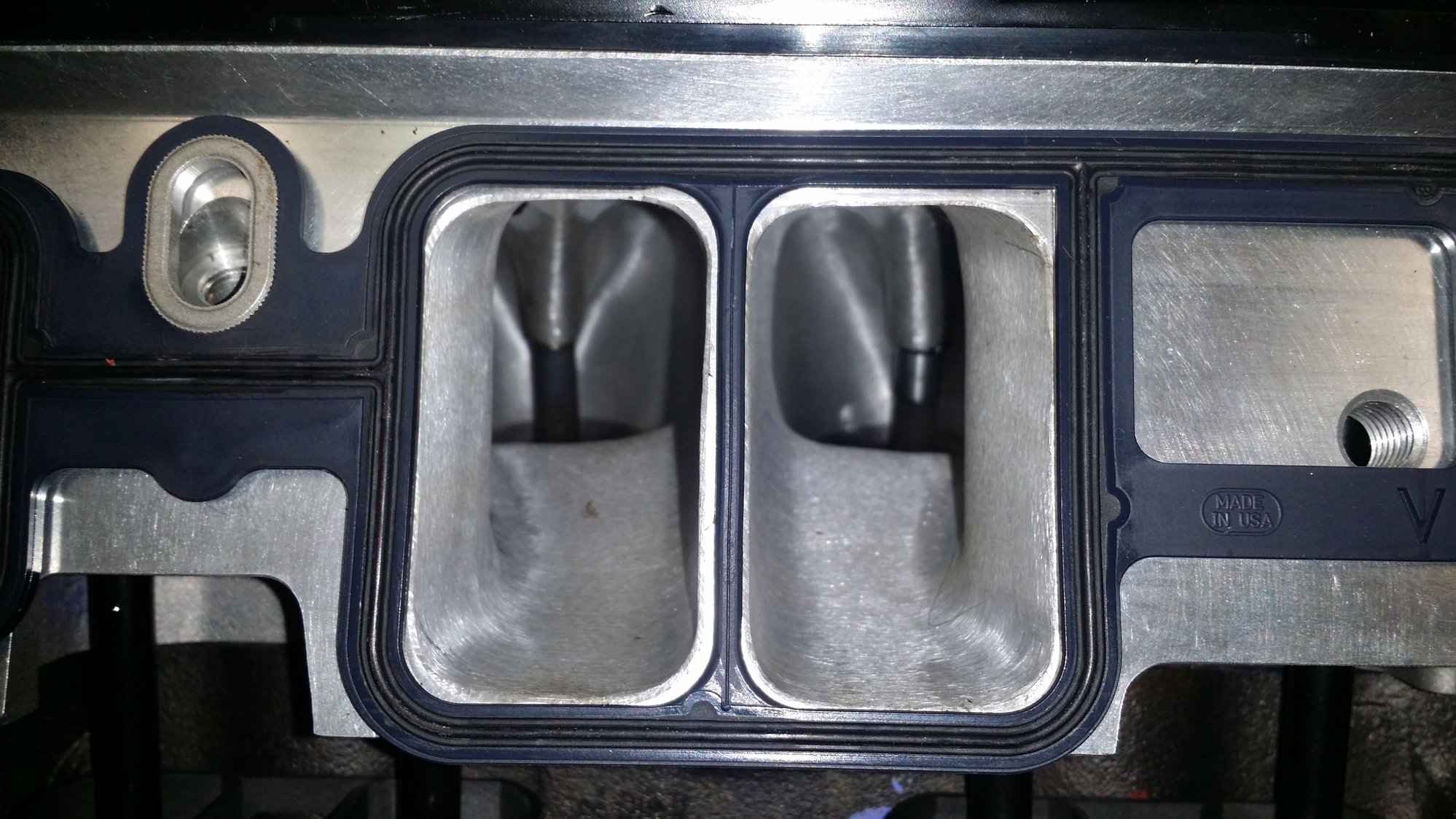

I am using paper gaskets 0.120" thick. The paper gaskets probably crush beyond what an OE or updated OE style gasket would.
FelPro 1255?
1255's fitted to an RPM Air Gap unported or gasket matched. .120" thick. (Could measure the crushed thickness for verification)
FelPro 1255?
Edelbrock 7215
They closely match Lloyds intake port work and I matched both the OEM truck intake and now the marine intake ports to that gasket. It was not a perfect match, but these pictures were of the worst one. The OEM truck intake was terrible and the ports were twisted and offset the start with. I threw an OEM style gasket against it for comparison after getting a close match to the 7215s. I will also add I had 3 OE lower intakes on hand and had already started clean up before I stopped to get those pictures. The other 2 OE intake bases were even worse than this one. To get power out of a vortec truck intake the manifold needs some heavy rework even using 1255s with a stock port head. The marine manifold is much better in this respect and it is easy to see why bolting a factory marine intake on adds the power it does. Not only is the injection setup moved out of the plenum, but the manifold base has larger, much cleaner and more consistent ports.

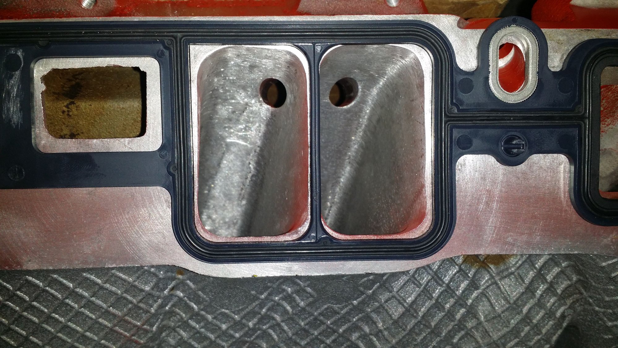

OEM gasket vs Lloyds head work just for reference. The heads and ported truck intake far outflow the as delivered OEM Vortec stuff.
Old Dec 18, 2022 | 11:45 AM

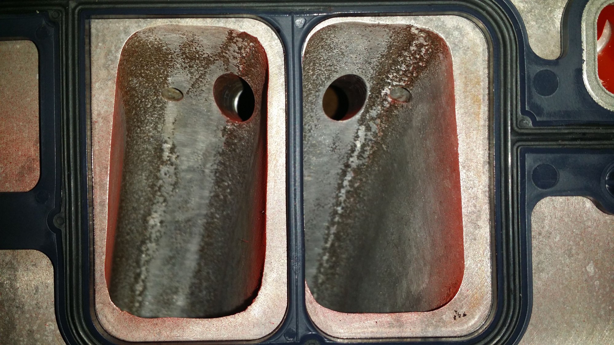

Here's the same gasket compared to an untouched RHS Vortec port.
Old Dec 18, 2022 | 11:57 AM
Now picture those heads under a stock truck intake. Definitely would not run to the added potential of those heads.
Old Dec 18, 2022 | 12:01 PM
There's certainly more in your ported Elliot heads than there is in these.
But the question is, at the risk of running this thread completely off topic, would cutting up the head and intake at the gasket surface mess up what's purportedly a decent port to begin with?
Now this is just my opinion. Gasket matching will not hurt the port flow or efficiency. Bowl work and valve work is a large perentage of the airflow gain in porting. That being said if the port is not efficient to start with it would be a mute point doing either. That is to say bowl, throat, pushrod pinch, CSA and short side radius need to be well designed for the port to work well.
I think it would not be hard to make ~550+ with these Lloyd ported heads. They flow just shy of 300 cfm @ 0.600 and increase all the way to 0.700 the highest lift tested. They flow over 240 cfm @ 0.400 too. The best of the factory OEM cathederal port LS heads (243/799) only flow 220-230 cfm @ 0.400 and 240-250 cfm @ 0.600-0.700. Those heads can make 470+ in stock form.

I've read too that gasket matching does little if there's not an alignment issue to begin with. A little more investigating on my part with the heads and intake in place will tell the tale.
As for these heads, they're upgraded version of OEM Vortecs so not a bad port to start with. These have a 2.02/1.60 valve set and 170cc (out of the box). RHS sells them as 270CFM@.500" but that's on an unrealistic 4.200" bore fixture. They eventually ended up with a better valve job, some bowl and SSR work too. At about 175cc (yet to measure after porting) they flow about 255 @ .500" on a 4.030" bore so CFM looks good relative to port size (230@.400"). They look to be very efficient.
That said, the small size and lack of additional porting, most notably the pinch I would think, leads them to fall off past peak flow. Not much but it's not the best case where flow should remain at least undiminished as the valve is opened further.
Still, I'd say good for a solid 450 HP in dyno trim. Sims show more but I'm not getting ahead of myself. Looking for a 6000 RPM HP peak.

Well, I've just spent some money. I went along with cam #2 from jones. Excited to eventually get the next mill together!
Old Feb 10, 2023 | 04:54 PM
  #145
skinny z's Avatar
Joined: Dec 2005
Posts: 9,931
Likes: 892
Nice.
Do you have lifters?
And are you going with one of those PAC springs?
FWIW, I asked Mike to spec out something for my 357.
Smallish heads. Peak HP RPM at 6k. Carry to 6500.
4000 stall. Drag racing primarily and the street will be what it is.
His reply:
Here's what I would recommend.
Cam#: SBC, HR72360-73360-108
232/236@.050"
.360"/.360" Lobe Lift
.576"/.576" Valve Lift, w/1.6 rockers
108 LSA
Interestingly, this is exactly the same spec for my earlier proposed 383 with the same at HP peak.
I find that just a little bit odd.
It'll have to be sorted out in our next conversation.

yes, i've been sitting on a set of morel 7717s. And yes, I'm doing the whole package from mike. I like the idea of the beehives.
As for your cam... same heads as the proposed 383? I could see that influencing things no?
Yep. Same heads.
Originally Mike had spec'd a less aggressive pair of profiles (.340" lobes) and spread the LSA to 110. This was in his street performance category recommendation form.
Then I requested he take the "street" out of the equation and he came up with the result above.
When I asked for a recommendation for the 357 ( the only thing changed was the CID) I went straight to the drag racing form on his website.
Two CID's. Same spec.

Did you specify a specific or the same stall speed converter for both engine sizes?
Old Feb 12, 2023 | 10:17 AM
  #150
skinny z's Avatar
Joined: Dec 2005
Posts: 9,931
Likes: 892
The 383 was spec'd with 3500 stall. The 357 at 4000.
Both builds looking for peak power at 6000.
Looking back through my notes, the 383 came in a 10:1. The 357 at 10.4.
Sims do show the 383 peaks at 6000 but falls off quickly past that. The 357 is flat from 6000 to 6500.
It'll be part of the discussion going forward. One thing to take into consideration is those heads on that CID are considered a little on the small side. From what Mike has explained about his methodology is that this greatly affects the cam result. It might also explain why the 383 drops off abruptly.
It may just be that the slight difference in compression and stall speed come together enough to have two CID's but similar cam specs..
