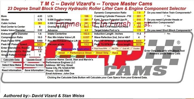

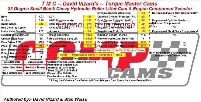

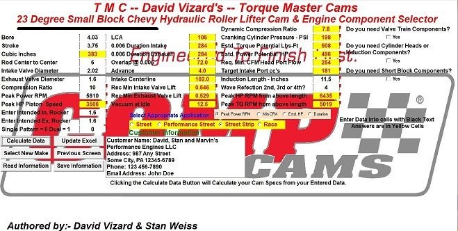

I'm in the cam development phase of a 357 project myself. All very preliminary although it's be a hydraulic roller for sure. I've had success in the RPM department with COMPs 26918 BeeHive spring along with the associated lightweight tool steel retainer so it'll be that again. PAC also has their 1219 conical spring that specs the same as the COMP. The smallish spring and light parts keeps things under control as the revs build.
Now, as an example of one spec I have is said to make peak HP at 6400 is 290/290 on a 108 LSA. (6400 peak with another 200-300 for overspeed). Now the question is, which lobe do I go with? If I check the profiles offerings from Jones Cams, I've a choice between 290° on the seat and 240° @ .050" or 290° on the seat and 230° @ .050" lift. One is a .360" lobe and the other a .330". There'll be a line somewhere that says one will outlast the other in terms of durability but will offer less area under the power curve for less engine output. So that's one thing to take into consideration.

Here are three cams Torque Master created for a 10:1 383.
Keep in mind that TM is all about maximizing torque for given cylinder head and compression ratio. It's also WOT results as would be seen on a dyno or the drag strip.
I was mostly interested in the minimum required intake port CFM for that 10:1 CR. All single pattern although I have dual pattern files as well. These results imply a free flowing exhaust as in open headers or a near zero loss muffled arrangement.
Cranking compression was at or near 200 PSI in all cases. And a tight 106 LSA as you'd expect from something Vizard engineered.
500+ lbs-ft of torque all around.
With better heads it would easily top 500 HP but as it is, you can see the peak HP RPM is 5600 or less so the output isn't necessarily there.
You can take those seat durations and target the .050" numbers.
The 279 cam in the first example could easily be had with 224-228.
But I'm not sure this is a van cam given your stated goals. But you could pull a house with it!
I'm just throwing this out there to stir up the conversation.
