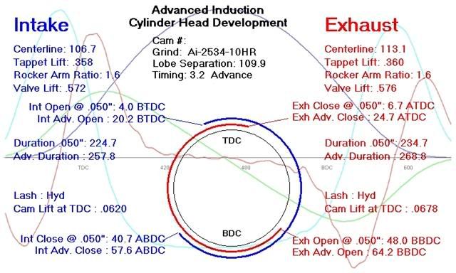

given the exhaust flow numbers
i suggest a 278/290, 226/234. .363/.353 lobe. .572/.555 with 1.6 rocker. 109 lsa 107 icl
advanced induction had a cam like this for their lt1 builds.
i think of this like those lt1’s. Guys add big duration to stock heads and make few extra ponies up top, but hold onto those ponies longer, and suffer abit of bottom end and drivability. The medium duration cams do not hurt bottom as much and dont give up Much to the bigger cams up top. Win win
xfi lobes in the 226/232 or 226/234 or even 226/236 wouldnt be to far off. Given a 5800 peak, hold few hundred rpm for shift
6000 rpm peak, add 5-6 degs to both. Jones cam makes sense here at 232/240 or so

This is Ai's 225/235 on a 110 lsa cam card as an example. I ran it on a 350. They advertise their lobes as being very valvetrain friendly. Their 230/238 on maybe a 108, would fit your needs perfectly, imo.
I'll try and work out the advertised specs for that. AI says valvetrain friendly so that'll be a good reference when compared to some of the other profiles. As an example, I'm not sure the XFI lobes can be described as such. That cam was the noisiest of the lot I've pushed through the old 350.

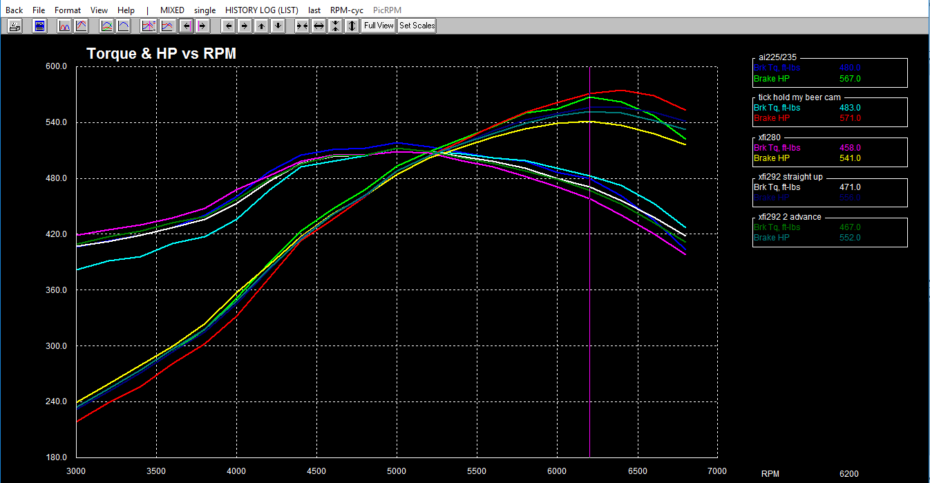

I've been playing around with the engine analyzer for the past few days on my own combo, using cams I've been interested in, ran in the past, currently running, and what I thought may be ideal. What I have found is that there is no clear cut winner that would make it worth the time and money to do a cam swap if you already have something decent. My setup is a 10.92:1 383, street port AFR 195 eliminators, miniram intake and xfi292 cam, installed 2 degrees advanced. Being primarily a street car, I chose to advance the cam slightly, willing to trade off just a bit up top, for a bit more low end. It's a manual trans car, which is why I chose the 292 over the 280 that I had in mind. The results of both 292 cams and the 280 cam show exactly what I anticipated, and I'm happy with my choice. The new player is the Tick LT1 'hold my beer' cam 241/245 LSA111+4 (.609"/.615" ) that I've been eyeballing. Its results are also as expected, but the bottom end loss is more then I would want for a street car. The big surprise was when I plugged in the AI cam I had in my 350, giving the most torque, and nearly as much hp as the big tick. Note that all the cams had a VERY similar midrange. Pick one and run, they would probably all ET very similar. Tha AI would have an edge, but cylinder pressure and my compression ratio, plus pump gas, wouldn't make it the ideal cam for me personally.
Maybe bigger is not better in regards to heads that may be a little on the small side, and if so, a cam in that same 220-230 range on a 108-110 may be ideal for the OP. His dual plane will increase torque over the mini ram, and drop peak hp rpm by a good bit, giving him what he needs. I don't get too much into the LSA argument, I know that the tighter LSA's seem to drop off very quickly after peak hp, and I played around quite a bit with the numbers, with a pretty consistent tradeoff between tq and hp, as would be expected. I'll also note that the peak numbers given seem maybe 15-20hp higher then I anticipated for my build, so I'm taking that with a grain of salt, but the comparison of different cams remains the same. I spent a good amount of time trying to make sure my cylinder head data was correct.
This one I need time to digest. I haven't the ability at the moment to analyze the graph and the conclusions.
But I will.
Plug the bootlegger cam into it. I think the torque under peak in the curve would suprise you as would peak HP. It pulls like a freight train from the moment it flash stalls the converter ~3,000 rpm all the way to the 6,200 fuel kill. I am running it with a 1.7 rocker for 0.628" lift.
284/309 @ 0.006
232/244 @ 0.050.
.554/.554 lift.
108 LSA and 106 ICL.
Supposed to be a 104 ICL but mine dropped in on a 106 ICL.
With the 1.7 rocker the 0.050" specs would be like having a 236/248 @ 0.050 cam with a 1.5 rocker.
I personally feel it would wipe the floor with the Tick cam. To represent the Bootlegger with a 1.7 rocker ratio as I have it installed in my 383.
284/309 @ 0.006​​​
236/248 @ 0.050
0.628/0.628 lift
108 LSA and 106 ICL
284/309 @ 0.006
232/244 @ 0.050.
.554/.554 lift.
284/309 @ 0.006​​​
236/248 @ 0.050
0.628/0.628 lift
108 LSA and 106 ICL
I'll run that through later tonight, in a few different iterations of lift and ICL. I plugged 1.7 rockers in on a couple of my tests, and in each one, I lost power compared to 1.6's. Maybe someone smarter then myself could answer why (smallish heads, port velocity, etc.). The only cam that made more power with over .600 lift was the tick. I also never ran a cam with that much exhaust duration, the xfi292 with 292/300 was the largest duration cam I tested. In any case, I'm curious about the results. Another thing that is important to my personal needs is a good, smooth torque curve, with hp carrying as far past the peak as possible since I autocross the car and just leave it in one gear. Rpm can range from 2500 to my 6700 rpm limiter, and a peaky torque curve can upset the balance of the car if it comes in suddenly. I don't want to get too far off the OP's topic, but at the same time, I find it interesting what does and does not work.
