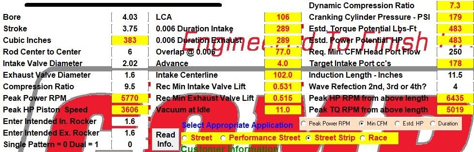

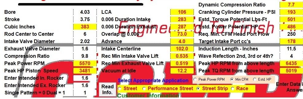

Lack of physical progress notwithstanding, I've still been working through the cam spec.
I've kind of zeroed in on using Vizard's Torque Master program to dial it in. While everybody has an opinion and results to back them up (or so it seems), Vizard's approach has always peaked my interest and I figure I'll give it a go.
I've run the spec using a couple of different criteria.
Port CFM. While heads have been flowed at ~255 CFM @ .550" lift, I've dialed that back to 250. I can't say exactly how that will play out once there's an intake and carb in place.
Compression ratio, ranging from 9.5:1 to 10.5:1. From that I can see what kind of port CFM I would need and the resulting maximum HP RPM.
Max HP RPM. I put a limit of 5500 just to see where that goes.
I've also built profiles for single and dual patterns although I'm trending towards a single pattern cam. My plan is to run open headers for racing and maximizing the overlap and scavenging and whatever happens once a full exhaust is on for the street will be what it is.
The following three shots are based on a 250 CFM port with varying compression ratios. All single pattern.
Any of the fields in white are my data entry points. Anything in yellow is calculated.
The induction length is a different calculation altogether.
9.5:1 with a 250 CFM port.
9.8:1 with a 250 CFM port.
10.5:1 with a 250 CFM port.
Old Jun 26, 2021 | 03:34 PM
  #120
NoEmissions84TA's Avatar
Joined: Feb 2017
Posts: 4,186
Likes: 576
From: Meriden, CT 06451
Re: Cam Specs for a 383
Interesting. You bump up the compression a little bit and the program spits out a smaller cam.
All three have Target Intake Port cc's at 178, which should be almost be spot on with your heads.
It looks like Induction isn't even part of the camshaft calculation. But it does show that it is not a restriction.
Am I reading that correctly?

I spoken with Vizard about the lower compression and increased duration deal. His comment was that if you can't squeeze it enough, you better be sure the cylinder is full. More duration. More overlap.
Okay, now this is making sense. But lower compression and increased duration (lower DCR) makes a lazy engine with a soggy bottom end.
So then, going in the opposite direction, more compression with a smaller cam (higher DCR) and you can run into detonation problems and having to use high octane fuel.
Did you ever see this article? http://purplesagetradingpost.com/sum...%20engine.html
I am just going to put up some links to NOT take your thread off track:
https://www.thirdgen.org/forums/tech...ould-have.html
https://www.thirdgen.org/forums/tech...ked-350cc.html
Look at the peak HP RPM for the low compression spec. It looks to me that it's a forgone conclusion that the bottom end is compromised. Peak HP RPM is 500 revs higher.
So, build accordingly with the rest of your spec I guess. More gear. More converter. Or whatever to suit that rev range.
For me, I can target an ideal CR. There's more predicted HP and TQ (like 50 ft lbs) with less RPM (500) using the optimized spec compression ratio. That's with a given intake port and intake valve. For me, my latest upgrades weren't ideal for the 355 and 288/294/110 cam. Not enough gear or converter. The 383 will dial that in. Or that's my hope. I crossed the stripe at less than 5500 with that 355 spec. About 1000 less than ideal. A 383 and the same supporting parts will bring me closer to finishing at peak HP if the TM program predicted HP peak is accurate.

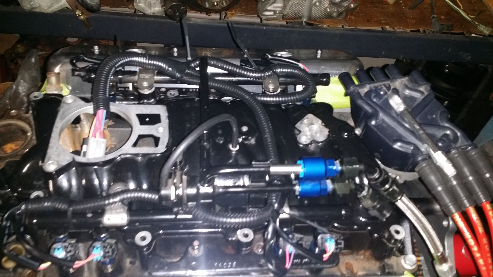

It has been a minute since I have posted in this thread. Due to emissions reasons here in Texas i went back to a stock looking intake manifold on my 383 to help hide it. I went back to the smaller Comp Magnum high lift based cam. 383 still runs strong and idles very smoothly with good vacuum. The Rhoads lifters are not all that loud although the microphone on my phone loves to amplify the sound of the valvetrain.
This was running with a Quadrajet that had not been touched in 10+ years and old parts store plug wires, cap and rotor on an untouched distributor from about a 1979 G20 van.
This was the first start of the 383 with an 850cfm Q-Jet I had just built, with the high idle cam set it fired up as soon as the dry fuel bowl got fuel into it. Ended up opening the idle mixture screws from about 4 turns to 5.5 and it idled noticeably smoother. I had done a complete ignition tune up and modified the advance curve as well. Plugs gapped at 0.060" on this test.
This is one of several fuel consumption tests I ran. Freshly built and jetted up Edelbrock 1406. Quadrajet with the APT adjusted correctly blew the Edelbrock out of the water. Also discovered that the knock off Rumble 40 series flowmaster clones actually cost 1 in/hg vacuum at 2,000 rpm while increasing the engine run time 30 seconds on the same quart of fuel.

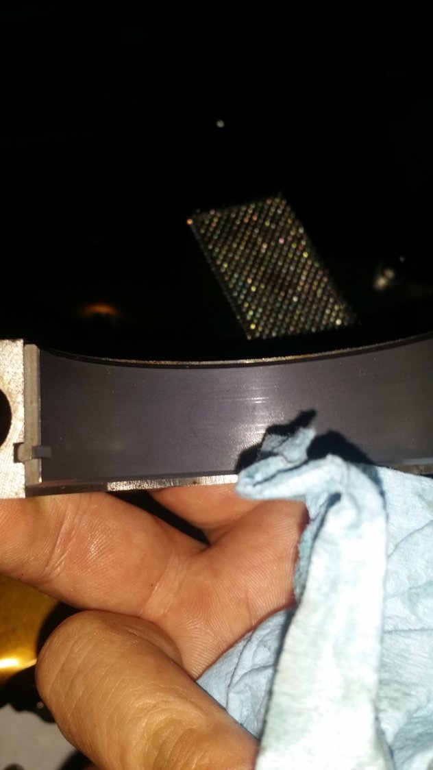

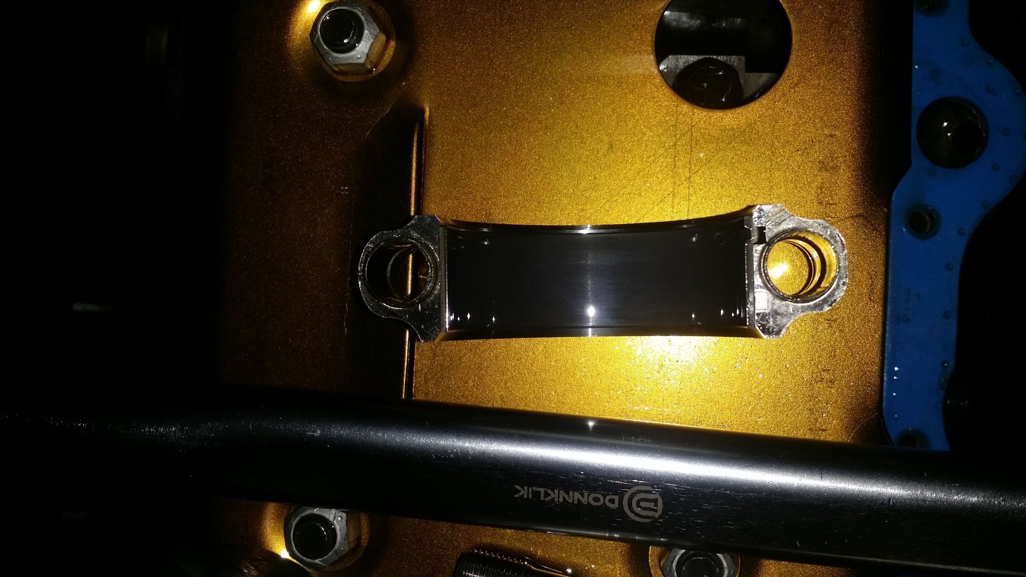

While I had the timing cover and thus oil pan off recently, I decided to take a look at the general condition of some of the engine since it has some run time on it now. I have redone the wiring harness in the van, plumbed the trans and power steering lines with AN. Added a massive power steering cooler. Detailed it inside and out. In the process of swapping out the head unit for an Android 9.0 based 10.1" touch screen with all the modern touches including OBD2 link gauges. Repaired the front door panels and swapped in Rockford Fostgate speakers all the way around. I have swapped the steering gear box and rebuilt the a/c system with a new modern parallel flow condenser and a Sanden SD7H15 meant for the van. I swapped on new larger 2015ish Express van dual glass power mirrors. I swapped it to a 2005 PCM as well running a Mexican L31 GMT800 based tune. I have swapped all the exterior lighting to LEDs and rewired the headlights with an added relay off the fuse box to give me all 4 headlights when you select the high beams. I also added an automatic day night mirror with compass and homelink. It is almost road trip ready.

My eyes can't help but to notice things out of place.
Is the big end of this rod still on it's crank journal?
If so, then why is the pin end of this rod so far over to the right on this piston?
I think it was loose from the crank in that picture. They do have some side to side play even when it is fully buttoned up. Crank has a wide filet radius and required narrow rod bearings. Makes the full floating rods have a substantial amount of rod side clearence.

I just wanted to point it out in case you didn't see it.
It would be a shame to lose what looks to be such a nice engine.
