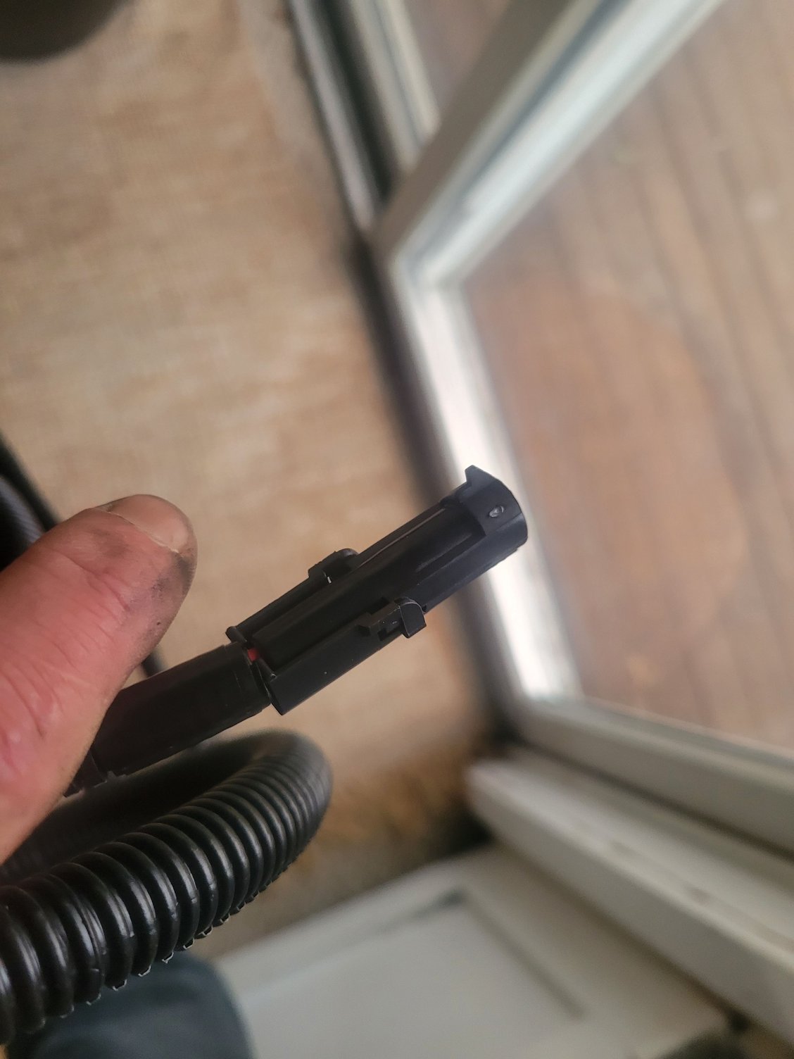

+ battery pigtail connection
What does this connect to off of the positive battery cable?

Old Jan 17, 2023 | 10:39 AM
gt4373's Avatar
Joined: Nov 2011
Posts: 2,994
Likes: 354
Transmission: 5-Speed Manual
Re: + battery pigtail connection
That Looks Like The ECM Power Plug
There are 2 and it's hard to tell the difference is there any way you could see if the inside of that plug matches up

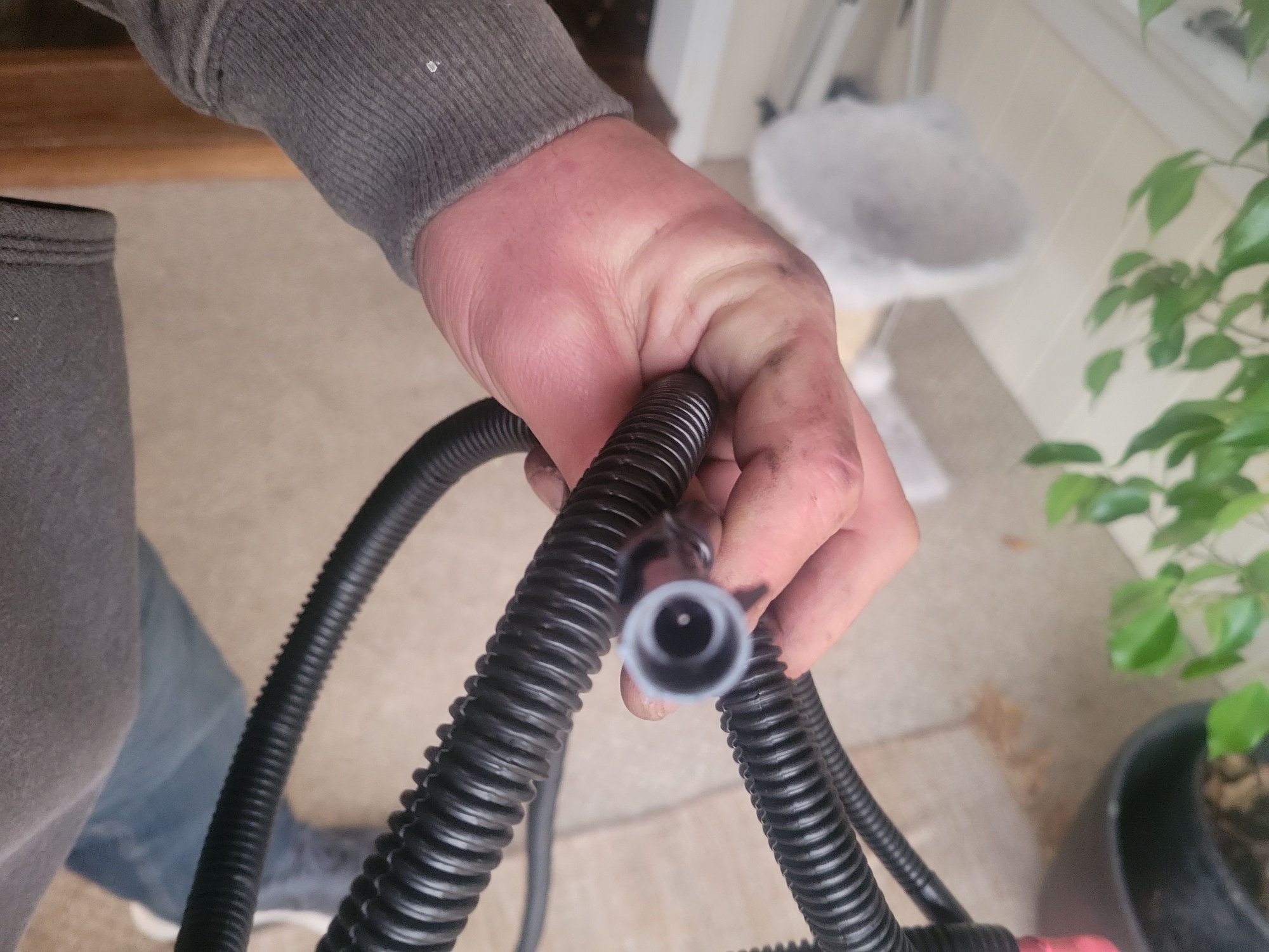

it's not that one, it's the other.
This is a new tpi positive battery cable from hawks. It has two connectors, one of them (female end ) I am assuming is Alternator plug as you described above. The other that I am trying to figure out , basically looks like the male version of that plug.
Everything that was connected prior to replacement is connected other than my msd which ran straight to battery .
I would like to know what it was for in stock application as I would like to buy the other end and connect my msd using this extra pigtail
The Mating Electrical Connector Pigtail is a Delphi Weather-Pack Series Connector:
-ACDelco: PT517
-GM: 12117385
Hyperlink to a reasonably priced Pigtail:
CLICK HERE
