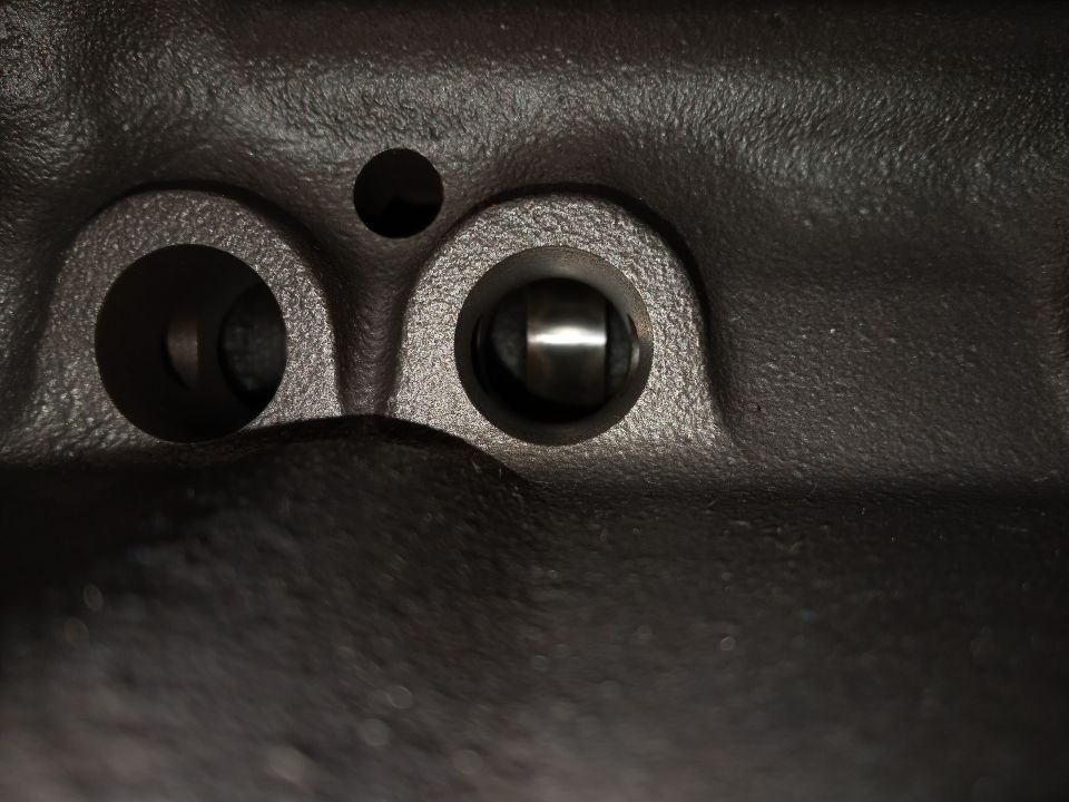

I have seen more issues with shoddy machining than anything else. Lifters without a radius and cams cores that have lobes dead center in the lifter bores.
This is exactly what T.L. and I are discussing. Somehow my agreement with his reply was lost.
Poor machining. Lifters with no crown. Cams with no taper.
Poor metallurgy. Cam cores of suspect origin.
It all adds up to a bad result.
No matter the oil used.

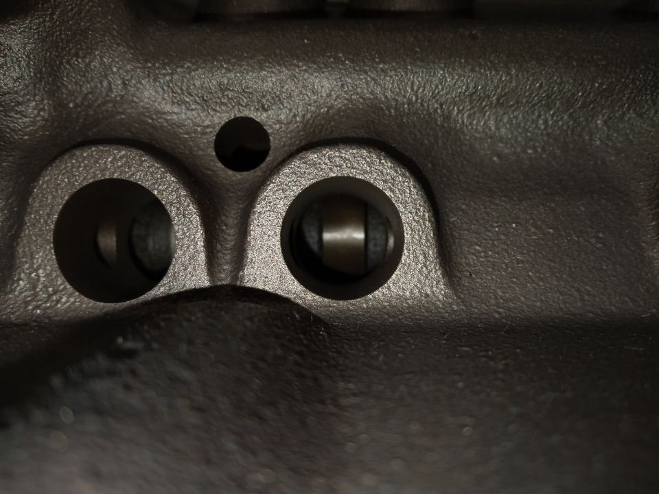

This was a Comp Cam. 3 or 4 lobes were like this. It was pulled out and returned. Nothing would have saved those lobes from destruction as it would never have spun the lifters.
This was the replacement from Howards.

I like the simplicity of a flat tappet.
Here is something for the other dinosaurs like myself, because I have actually done this.
If you want a good indicator for your FT cam & lifters to survive the break-in, do this:
Use a Sharpie or paint marker to put a mark on the top of the tappet.
NO LUBES on lobes (except oil the journals) - cam installed with timing set, drop the lifters in and rotate the crankshaft.
If the correct relationship between the lobe and tappet is there, the lifter will rotate!
YES, no valvetrain installed, just the weight of the lifter.
The rotation happens on the closing ramp.
If all sixteen do not pass this test, then there is a very good chance that your engine will soon be trash if you proceed.
The flat tappet lifter MUST rotate!!!
For any reason, the instant that a flat tappet stops rotating, you now have a lathe.
I put the cam in 1st, followed by the lifters if it is a flat tappet engine, spin the cam and watch them rotate. That is how the problem above was found.
