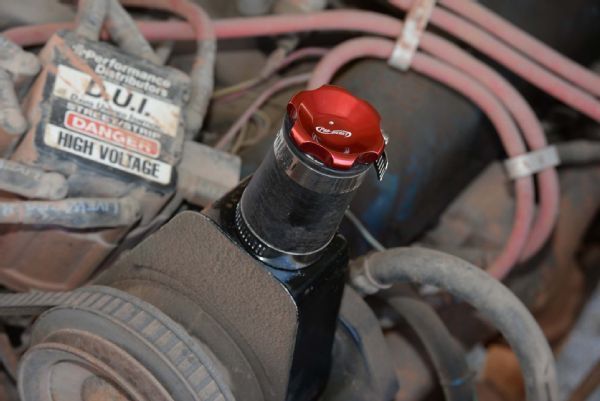

Re: Can we seal our power steering cap better?
An old racer's trick.
Old Apr 30, 2023 | 06:50 PM
LiquidBlue's Avatar
Joined: Jun 2015
Posts: 2,194
Likes: 246
From: Austin, TX
Car: 90 Formula / T-tops
Transmission: MD8
^^^^^ LOVE IT !
