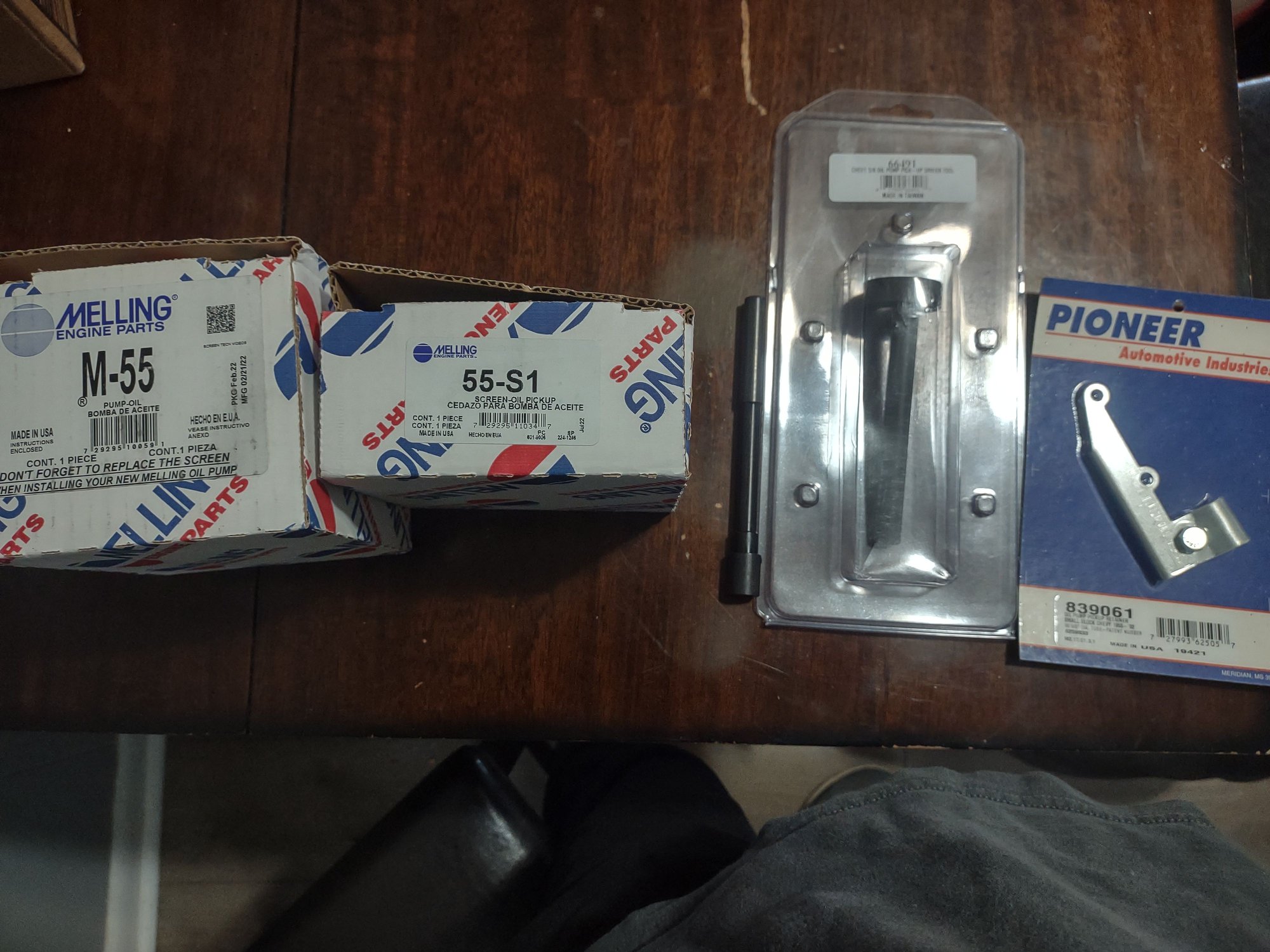

This is what I got and i was thinking the same thing it is not too expensive to go all new. Thank you for your info and I will go thin on the rtv for sure where you told me to be

This is what I'm going with
Thank you for your reply and tips I will post back and let you know how it goes!
