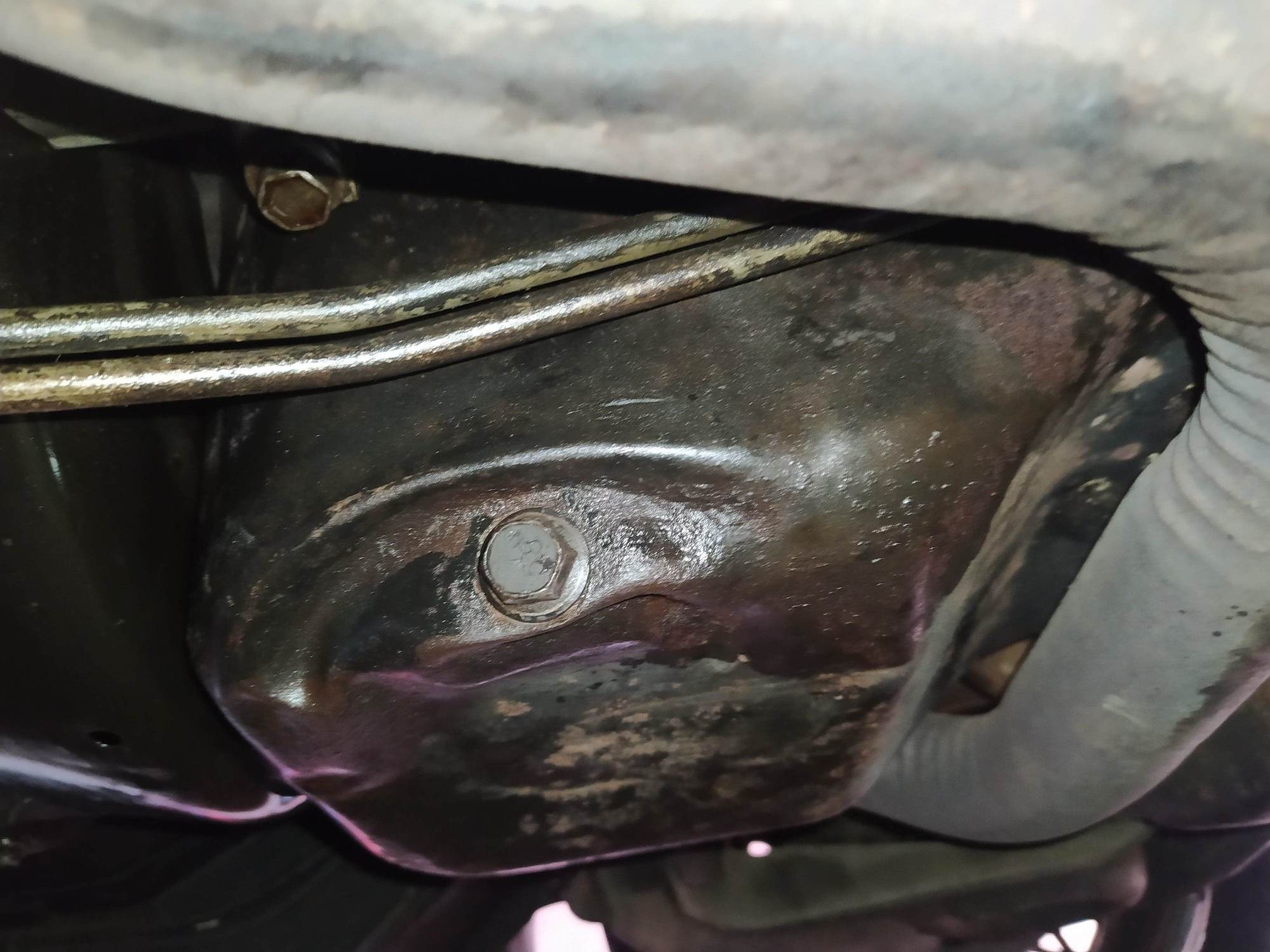

Hello. I have changed the filter and oil for 5w30. After warming up the engine, the pressure is still high but it no longer reaches maximum. It has improved. And I have seen that the crankcase cover, the oil pan, is very dented, damaged, so it is smaller. Can that make the pressure higher? because there is more oil in less volume. And what I thought was oil coming out of the exhaust pipe is carbon along with water. I suppose that due to the cold, water condenses in the exhaust, which is new. Sorry for the mistake.
