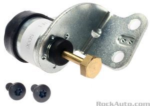

I just got a 1984 Z28 305 with about 105,000 miles, I assume the motor is all stock with what I think is a 4bl Quadrajet. The Idle Stop Solenoid is electrically connected, but just laying loose on the intake manifold. I can’t find any info on it in Haynes. Can anyone provide a pic or diagram or information how to properly mount it? I also want to know where these 2 torx head screws go and what size they are. Thanks!

It Mounts Here

I just replaced mine.

Just A Note The New Solenoid Terminal Is Not In The Factory Location And Wil Mount Very Close To The Throttle Position Sensor
