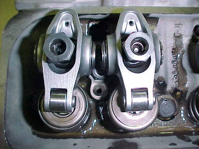

<b><font size=+2>Dont get COMP CAMS roller rockers</font></b>
I bought some a week ago and tried to put my original valve covers. They don't fit! So take my bad experience and make sure to buy "narrow" rockers or you'll be sorry!
Oh, here's a pic to let you see what doesn't fit.

what part number rocker are you using? Are those center bolt or taditional valve covers? Just wondering if theres any difference in the years of the heads....
Just to be little bit more specific, i was planning on getting pn. 1416-16 out of Summit. Does anyone have any idea what the gross lift would change to after this swap?
