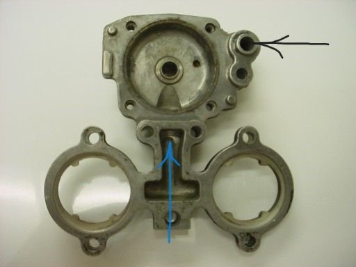

Went out to the garage and took a look at the tbi regulator. I see where you would tap the in and out ports, but where would you drill and tap for the return line?
Old Oct 4, 2024 | 02:53 PM
Tom 400 CFI's Avatar
Joined: Oct 2000
Posts: 3,243
Likes: 810
From: Park City, UT
Engine: LT1, L400
Transmission: ZF6, T5
Axle/Gears: 3.45, 3.31
Re: Holley Fuel Regulator Issues
Blue arrow is the IN/pressure side, black arrow is the out/return side....no pressure.
"T" into the pressure line at any point between the pump and the regulator, and you got your set pressure, for the carb.
