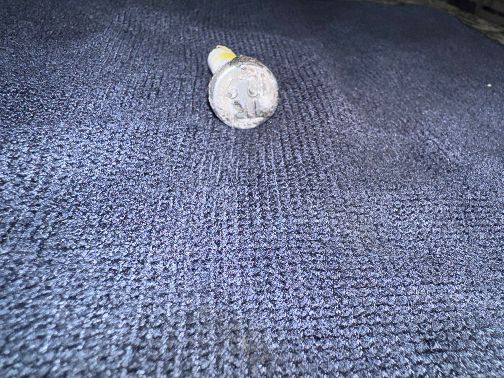

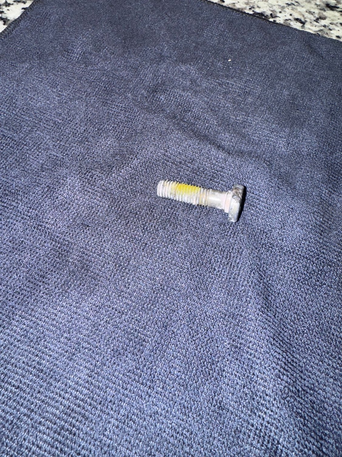

this is what came out of the top of the intermediate shaft. It was covered in road gunk since ‘84 so was interesting trying to get out until I realized what it was. Why the round head “bolt” design? Any known NEW alternative bolts I could use?
