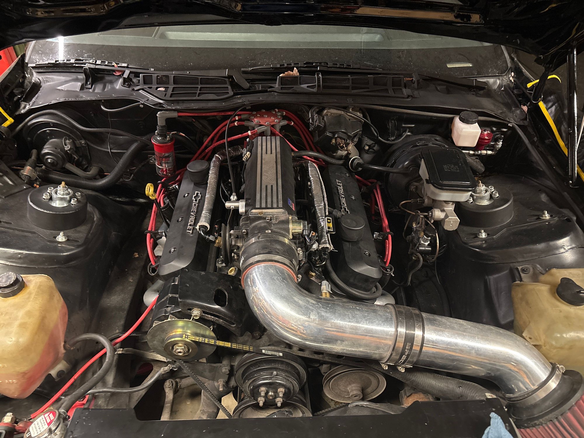

Fitting efi under the hood of a trans am is not easy. The units w a 4 barrel throttle body won't fit under the hood w a full size air filter. The pro Flo xt will fit. That's what I have on my 82. Unless people want to keep a car all original I don't see why more people don't make the conversion to EFI. That said, doing it on a high milage older engine may not make the most sense. I'd think about long term goals a the car. The efi swap is time consuming but not difficult. It's really just a time in/planning thing. Removing the stock engine harness and fuel system is simple enough. Then you simply run the new efi harness where the old one was and work on the efi/fuel sys after. The gauges all come from a c100 connector on the driver side. That will all continue to work.
Nice! I am about to pull the trigger on an EFI or a 5.3 swap. What kind of motor is that?

A zz430 clone
