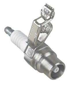

You should be able to position a spark plug, wire w/a "screwdriver" stuck in it and placed near ground, or tester like the one pictured above, in such a way that you can easily see it from in the car, under the rear/gap of the opened hood. spark w/HEI should jump 3/4 of an inch easy, which makes it real easy to see.
