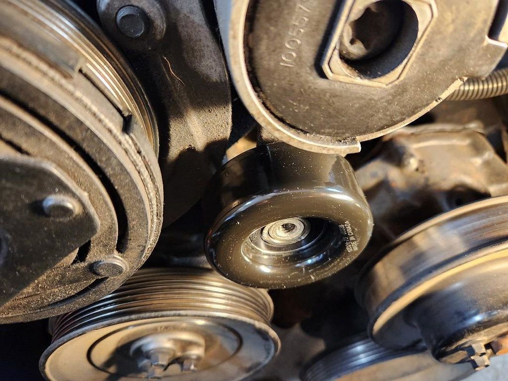

Just changed out my tensioner pulley, and cannot find a torque value in the FSM for this item. Does anyone happen to know what that value is?

Yeah, I'm keeping the original pulley. Next time I'll get a bearing for it.The bolt has a bit of a built in washer as part of the head, and seems a perfect match to the Gates (made in Canada) pulley and bearing, without the big factory cupped washer. Checked that the threaded hole went all the way through first, so I knew I was goign to crack the aluminum tensioner housing in the process.
All torqued an moving on to the next task.
