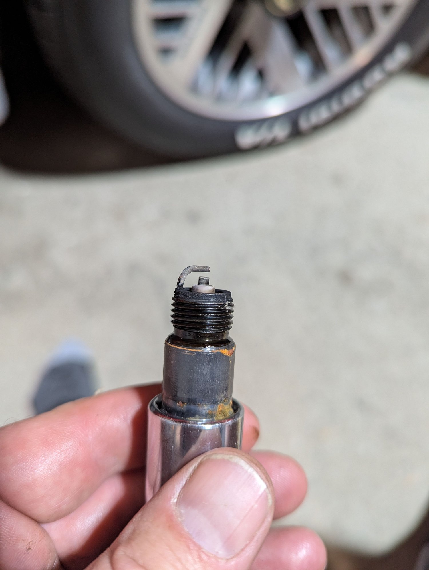

What does my plug tell you?
It's been in about a year. Perhaps 500km. She hesitates sometimes when I give her the beans.

If you look at the color on the electrode there, it looks like you should hook up a scan tool and check the data.

Heat range looks good and AFR looks spot on. I wouldn't change anything.

I 2nd it looks very good.

Looks good to me.
