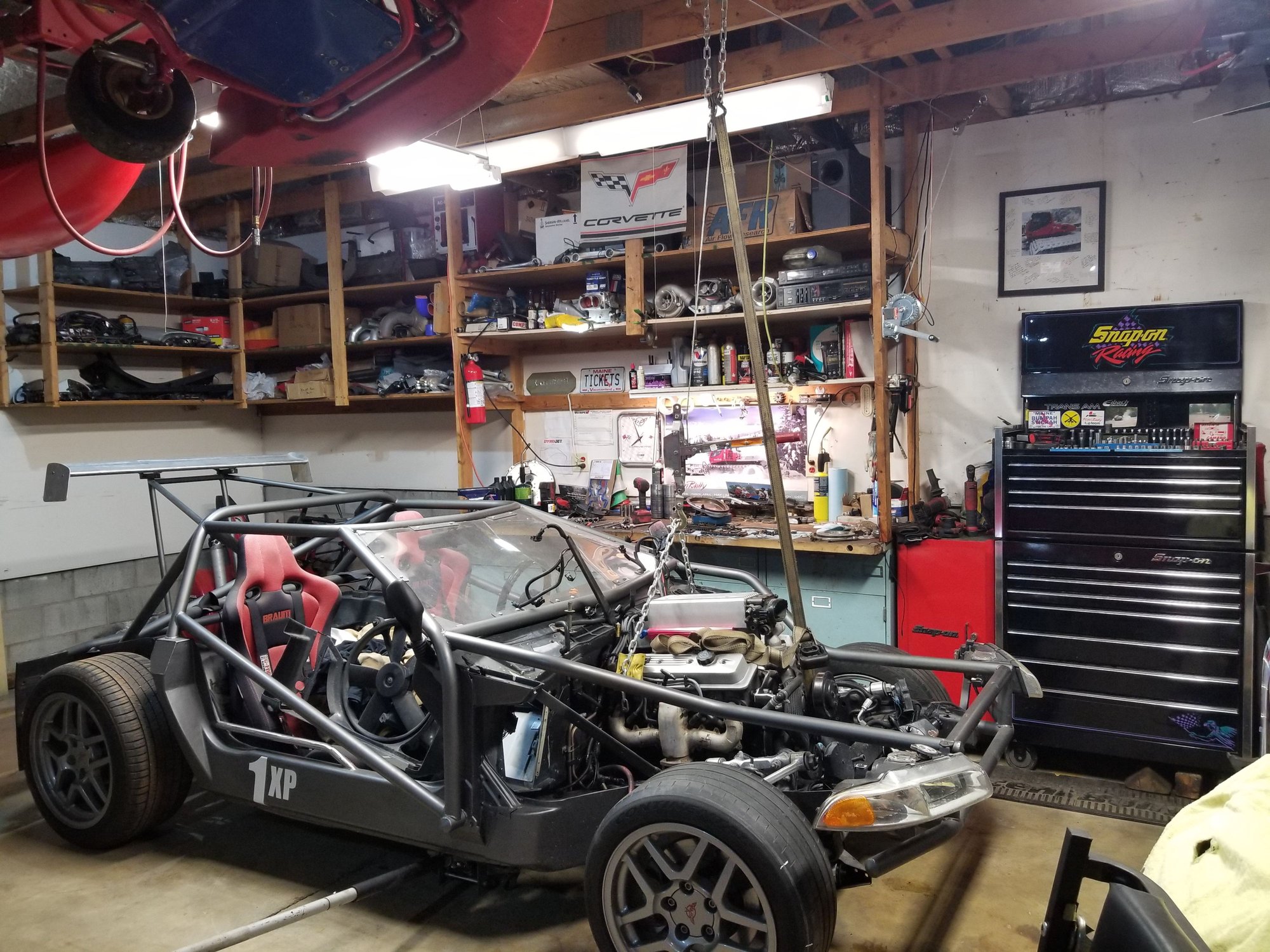

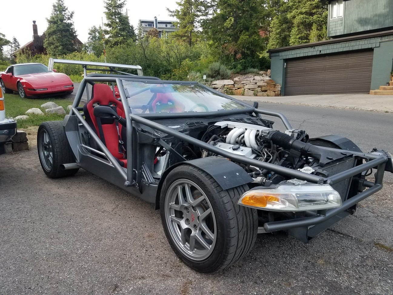

I'm mostly writing about this b/c I'm pretty excited. You know how long it's been since I ordered parts from Summit to actually DO something with my/a car??? Way, WAY too long. Over 20 years. I did the Kart project, but that didn't require much for parts, and those that it did, I made or modified to work.
Anyway, The Kart's dead-dog L98 is coming out, and the ZF6 (toughest transmission ever put in a car!) is coming out with it. The L98 does deserve a moment of respect; it DID do 289 RWHP, with an intake and exhaust. Anyway, replacing those parts are a sbc 400 w/cam, light porting to the L98/113 heads, American Racing headers, HSR....and requisite tuning...in one form or another.
The ZF6 will be replaced with a T5. You know how long it's been since I messed with an F-bod T5?? Probably close to 25 years! I'm looking forward to picking it up with my bare hands, lifting it up into the trans tunnel, and sliding it into the bell housing. Ahh....Haven't done that in a while. A loooong while. Tonight I ordered the required items to slap it all together:
'Vette pan, with LH dipstick and 2 pc RMS
Flywheel
Clutch kit
OEM Roller timing chain, thrust plate and cam button
balance plate for the 400
6.1" damper for the 400-in-a-C4
Short throw billet shifter w/adjustable stops. Mmmmm it's been a LONG time since I rowed one of those in a T5.
Gaskets to put the engine together....that's about it. Stuff should be here next weekend, can't wait to start throwing it into the car....can't wait even more to drive it. Funny thing is, I think I'm more excited to shift that shifter than anything else!

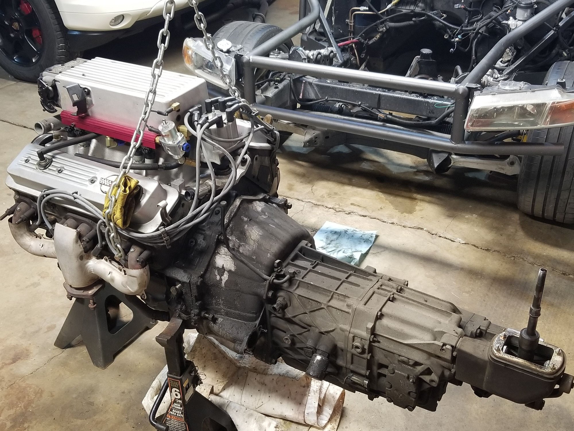

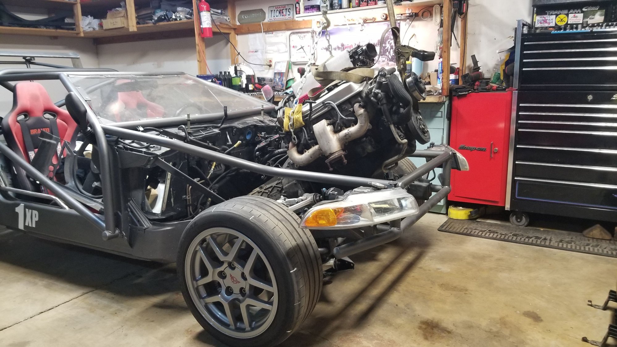

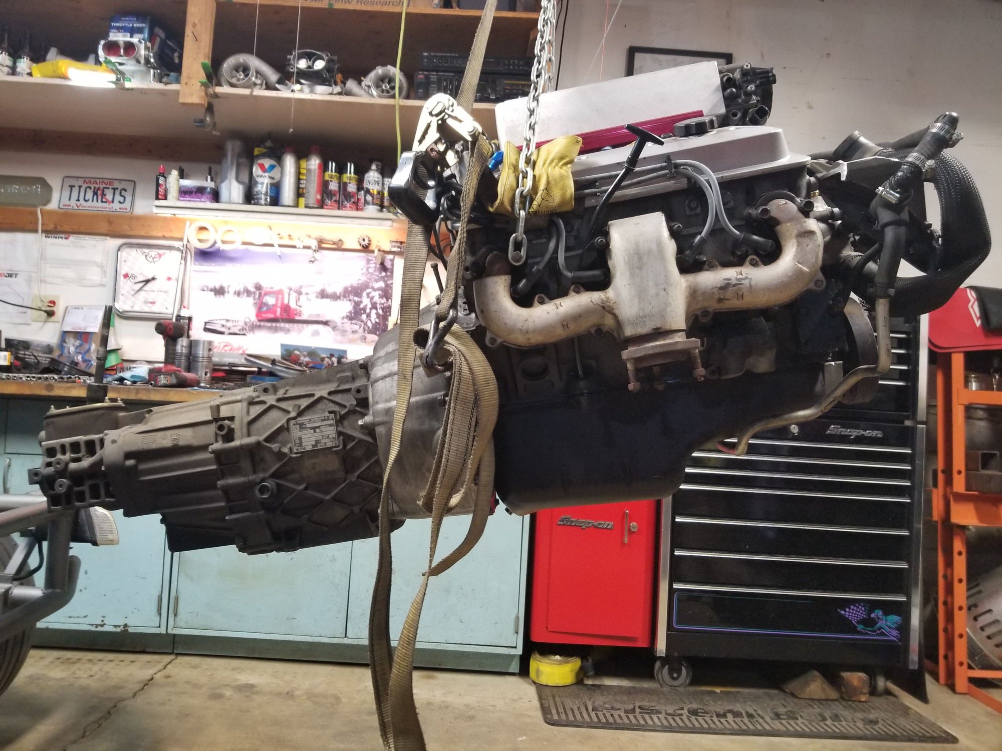

Welp....I learned that pulling the engine w/the trans attached isn't the best way, on a C4. I won't do it that way, again. I'd seen it written about numerous times, but dropping the trans first would have been a better way to do it.
Old Jul 30, 2025 | 09:11 AM
Firechicken82's Avatar
Joined: Aug 2021
Posts: 1,254
Likes: 356
Car: 82 TA
Transmission: Magnum f
Axle/Gears: Ford 9 w 4.11
Re: Vette Kart changes
It's kind of convenient, you don't have to take the hood off!
Old Jul 30, 2025 | 09:17 AM
Vader's Avatar
Posts: 19,679
Likes: 316

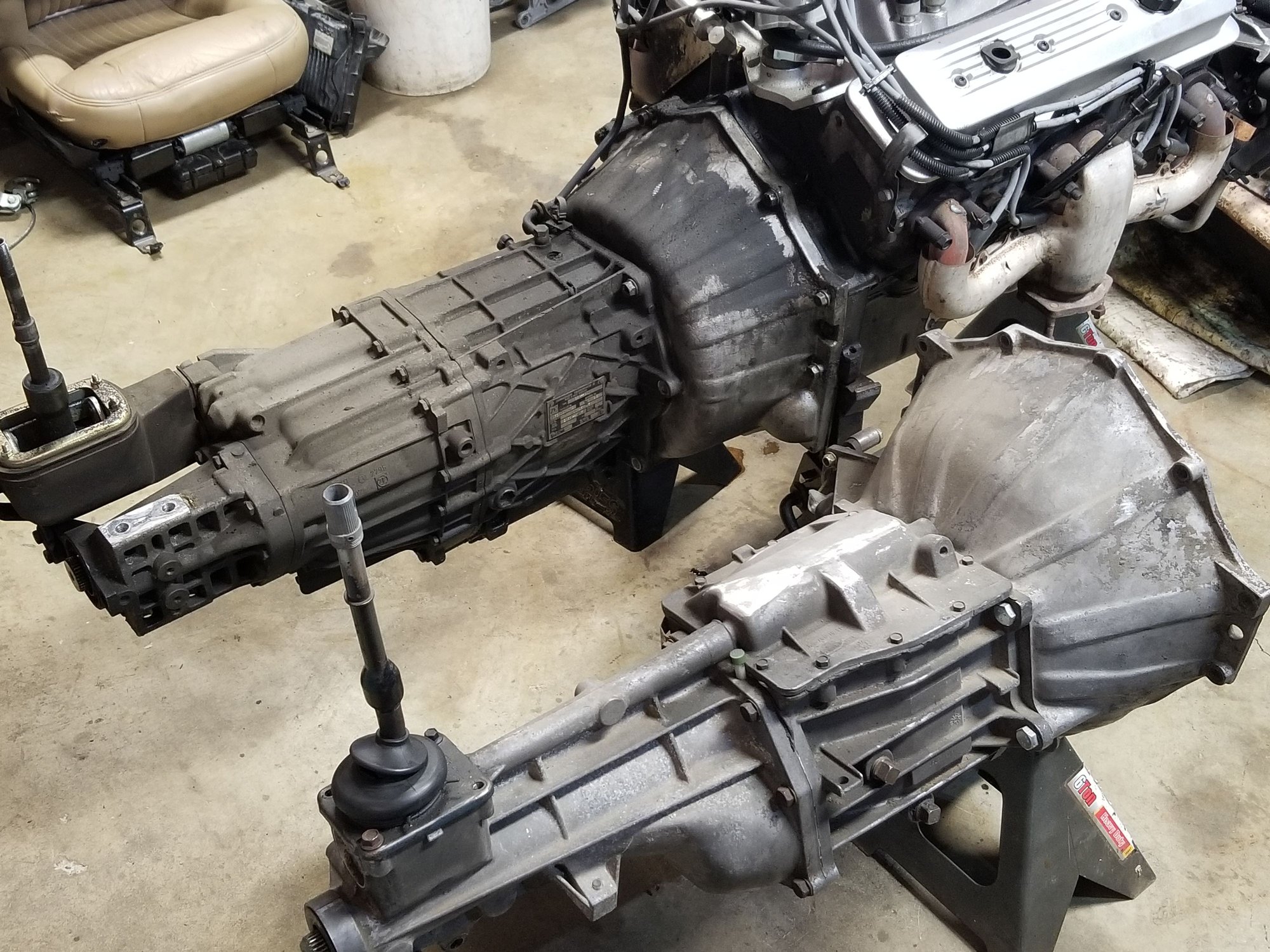

That second photo underscores your point about the trans swap. It's easy to forget how large those truck-based boxes are until you start wrangling one around.

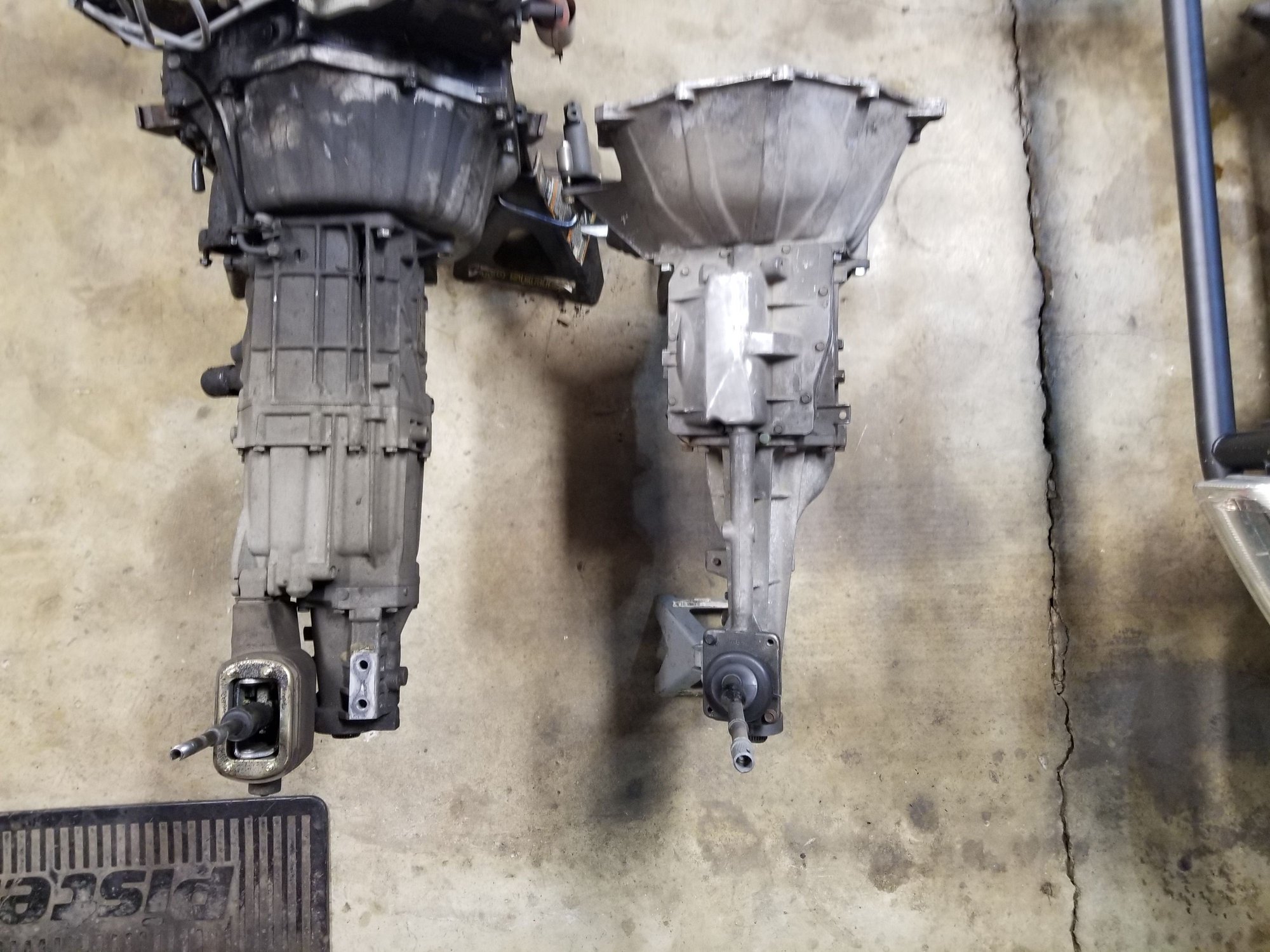

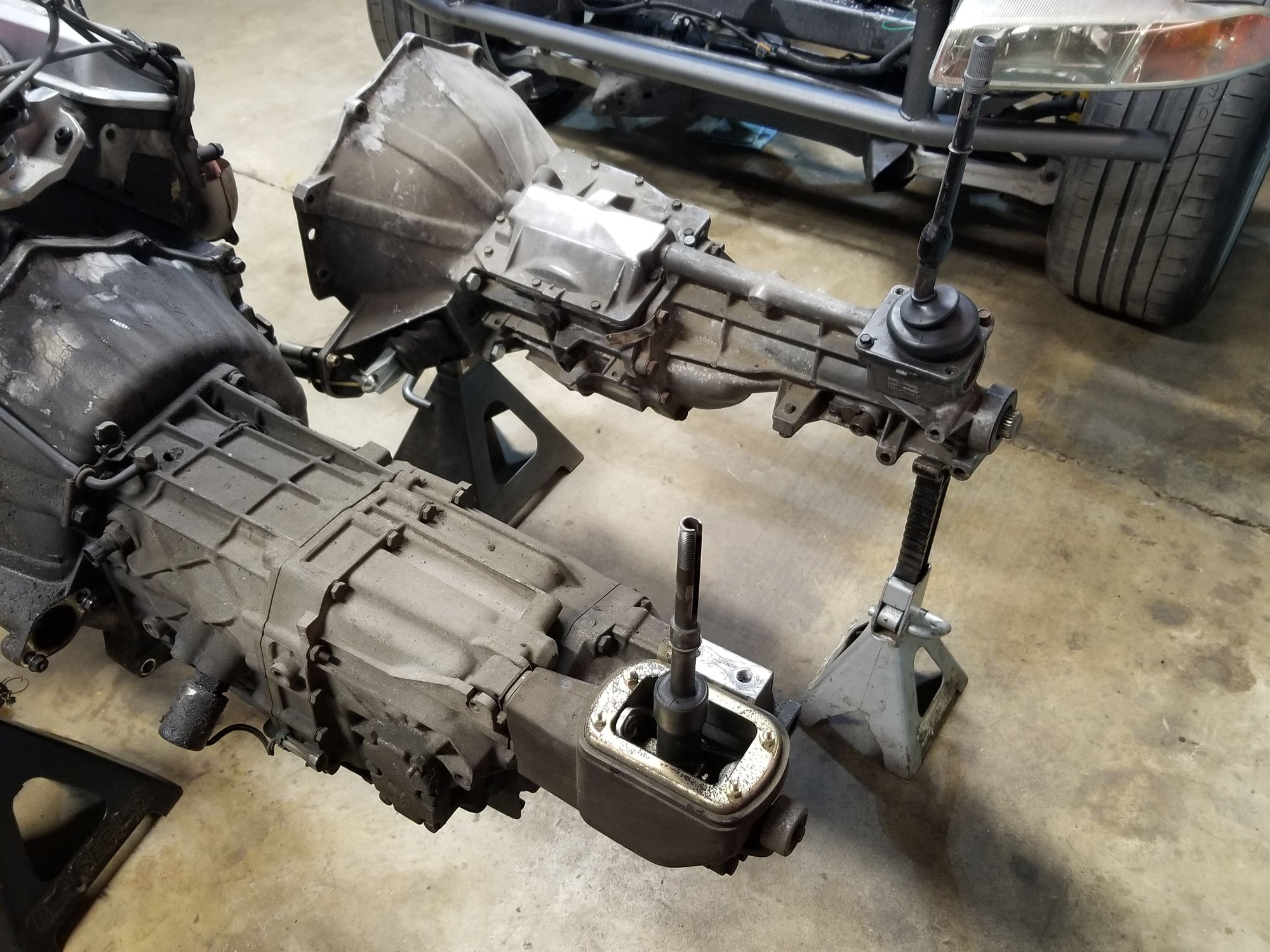

Totally! That was my exact thought once it was out and I was looking at the thing....I was thinking, "My god, that trans is a BIG chunk!"
I'll put the T5 next to it and take a pic.

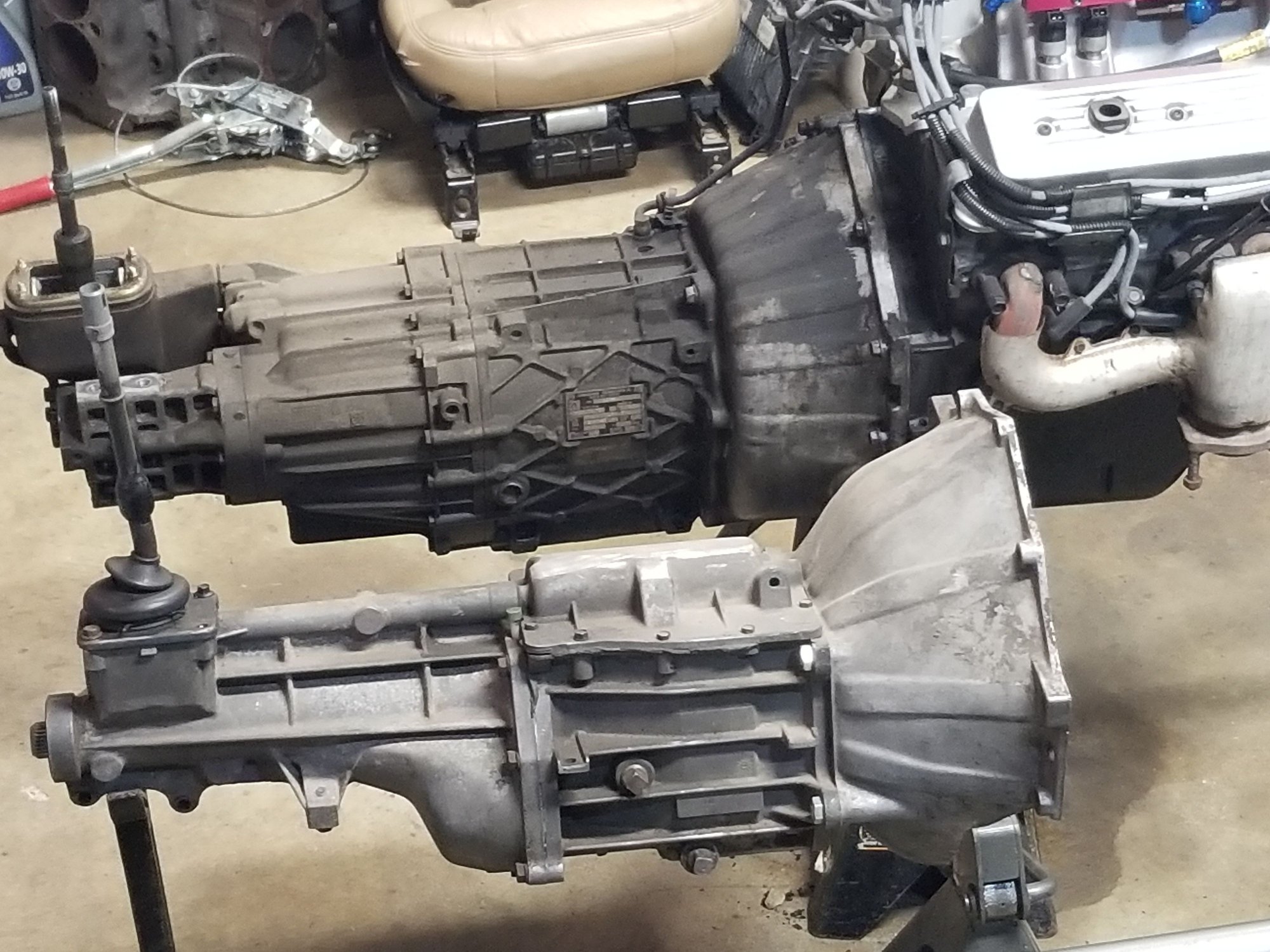

Not sure what that means exactly? But you're right on w/the reasons for switching, as it relates to the Kart....except for the gear ratio stuff. Both the T5 and the ZF have good and similar ratios, 1-4. I don't believe that any '89 had a 3.45. This car has a 3.31 rear....too tall, IMO, even for the Kart.
As promised.....Arnold vs. Pee-Wee....Beef cake vs. Pin-pin....

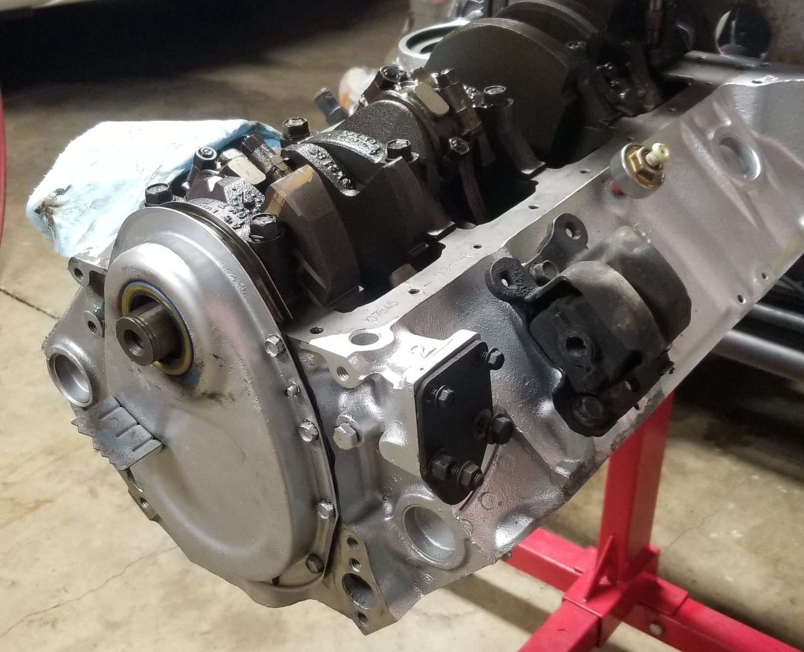

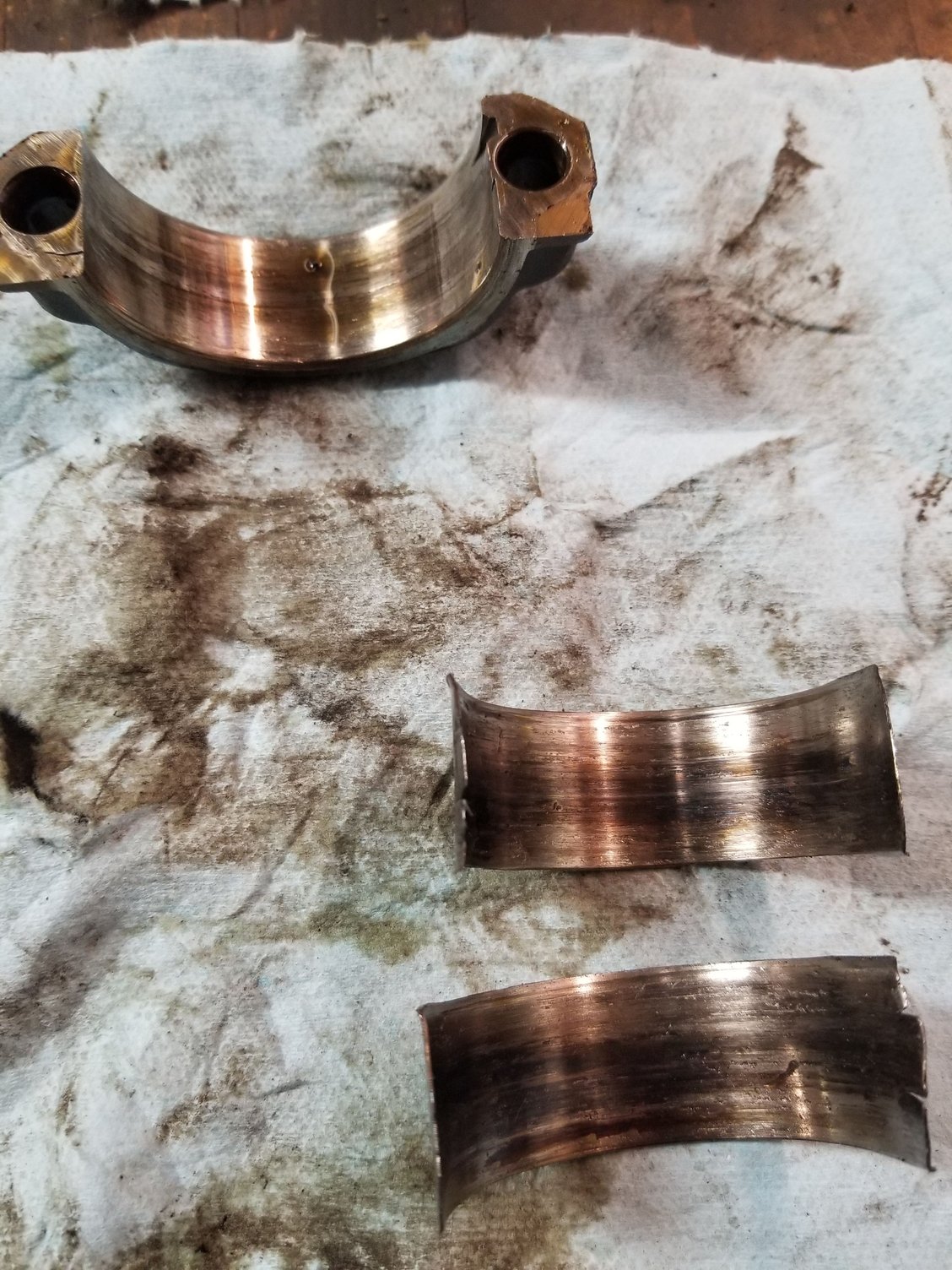

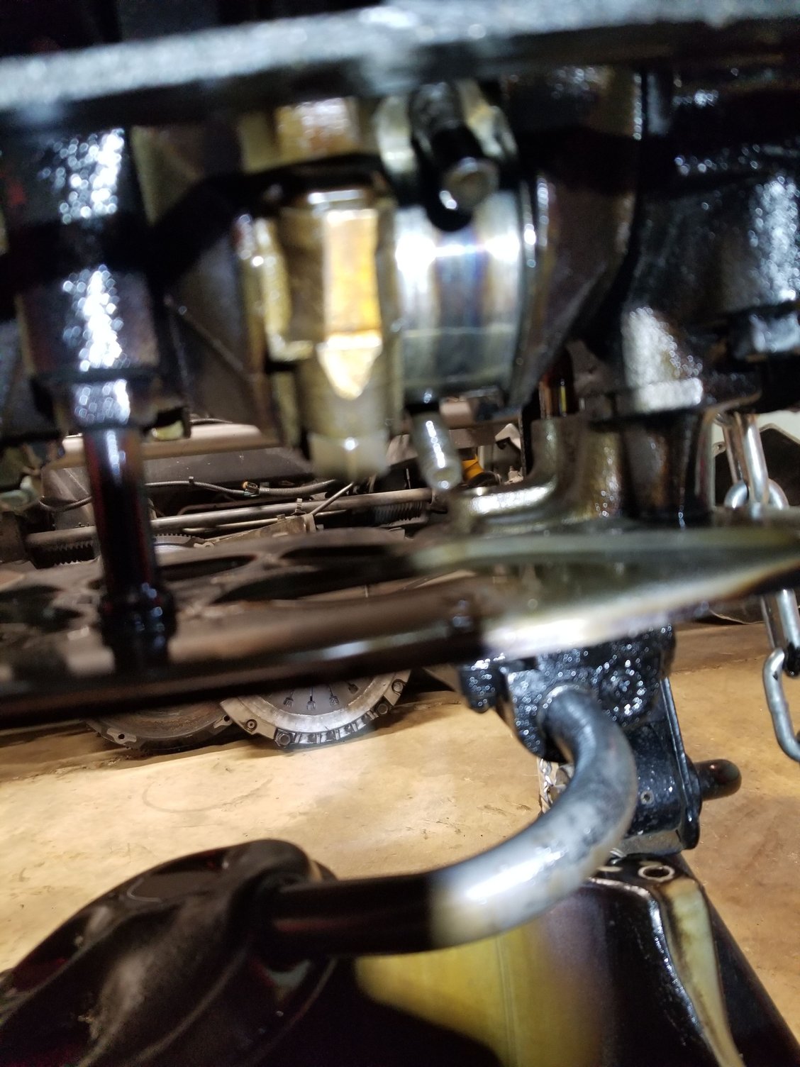

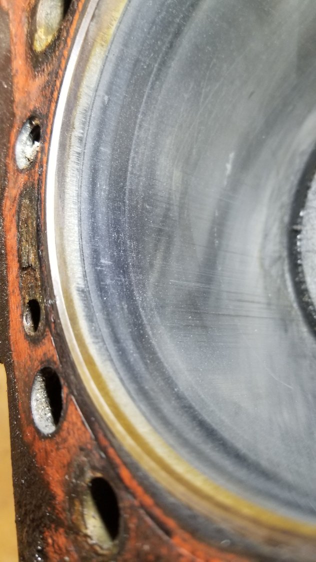

Finally had a minute so tore the 350 down, got the heads to the machine shop for 400 steam holes and a chop, if necessary. 400 is ready for the heads.
For S&G's. dropped the pan to see what all the knocking and fuss was about....looks like lack of oil, to me. Which is weird b/c the thing had plenty of oil, fresh oil, and great oil pressure.
Ring ridge was pretty slight for the mileage and poor maintenance the PO had provided for it.
....but the cross hatch is long gone, which is pretty bad for ~160k.

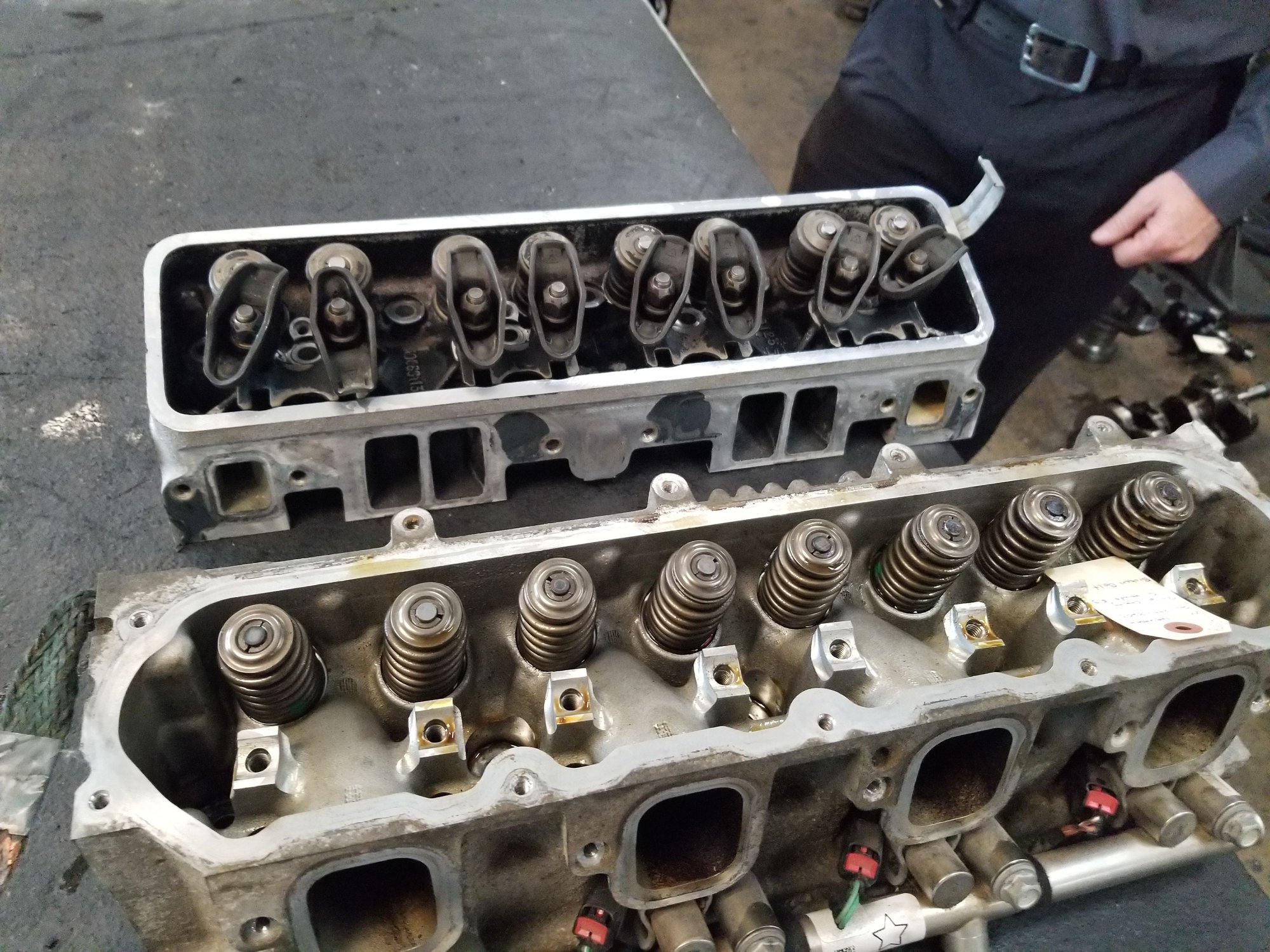

When I dropped the heads off, I set 'em on the counter next to some late "LT" heads....my god, look at the difference in the size of the intake ports!! GEEZUM, BUB!....

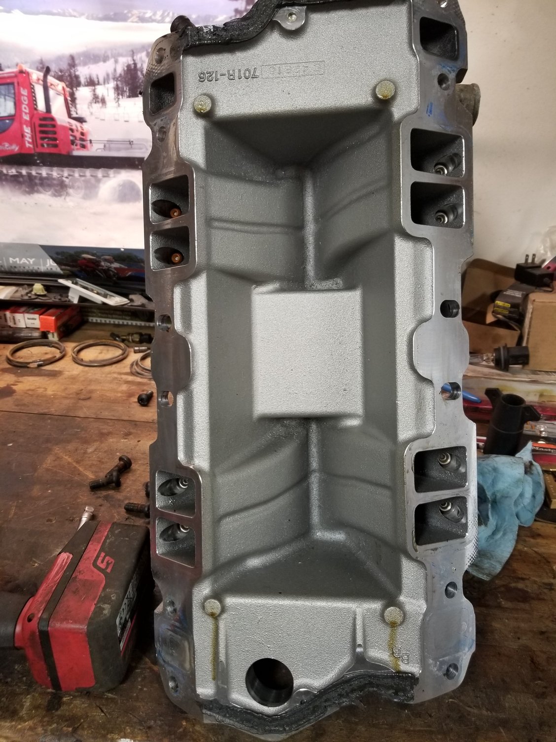

Another kind of funny thing, when I pulled the intake off the Kart engine....virtually no oil on the underside of the thing. Haven't seen that before....
Old Oct 14, 2025 | 01:52 PM
OrangeBird's Avatar
Joined: Feb 2012
Posts: 3,939
Likes: 801
Car: 1989 Firebird
Thank You very much for those transmission pics Tom, , , , , I never woulda guessed the Vette transmission was SO much bigger than our petite lil T5
Old Oct 14, 2025 | 03:35 PM
TTOP350's Avatar
Posts: 12,231
Likes: 1,158
From: Il
Engine: 4++,350 & 305 CIs
I can say putting the ZF in my 92 f-body required some serious massaging to the floor pan in places.
Definitely a weird failure, oil filter issue? Rodbolt stretch type failure?
You're welcome. I'd never seen one in person, out of the car, so I was pretty surprised also, once I had the thing out. Also surprised me when I removed it from the bell housing and set it on the floor...frickin' HEAVY!
IDK....the rod nuts were tight when I removed them. The engine was pretty full of sludge...I wonder if a chunk of sludge plugged the crank passage?....but since it was cyl 8, you'd think that would have starved both 7& 8? I'm not sure.

Putting the 400 together when I have a minute here and there,
.....and ran into some BFS....
BFS
Old Nov 2, 2025 | 05:12 AM
TTOP350's Avatar
Posts: 12,231
Likes: 1,158
From: Il
BFS
That doesn't look very good
