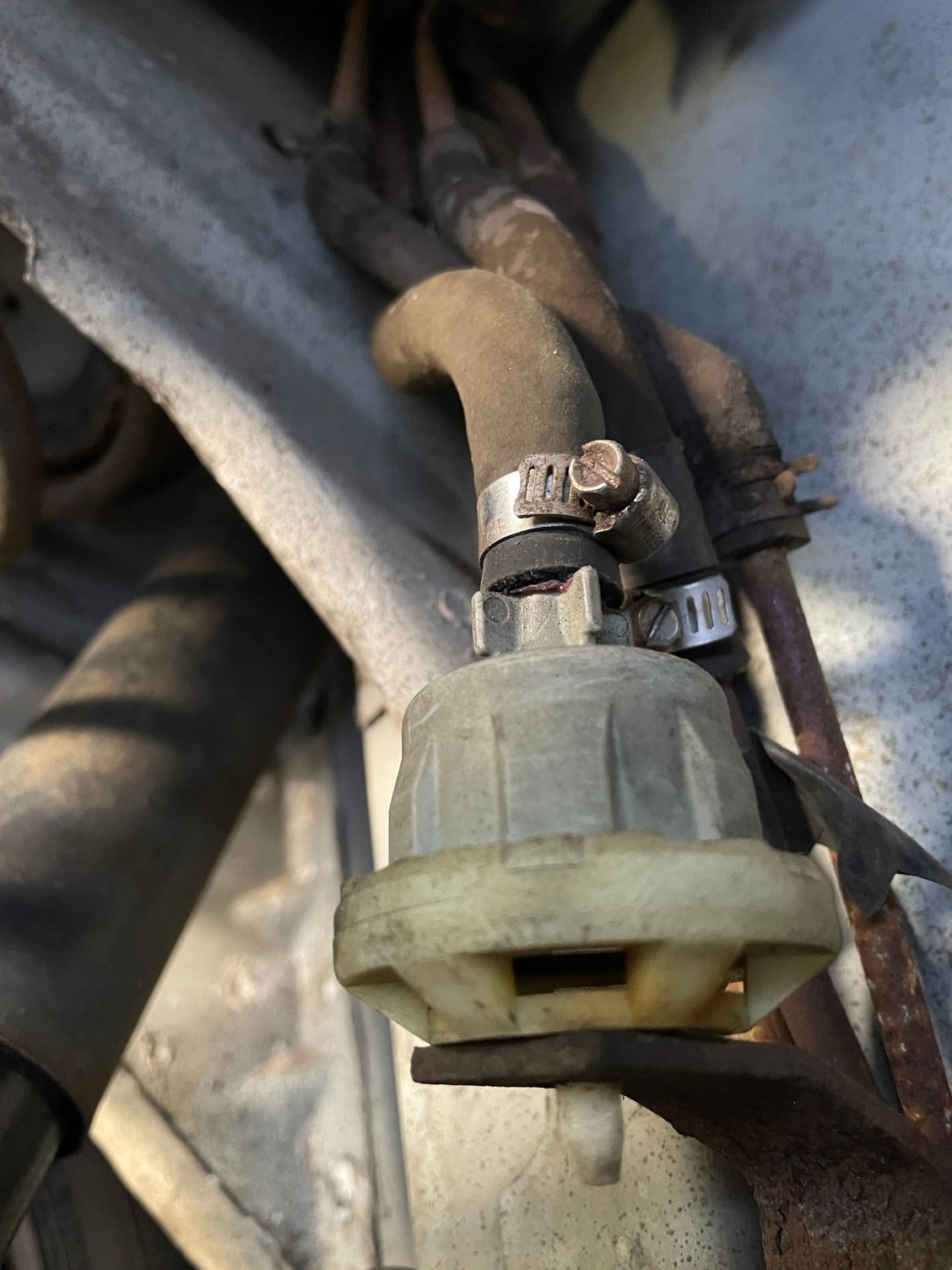

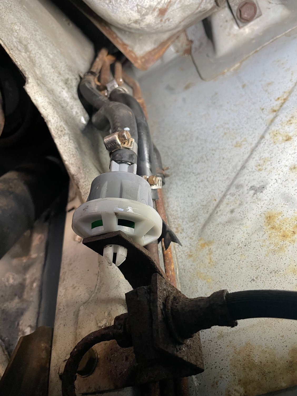

also, Amazon sells the replacement 2-way valve that mounts above the rear axle for the tank. Did mine about a year ago (see images below). After decades of use, it was seized open.

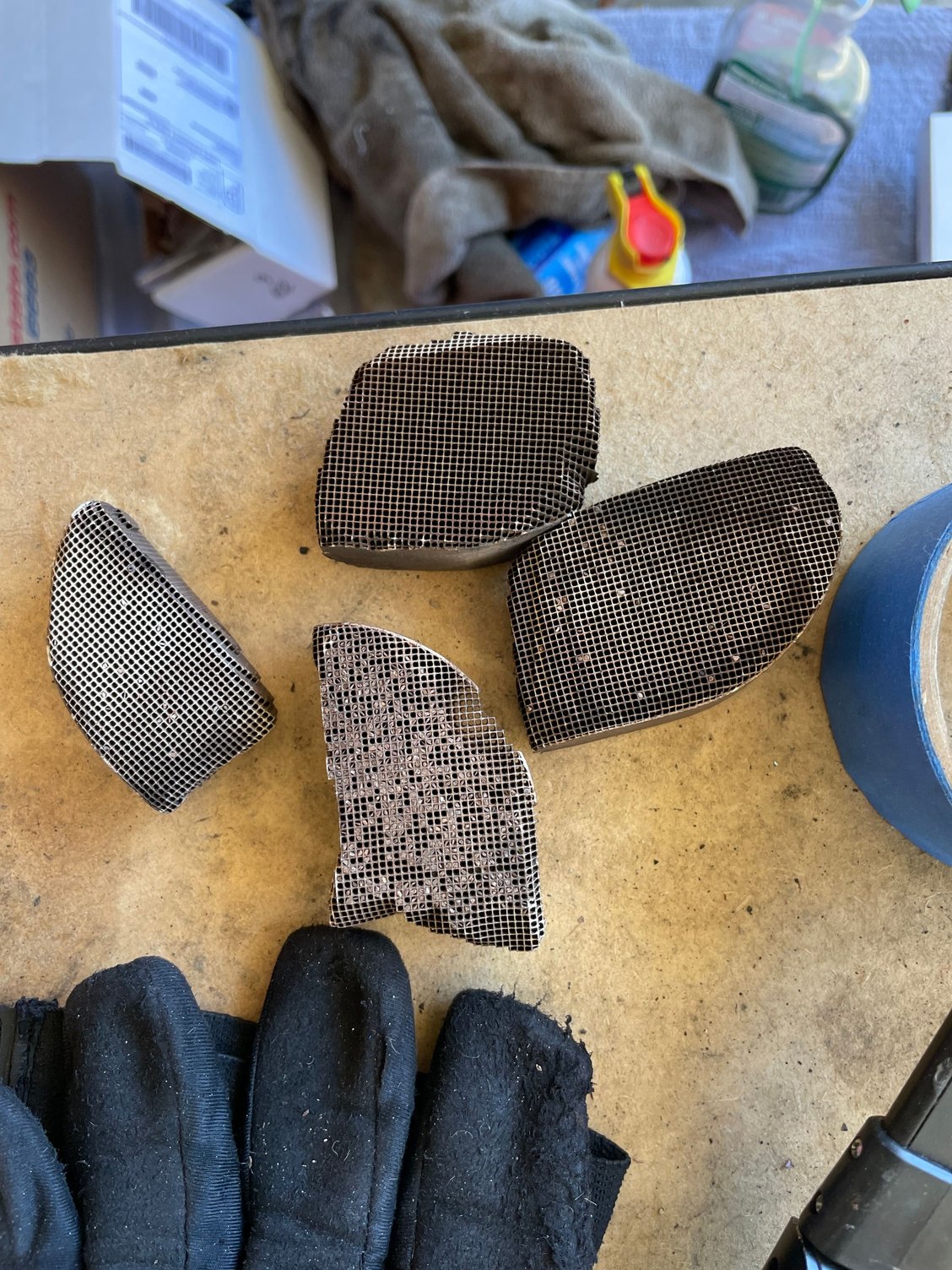

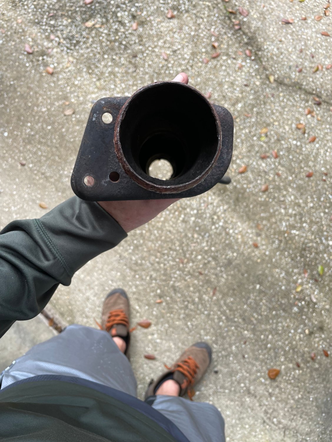

as for that rattle in the muffler, mine was due to a self gutted cat 🤣 (see image below)

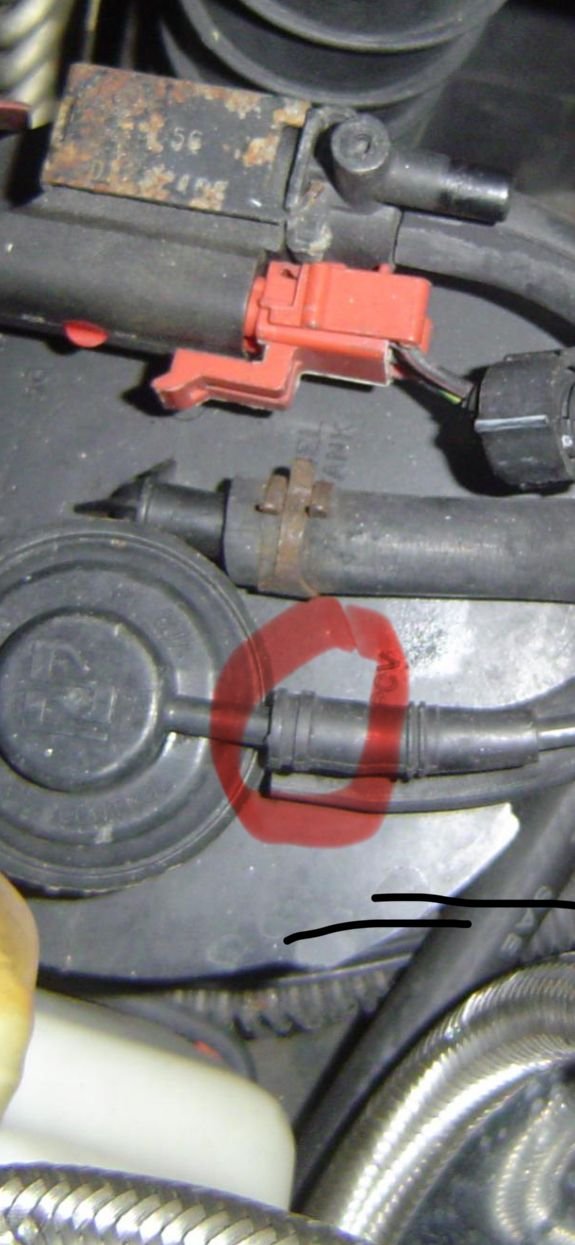

I can’t thank you enough for the reply! I actually replaced that two way vent valve by the rear differential hoping it would solve the issue but it didn’t? I will definitely try pulling that ported vacuum line and plugging it but I’m not sure which one you are talking about? I know that there is the large vacuum line that goes from the solenoid to the circular looking valve on the canister forming a U. Then there is another thinner vacuum line attached to that same circular valve that leads out. I would love to know exactly which one to plug and hopefully get to the bottom of this issue. Also will plugging it cause any issues? I never thought about a gutted cat??? I wonder if that’s my issue? Was it causing a rattling in the rear muffler? Finally I definitely have to get that system you mentioned to stream live data! I just home I can figure out how to use it! Again I can’t thank you enough for the response and hope that whenever you can you can specify which hose to plug

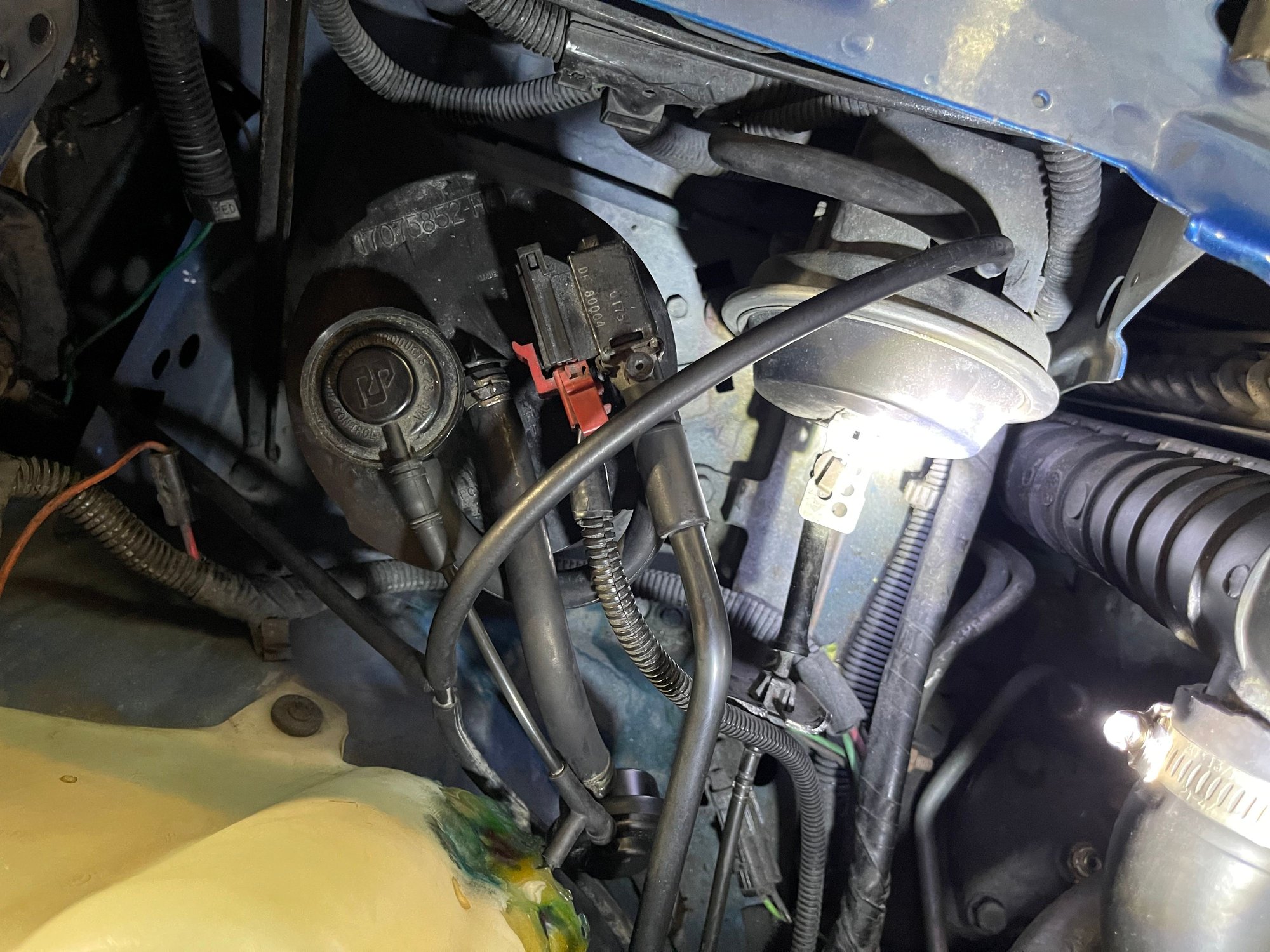

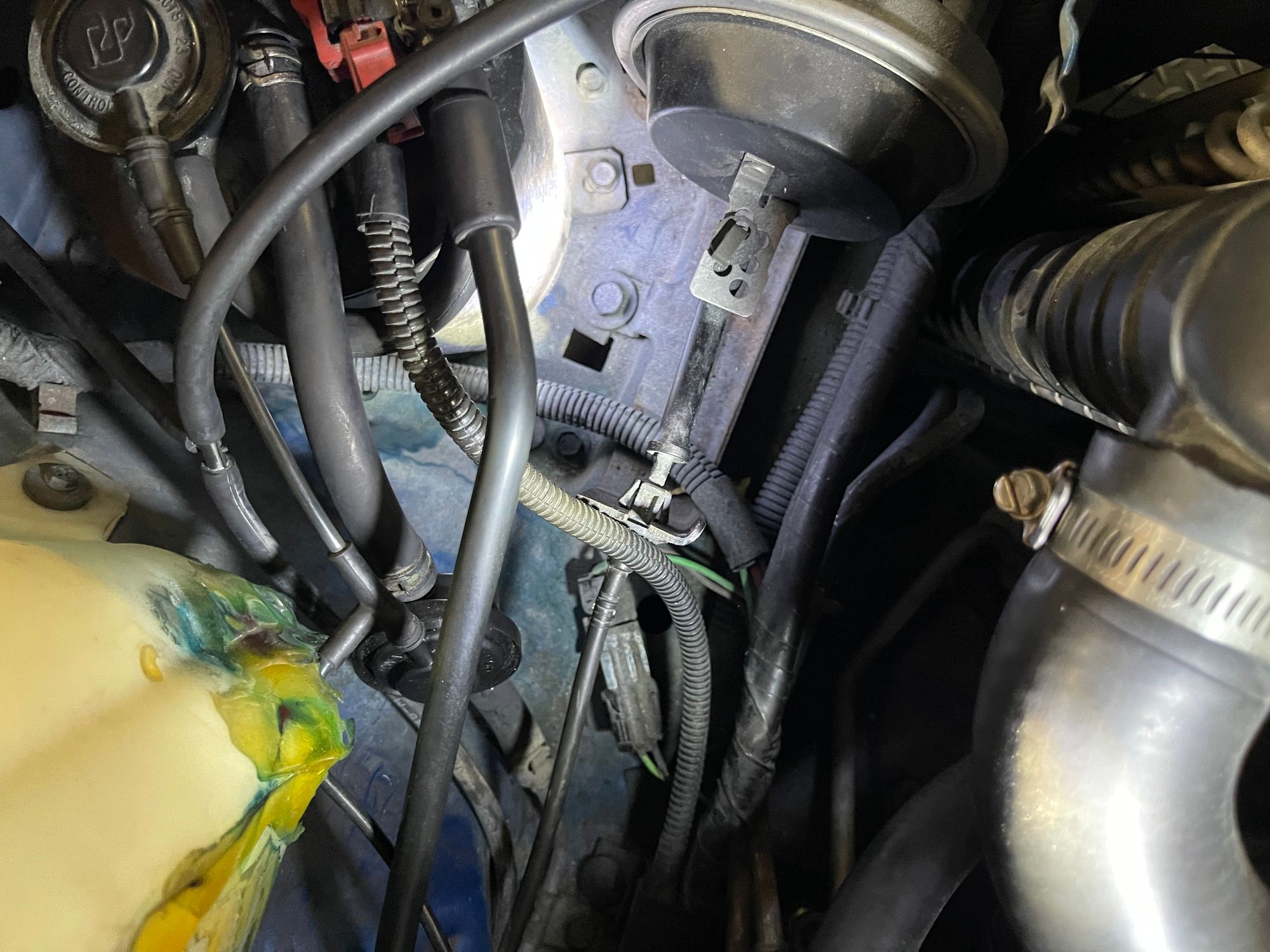

Is this the hose that I need to remove and plug?

You got it. Follow that line to the intake and where it lands pull it and replace with a rubber cap. If you’re unable to get to it where it connects at the intake, plug the line you’ve circled and cap the valve.
essentially you are isolating the evap system to see if it is in fact that system that’s producing the assumed vacuum leak. Again, data logging live streams will help diagnose and help pin point your starting point on the troubleshooting tree.
Here was my culprit of an annoying rattle in my muffler. After removing the exhaust to gain access for a fuel pump replacement, the honeycomb chunks fell out.

I can’t thank you enough. I will try that in a little bit! I’m also assuming that’s the issue with my muffler!

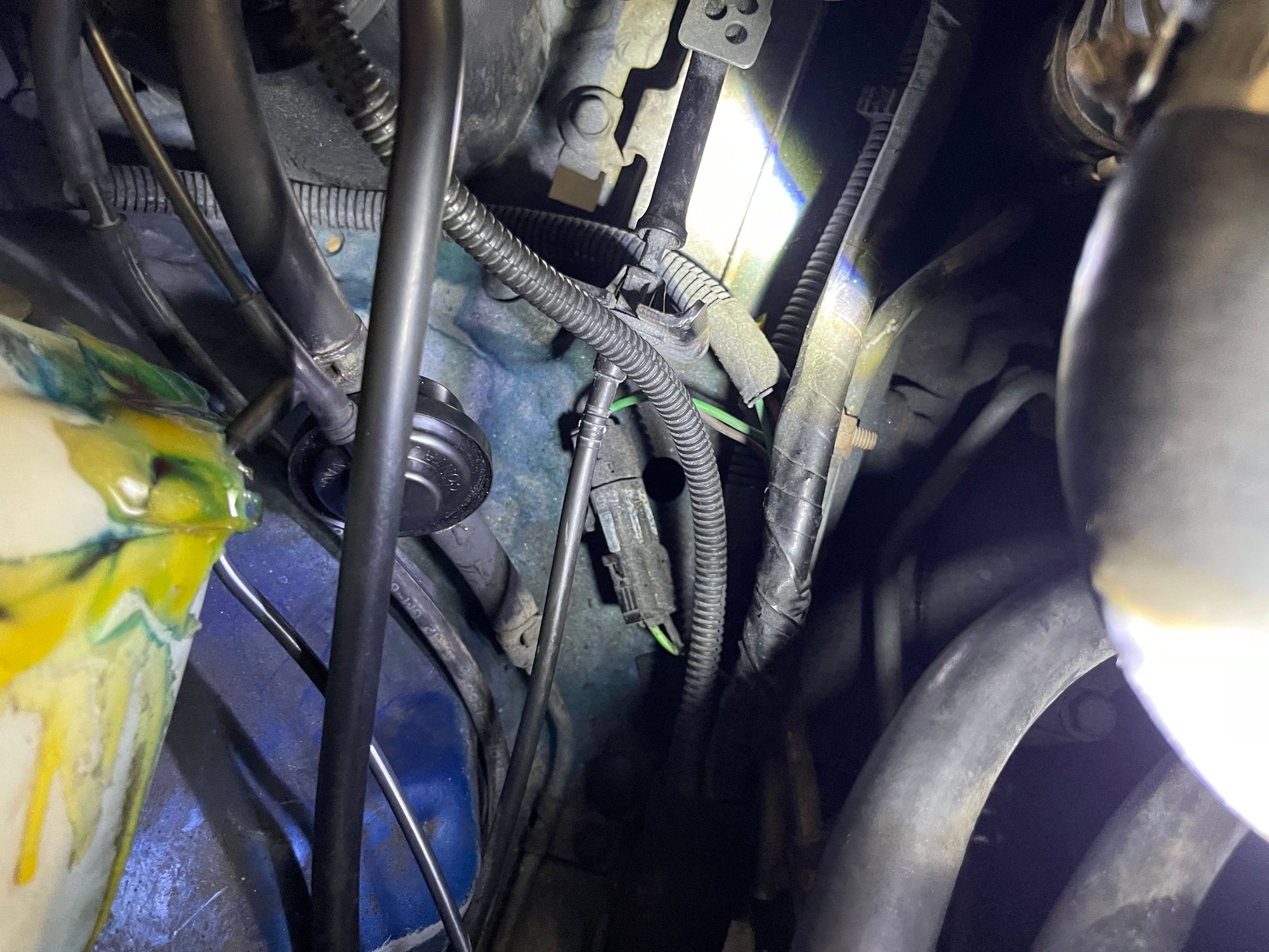

You should also see one of these down there. Might check it and see if it looks in good condition. You can take them apart and check the diaphragm / spring and clean it up if needed. https://www.rockauto.com/en/moreinfo.php?pk=1597032&cc=1251650&pt=4936&jsn=663
Or is that what
is shown in your photo? maybe your year car is different than a 90. looks like it may be mounted to your canister.

I'm a bit confused, are you saying post #4, the thing that is circled you have 2 of them installed?

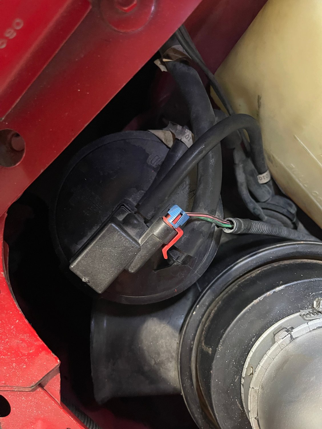

Yes the evap systems on the earlier third gen’s were different than the later years. For example on my 86 IROC which I’m having issues with there are 2 of those things like I have circled. One that is attached to the canister that can’t be replaced and one that is not attached but has a tube leading from the canister. I replaced the one that’s not attached with a new one. Now on my 91 GTA there is only one of those and it’s not attached but also has a tube leading to the canister. That’s why I was a little confused when you said to plug the ported one because there are 2. I will take pictures in a little bit and post them

91 GTA
91 GTA
