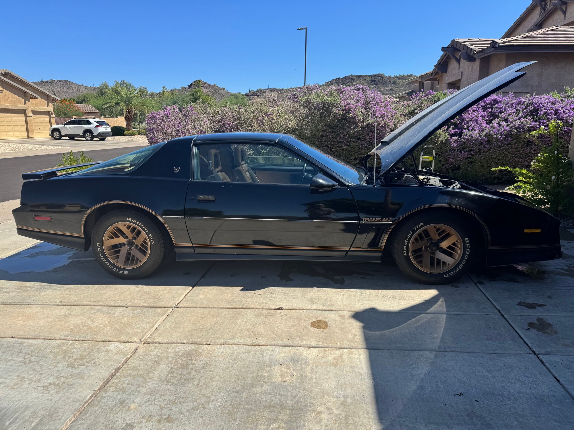

I’m looking for the correct TVS switch for my ‘84 Trans Am. This appears to be connected to the charcoal canister and is located on the intake manifold near the water neck. The original one is broken. There is a number embossed on the outside 3049287. That may be the GM part number? I checked the inter webs and found the A/C Delco p/n 212-101. Both of these numbers seem to be discontinued. I saw another thread with a similar issue and the recommended part number was
GM 10055876. Is this the correct part number for
my application?
