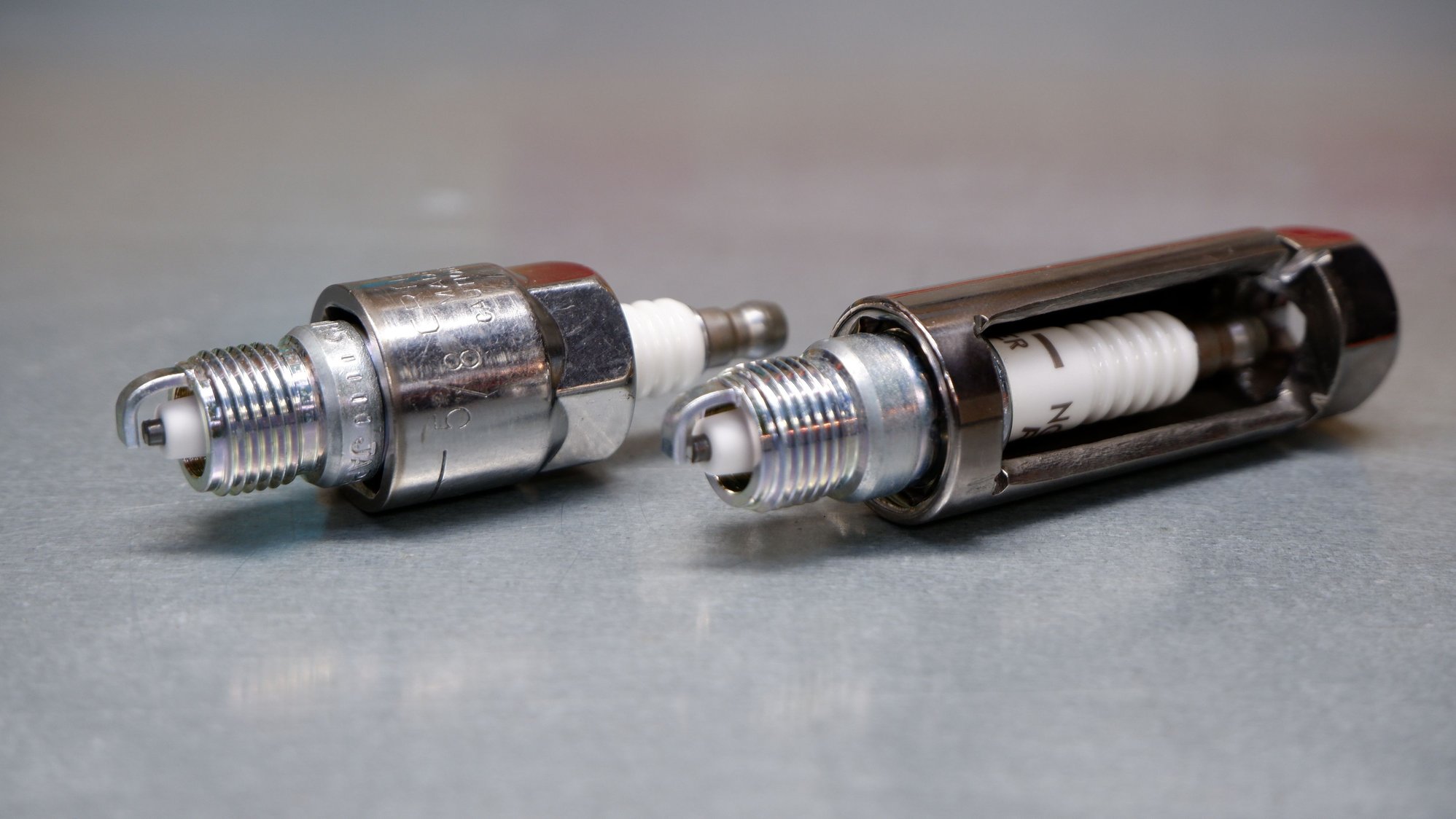

Really don't like headers on a thirdgen, when it come sot changing plugs. With my back these days, I don't wanna climb under to get a few of them. My 2nd TA with these Hooker mid-lenght headers.
Figured I'd share the results of cutting up a few plug sockets. So far they seem to make it a lot easier.
Hopefully it saves some time and headache!

Examples of what to do, pretty easy. One you cut the socket down and drill out the 3/8 end, the other you cut out a window.

For all the years I've been dealing with SBCs and headers, I've been using wrenches. Straight ones, bent ones, ones with an offset, sockets I can put a wrench on, etc.; basically, any and every variation of 13/16", and later 5/8", wrench, that I could find. I even "customized" a few with heat for some particular customers' motors. Especially since some headers over the yrears have been routed such that it's completely impossible to get ANY kind of socket WHATSOEVER onto the plug, or the steering column was in the way (attention tri-5 owners), or whatever.
Butt hay, any trick that allows you to get your particular spark plugs out of (and back into) your particular car with your particular headers, especially if it's easier than whatever you were doing before, is a BIG WIN.
