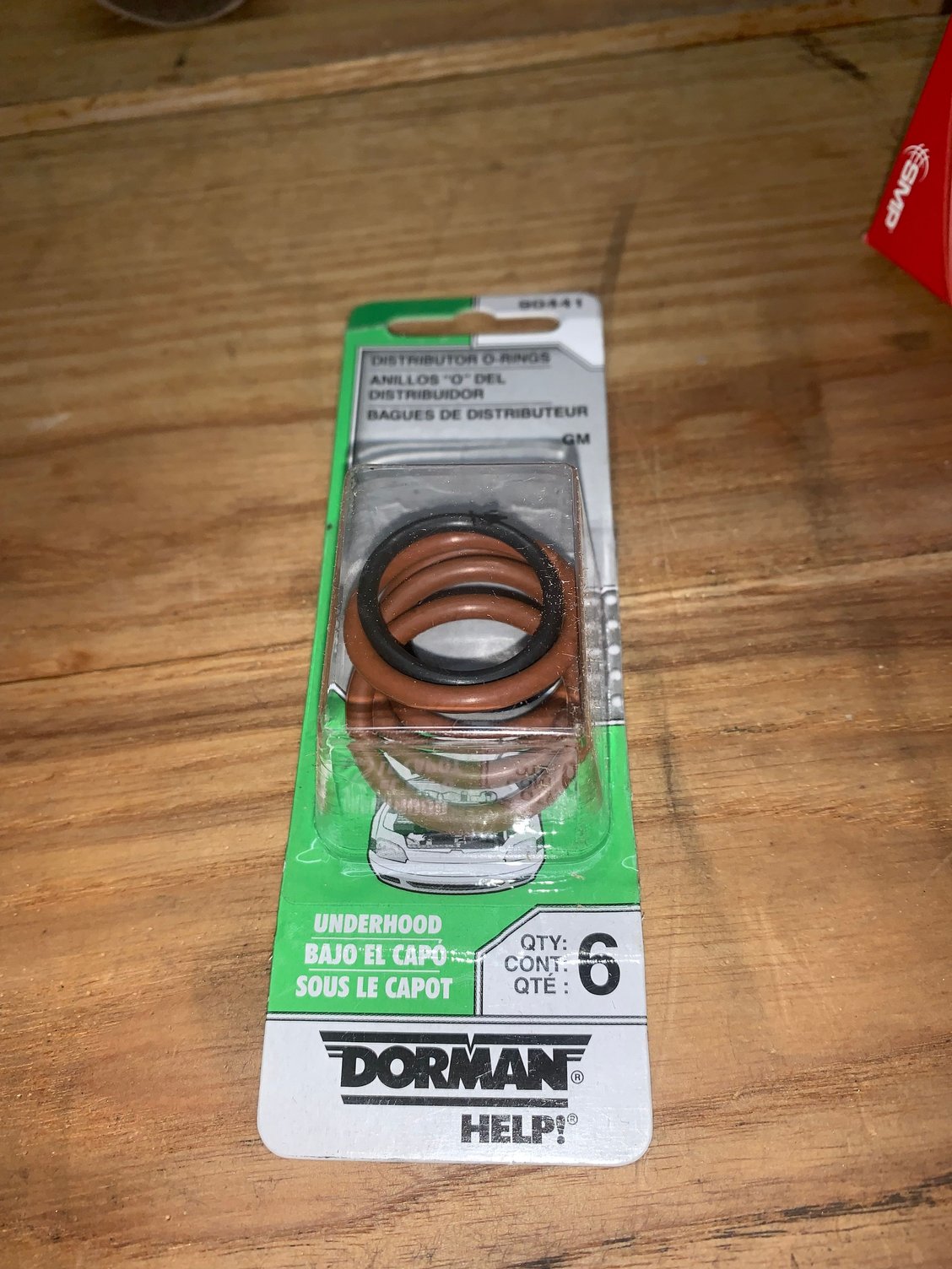

The Dorman part number for these O-Rings is 90441
The Outside major diameter is 32.6mm
The inside diameter is 25.6mm
The O-Ring material cross section is 3.5mm
The O-Ring material is high temperature and oil resistant silicone rubber.
Please keep in mind that these measurements were made with a set of dial calipers and the material is rubber so it's hard to get a totally accurate measurement, but it's close.
The black one in the package was the original O-Ring. The beige colored Dorman O-Rings were a little snug, but worked fine.

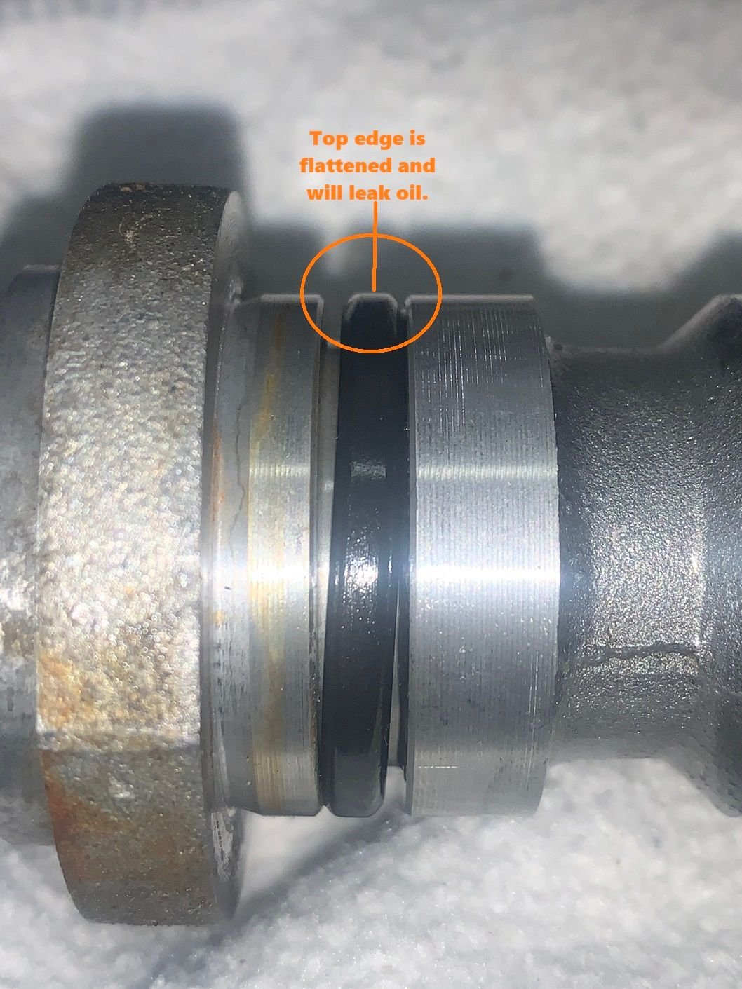

I replaced mine because of the flat spot on the outside which developed over 37 years installed.
