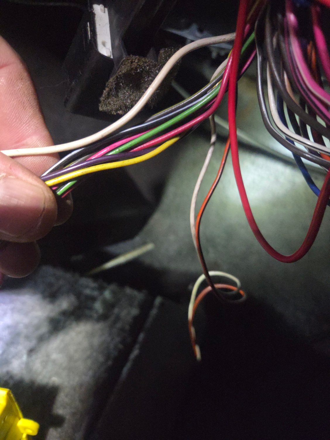

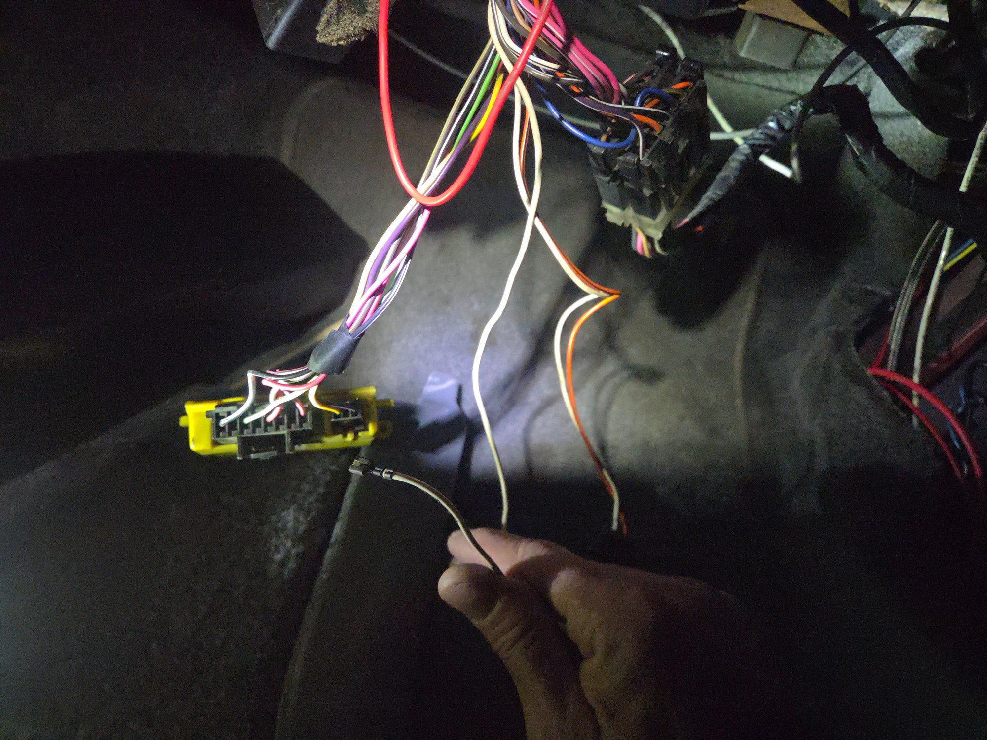

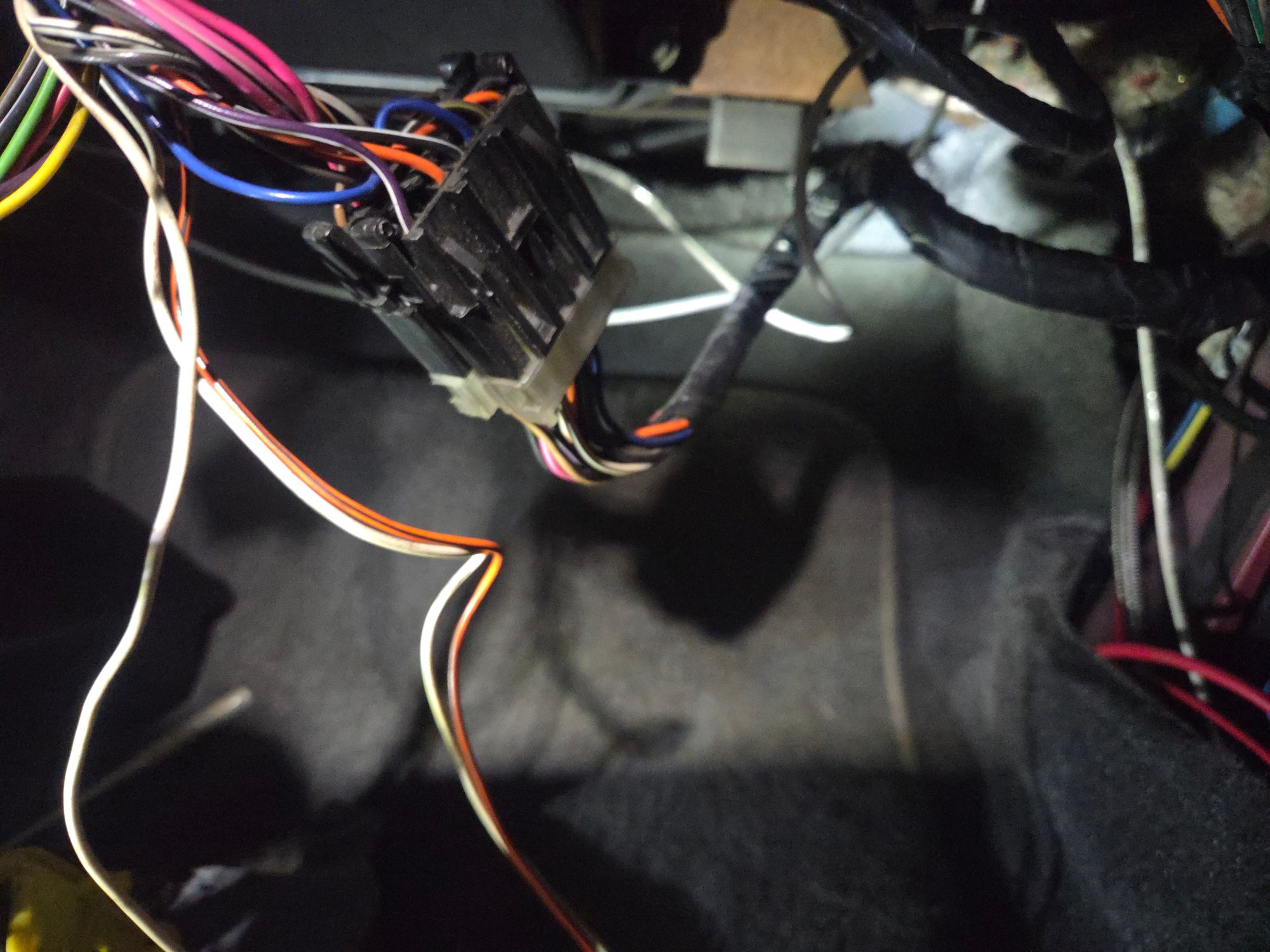

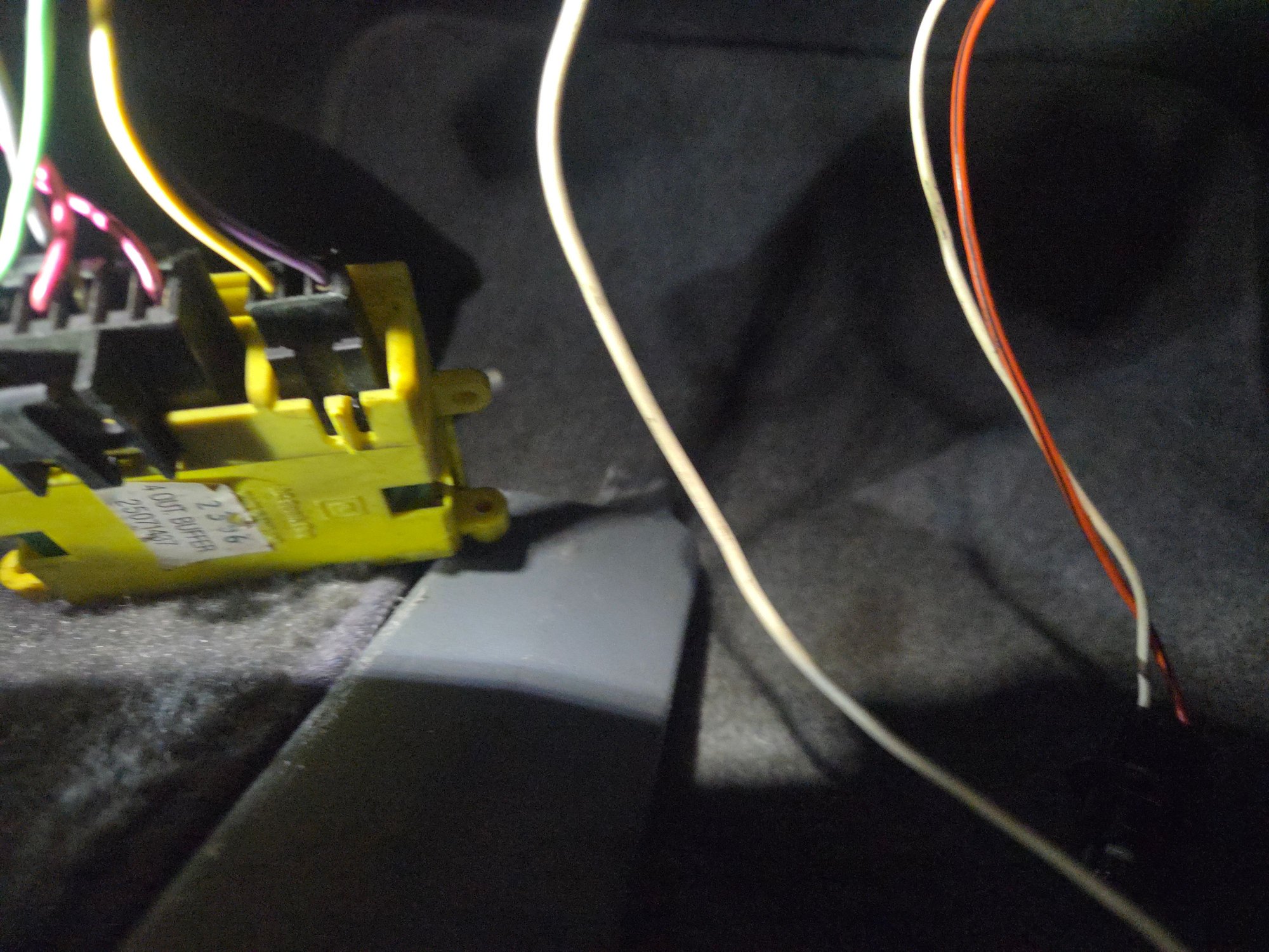

I got a loose white wire underneath the passenger kick panel anybody give me a hand in finding it's home?

White is used for:
Tachometer signal to the instrument panel;
EST feedback to the ECM, connector C1, terminal C8;
Vacuum regulator solenoid power from to the ECM, connector C2 terminal D8 (V-6 applications);
Courtesy light (interior) ground wire from light switch and dimmer module;
LH outside power mirrror;
AC compressor clutch, suppressor diode;
Power antenna "down" signal (and the relay is in that area);
Rear wiper motor power;
Rear cargo well light;
Fuel pump power, from relay to C200, where it transitions to tan;
Those are the common ones for 1988.

Thanks, I realized when I opened my pass door the interior dome light wasn't coming on. I think that must be wire.

Yup; most likely is supposed to connect to the light switch near the door hinges. Should have a quick-connect (slide) terminal on it, if so.
