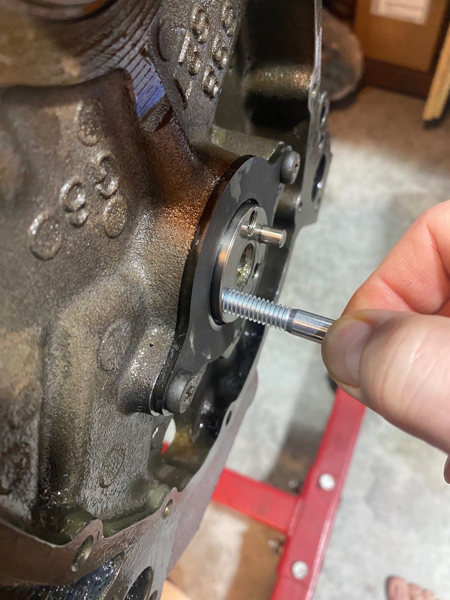

Finally starting on the rebuild of a near-stock 350 for my GTA. Original engine, had it machined, putting it together myself because I like a challenge and being hands-on. Quick specs:

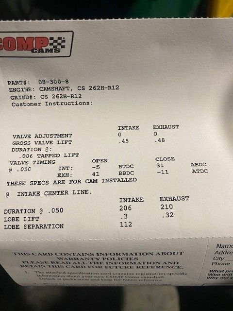

30-over hyper pistons, forged rods and crank (yes, I know I didn't need to go forged, don't judge me), Comp Cam (hyd roller, see cam card below), roller rockers, screw-in studs.
I'm installing the new cam and see a lot of play moving front to back. Is this normal, like maybe putting the distributor in removes the play? Sorry for the apparently huge pictures :-(

In its current state, it is normal. More than normal even. It's inevitable and essential.
The cam sprocket clamps it to the retainer plate when installed, in more or less the frontward position you show it in. Should end up with maybe .015" or so of end play.
Don't bonk it too hard against its rearward stop in the meantime. The only thing keeping it from going all the way through the tunnel and falling out the back is that giant freeze plug looking thing back there.

bolt on the timing gear and that stops the moving

Sofakingdom - Thanks! That makes sense, I'll be gentle with it until I install the timing chain assy.
