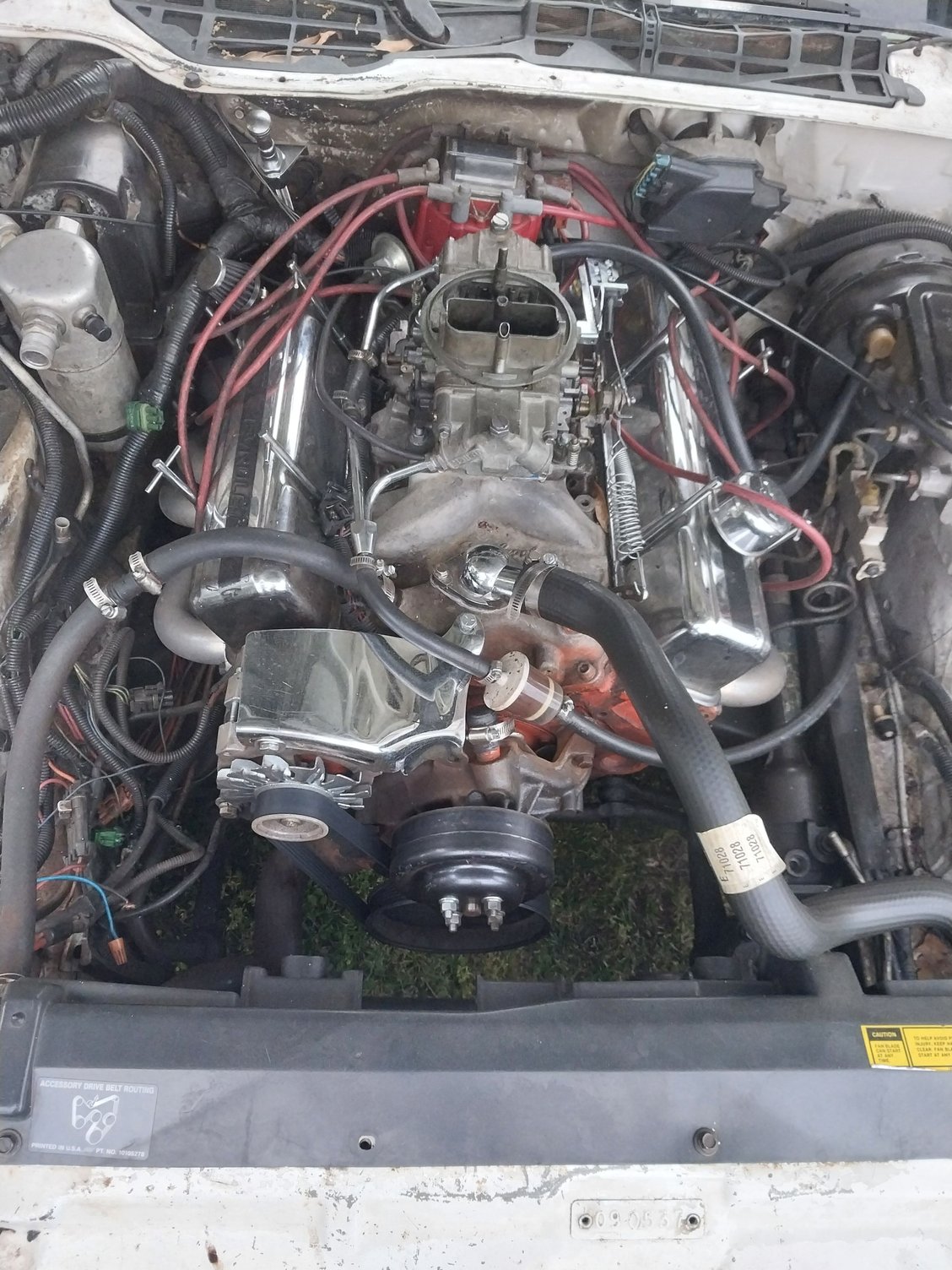

  1. Casting number will only tell you the block bore; specifically, whether 305 or 350, if it's a 1-pc RMS block. 350 bore will be casting # 683 or 880.
  2. Only ways to know for sure are to identify the crank, or measure the stroke directly. 350 & 305 stroke is 3.48"; 383 is usually 3.75". Piston part # might tell you, butt only if it's one unique to the longer stroke, since it's entirely possible to build a 383 using stock 350 pistons.
  3. Depends on how everything else is run. Maybe, if you're lucky. Without seeing it I can't guess. Somehow though, I'd be inclined to expect a land mine in there somewhere. I'd be real surprised if it was that eeeeezzzy. Could be, of course; just, that's not how that sort of thing usually works.
  4. Hard to say. If it has drum or Delco-Moraine (cast iron) discs, dead no. If it has drums and that's what your car now has, meh. If it has PBR (aluminum) discs, you just hit the jackpot. G80 is the generic RPO for "posi"; if it's really gear code GT4, it's a 10-bolt, which means it's an Auburn POS; if it has very many miles on it, like over 100k, it's probably wore out. Likewise, the axles are probably destroyed, so they'll need replacing. Once you get to that point, you could do all the same stuff to your existing rear if the other is drums, and put in the gears you really want, without buying the other. In case you can't tell I think that's a detour wherein you depart from the path to chase after shiny things out in the weeds somewhere, unless in the instance that it has the PBRs, which is REAL unlikely, since AFAIK there were no GT4 rears in these cars after the L69 was discontinued, therefore can't possibly be the combo of GT4 and 89-92 brakes.
As far as all the rest of that, EVERY PENNY you put toward anything that ISN'T whatever you "ultimately" intend to do, puts you ONE PENNY FURTHER AWAY from that other goal. I would not worry about the drive train AT ALL if you intend to put something else in it, beyond merely making sure it's safe (no fuel leaks etc.) and reliable enough to use however little you plan on. Under no circumstances whatsoever would I build another motor instead of just keeping my money in my pocket and letting my crotch itch.
AFAIK all 92s are "25th Anniv Heritage Edition". Nothing special about that compared to other 92s.
TPI only came on SBCs, so it came with "a SBC". A 383 is also usually a SBC. It's probably possible to make that displacement out of some other motor butt would be QUITE unusual to say the least.

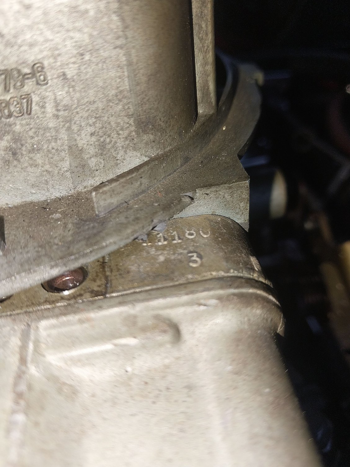

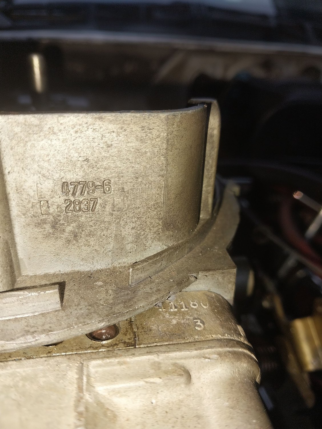

Carb part number
Old Apr 6, 2026 | 06:59 PM
Posts: 28,022
Likes: 2,496
Re: Where do I start?
That 86 rear is GARBAGE. It has the Delco-Moraine (cast-iron) discs and 26-spline axles. The Kiss Of Death. Keep your money in your pocket no matter how much "GT4" makes your crotch itch.
10066036 Small Block V8 350, 4-bolt, Goodwrench crate engine, 2-piece rear seal
OK fine... the CHEEEEEEPEST POSSIBLE 350 you could get at the time... think of it as a 85-back phone company van fleet replacement mule motor, slammed into in a 92 car, probably because some high school kid gearheaded the original to its grave. Probably utterly GARBAGE heads and whatnot. Doesn't matter; It Is What It Is. We still don't have any way to guess at what crank is in it, therefore, whether it's a 350 or a 383. Doesn't matter in any case; you're saving your money for that newer stuff, so It Is What It Is, even if it's a 267. It Is What It Is and it doesn't matter any further.
Holley 4779 is a 750 CFM manual secondary carb if memory serves. Nice carb. :shrug: Nothing "wrong" with it by any means, certainly not to the point that you'd delay your ultimate gratification by messing with it. Drive and enjoy. It Is What It Is. Right?
Might wanna do something about that DEATH TRAP FIRE STARTER rubber fuel hose GARBAGE if you are gonna drive it in the meantime before you get the L8T or whatever it was you had in mind. That's not too $$$ and won't set your ultimate goal back by too terribly many paychecks. Butt you don't want to BURN THE CAR TO THE GROUND because that cheeeeeeeeep-azzzzzzz fuel hose split and spewed gasoline all over the headers. So THAT makes it worthwhile to take care of and spend some ¢¢ (not $$$) on.

Look at the harmonic damper. If it's counterweighted, it's a 383. If the OD is perfectly smooth/round, all the way around, then it's a 350.

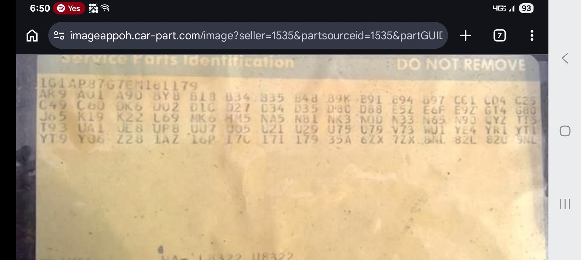

Originally Posted by budget builder
Less than 200 I am willing tto try.... if this dont work ill run this till I get a fourthgen rear and stuff 3.90s in it with a good locker and disk brakes. Here's the info I got....
This Camaro is a 1986 1985 Z28 with the L69 5.0L H.O. V8 engine and MK6 T5 close ratio 5 speed manual transmission with a 10 bolt rear with G80 limited slip, GT4 3.73 gear, and J65 4 wheel disc brakes. The janky Delco-Moraine rear discs. This was also a customer ordered car RPO code1AZ.
This car is rare being a 1986 L69 5.0L H.O. Z28. They made 74 of these for 1986 with 63 of them going to Canada for the Player's Challenge race series and the other 11 being sold to the general public.
8th digit in VIN is G for L69 and 10 digit is F for 1985.
You can see this car now has a drum brake rearend in it. Someone has robbed the rearend out of this car in the past. No telling what is in it now.
If this car actually is a 1986 model Z28 then it has the SPID label from another Z28. Car very well has had the center console swapped with the SPID label from that car still in it.

Daaaang wolf, good eye. U and sofa just stopped me from making a huge costly mistake. I'll be saving my money to buy real NEW parts that will actually help me get to my end goal. Thk both of you
Old Apr 6, 2026 | 11:30 PM
Airwolfe's Avatar
Joined: Oct 2020
Posts: 1,462
Likes: 713
Car: 1992 Pontiac Firebird
Engine: 5.0L L03 TBI
No problem.
At first I thought you had found a rare 1986 L69 Camaro. Then looking at the SPID label noticed it is for a 1985 Camaro with CC1 T-tops and J65 4 wheel disc brakes which this Camaro has neither of those things being a hardtop with drum brakes.
Maybe a guy robbed the center console out of the 85 Camaro because it was nicer then the one in his 86 Camaro. Guy might have also robbed the L69 dual snorkel air cleaner assembly from the 85 car too. I'd look at it to see if he did if this 86 Camaro at the salvage yard isn't too far out of your way. They aren't super rare but they are desirable. I'd love one for my Firebird.

Did you look at the damper yet?
Old Apr 7, 2026 | 03:46 PM
Posts: 28,022
Likes: 2,496
The damper won't necessarily tell if it's a 383. Specifically, it "could be" a 383, butt still "identify" as a 350 by that method. Butt I seriously doubt it.
In the old daze, the damper would identify it. All 383s HAD TO BE externally balanced back then, which of course includes the damper. In 2026 I'm pretty sure that AT LEAST HALF of all 383s are built with internal balance. The difference is, the original stock 400 used rods that were shorter than stock 350 rods (5.565" vs 5.700" nominal), and the pistons had the same compression height; thus, the sum of half the stroke plus the rod length, is the same in both motors. I'm guessing the reason for the pistons being the same CH, is that GM didn't want to compromise the ring package in any way (thinner rings, pack em closer together, move em upwards toward the piston crown, let the oil ring overlap the pin, etc.) in the 400 compared to the 350, therefore the pin has to be in the same place, so they were left with no choice butt to shorten the rods, which then, since adequate internal counterweights won't fit under the shorter rods, required external balance. With longer rods however, there CAN be enough room for adequate CWs, thus allowing a longer stroke without external balance. All that has to change is, some one or more of the above ring attributes (or some other), to allow the pin to move up higher in the piston. Most modern 383 packages are like this, especially for 1-pc RMS motors. Ext bal 383s are a vanishing breed these days.
OTOH, the cheeeeeeeeeepest thing that GM could sell in a box that said "engine" on the side (not necessarily even "new engine") and nobody would go to jail for fraud, is a SERIOUSLY UNLIKELY candidate for being turned into a 383. Not that it can't, or never has been, or ANY SUCH; only, it's SERIOUSLY UNLIKELY that somebody would buy that cheeeeeeeeeeepout POS they could get, and then hot-rod it that way, which would require a COMPLETE $$$internally balanced rotating assy$$$, which then would destroy THE ONLY good thing about that POS motor (the warranty), which (not to say that this would keep it from happening) would be a significant breach of common sense in several different ways.
Butt all that aside, It Is What It Is, remember? Doesn't make a damn bit of difference WHAT it is, since all it is, is the dumb motive force pushing the body around to the paint shop and in & out of the garage and whatnot, while you're saving up for your 6.2L swap. At this point it could be a 230 CID I-6 or an Iron Puke or the "LT-1" out of a 70 "Z/28", and it wouldn't matter if it got all that other done for you. Doesn't matter what it is. It Is What It Is, whatever that randomly happens to be; no more, no less, no matter.

Yep...it's not proof (if the damper is ROUND)...but it takes...IDK....20 seconds? to look at it? ...and if it ain't ROUND...then 100% chance, it's a 383.
Looking at that old dog of a motor, if it's a 383, 99% it's got an out of balance Damper on it. I'm not visualizing exotic balancing having been done to that thing.
Pretty sure that the OP was wondering if it's a 383. Before pulling the engine and then the pan to see what ya got....if it were ME...you can bet your azz that I would take a quick look a the damper.
IDK...I like to do as little work as possible, then sit back and enjoy a beverage in the time that I made for myself by being lazy.
Yup. Very true. He was indeed.
OTOH, it doesn't matter. It Is What It Is. Sure, we all like to "know" stuff; butt in the end, "knowing" things like that, is all about making decisions for the future. At some point it's like the people that want to look up the suffix code on their transplanted engine block to find out "what their engine came out of". Sure, we'd all like to "decode" block "codes" on random engines, butt what difference does it make on some random mid 70s 350 or the like? Does that cast iron "remember" somehow its former glory days as a 76 Malibu 350 2-bbl? Is that gonna change what cam you're gonna order to get rid of the "300HP 327" POS that some yutz put in it without raising its compression above 8:1? Does it change what heads will fit? Does it determine what exhaust system you need to hook up to it or what carb or FI system would be the best to use on it? NO. In this case however, since the OP has no intention whatsoever of using this engine for ANYTHING in the future, it doesn't matter. Since his avowed intent is to swap in something COMPLETELY else and using no part of it, IT DOESN'T MATTER. It's a chase after shiny things laying out there in the weeds somewhere well off the straight and narrow path leading to accomplishment. It's a useless distraction that provides him no benefit.
My favorite kind of work is the kind I don't do at all. I like that even better than the kind I can get other people to do for me. Sure, if I HAVE TO do some, I'd also like for it to be as little as possible, and eeeeeezy and painless and whatnot; butt if I don't HAVE TO, I'd just as soon NOT. Which is my point here: NOT ONLY is determining whether it's a 383 or not irrelevant to his future with the car, BUTT ALSO, anything he can tell from outside the engine, is INCONCLUSIVE, except in the unlikely case that the damper is for ext bal. Meanwhile, he's got the cheeeeeepest "new" engine he could possibly have, which somebody that bought that, is highly unlikely to have done anything to "improve"; that kind of buyer generally chooses such a motor for the warranty that comes with it (MUCH more comprehensive than a "rebuild" would usually have), and is typically looking to buy it, slap it in, and drive the car, not totally gut the block (thereby voiding the warranty s/he paid extra for) and replace its entire innards for "performance". Although of course, we have no way of knowing that there aren't 2 POs involved; one that bought & installed the motor and later sold the car or the motor on, and another that used THE BLOCK as a platform to build some whole other motor onto. We don't, for example, know what heads are on it, which would be another potential indication of later re-use. Butt in the end IMO the whole "383" bit sounds like typical used-car-seller drivel and diarrhea of the mouth, designed to ensnare and deceive.
So yeah, he could go ahead and look, and MAYBE he'd see something conclusive, butt whether it's a 383 or not doesn't change the goal of his project in any manner way shape form or fashion, and as such is just a waste of time and effort, diverting him from his actual project. If I was the betting kind (which you know I'm not) I'd be willing to bet that he'll find a neutral damper, which tells him nothing, anyway.

Damper is completely perfectly round
Old Apr 8, 2026 | 07:13 PM
Posts: 28,022
Likes: 2,496
OK, so not an ext bal 383
Maybe an int bal 383
99.9999% likely it's the "Goodwrench" 350, unaltered; and all the "383" monkey spank from the seller is just that, monkey spank

• The damper is perfectly round• The water pump is not plugged on top, its rubber capped and leaking • the fuel line (plain rubber) comes from under the car runs beside the headers in front of the dri ers side head to a plastic fuel filter and then 2 short pieces of hose to the carb. • no coolant reservoir • hose barb from radiator to lost reservoir is uncapped• 700r4 TV cable not connected, (car was driven like this)• no power steering pump• steering gear not plugged (car was driven like this) • Carb has no air filter (driven open)• original fuel lines just left open • all original engine wiring stuffed beside passenger header• starter is hit and miss. Spins and then when it feels like it turns engine over• rad cooling fans have no shroud• cooling fans dont have switch, instead they operate off some sort of thermister rheostat 🤷‍♂️• Hatch pull down doesn't work This is just what I noticed in about 6min. LITERALLY
