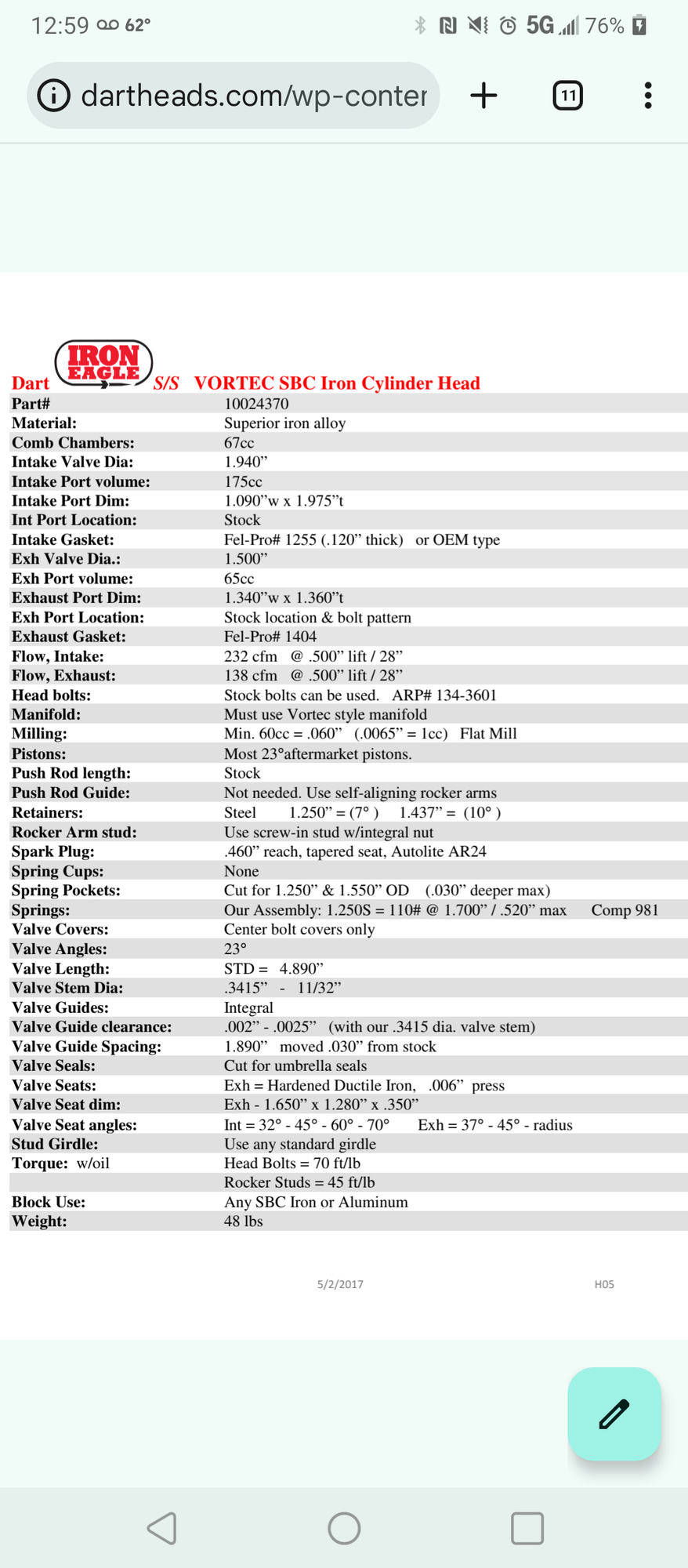

Dart Iron Eagle s/s Vortec Heads. Are these decent?
Dart 10024370 heads
Vortec
175 cc runners
What do you guys think of these? Also, what do you think of this valve job?
Overall the heads look like they'll clean up real nice. I inspected the valves and below is what I found.

Interesting. I wonder what the story is behind the 165cc claim. I see it all over the Internet, even that article you reference, but the head part number points to the spec sheet here. 10024370. Being 175cc

A quick google search of Dart 10024370 produces this on Dart's own site and says 165cc.
Are there two versions of this head?
Dart has a good reputation, but this statement seems a little strong for this head..."Our precision cast ports and chambers produce outstanding air flow without time consuming porting. " I do like the look of the chamber shape though.
https://www.motortrend.com/how-to/14...rtec-head-test
I get the same sheet.
Notice that you must use self-aligning rocker arms and the valve guide spacing has been moved .030" from stock.
On the plus side, the valve job looks nice.

I currently have 083 350 TPI heads, which are 64cc. Assuming that the Darts will give an ample bump in HP paired with the GM 6492 cam I have on the shelf, how much performance am I leaving on the table if I forgo milling the new heads and plop the 67ccs down as is, once they are cleaned up? 3-5hp? Or more? Also. Will 67cc chambers sound and perform any different? Dart advertises that heads can go down to 60cc, but I was thinking 62cc would be safe if I was going to go through the trouble. It's a 1992 and I have verified that there are flat top pistons with my scope.
