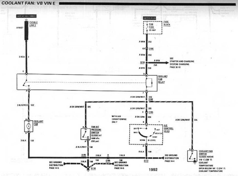

I’m installing a fan controller on my 92 RS. I mounted on the driver’s side up front by the headlights. Where a good source for switched power in that area. Any suggestions?

Looks like unswitched or power is fusible link E, and switched or control might be the fan fuse circuit.
