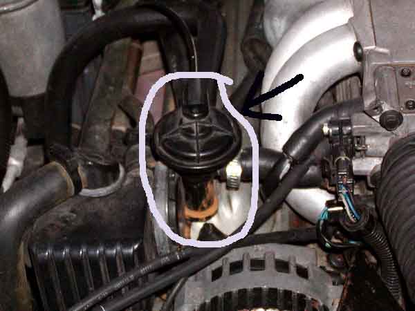

Please tell me what this part is, It has one vacuum hose attached as well as 3 water hoses which go to the plenum and the fire wall.
Someone told me it is the EGR valve but I dont Think so. Correct me if I am Wrong. This is a 350 TPI 87 GTA.
Thanks.
Prem.

Sorry here is the pic.
Prem

Heater control valve - controls flow to your heater core. Something you will be unlikely to ever need in Barbados :-).
Search the archives for removal info if you want it to go away.

Originally posted by Beast4
Heater control valve - controls flow to your heater core. Something you will be unlikely to ever need in Barbados ...
...but you'd be surprised how convenient it can be to have a warm defogger on those humid tropical mornings.

thanks guys. I might do the removal option since it will also run the the plenum cooler as well.
Prem.

Yeah, good point although I suspect that Barbados is lot less moist than Florida from what I have seen of the Bahamas and Virgin Islands. I was assuming use of A/C for that, but on looking back at his photo I see an alternator case not a compressor :-).
Are you also in South Florida , Vader?
Prem-
Also note that below that valve is the emissions air injection valving. What are the rules in Barbados? Can you take that stuff off?
