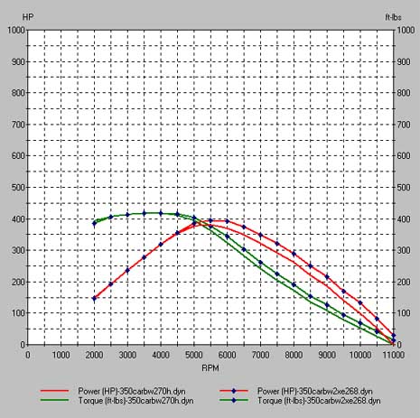

I was wondering what advantages and disadvantages of each are. I have been told that the dual patern cams have larger power ranges. I have also been told that they were more fuel effiecient. Some people have said that the dual paterns should be used unless you have really high quality heads. I was also told that dual patern should be used on mild street engines. I dont know if this was supposed to imply that higher performance engines benifit from single patern or what. I aslo heard that dual patern cams were better for torque. I ran a coupld of tests on desktop dyno. I have a pic attached that shows them. It does seem that the dual paterns power range lasts longer, but it doesnt seem like it has as much torque. They are both comp cams. One is the xe268 and the other is the magnum 270H. Everything else is set up identically.

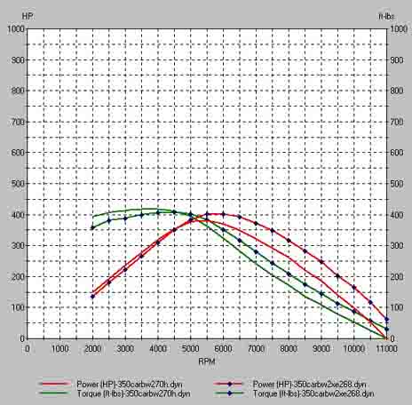

Well, I have to admit, I had the specs from comp cams on the 270H but did not have the valve opening and closing times for the xe268. They just sent them to me today and I changed the 268. Here is the new dyno. It brought the torque up some and still holds the power out a little longer. I am still looking for opinions though.
