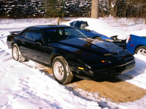

i am building a 406 for my 88 formula.. its kindof a long story how i am getting this motor but to make it a short one a guy i know of he had the motor had it rebuilt and then decided he didnt want it took it to a local machine shop and sold it.. i know the owner pretty good at the shop so he made me a deal on it.. it went back through to make sure everything was fine in it.. it has forged flat top pistons.. and he said that when he was tanking the block and honing it he measured the cam the specs are 451 on the exhaust side and 464 on the intake.. does this sound like a pretty good cam?? he said it should have some lump but not overly crazy does that sound bout right?? and i am putting vortec heads on it with edelbrock air gap intake and still pondering on what carb.. how does this motor sound to u guys?? he said it should pump out around 375 hp.. does it sound like a 12 sec car?? hope so cant wait!!!!
