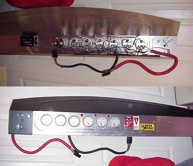

Autometer make a few electrical full sweep gauges. Get a catalog, and check them out. I saw about 6 or so under there UltraLite section.
I prefered electrical gauges on my racecars dash.
It allows a cleaner installation (I guess ? see pic), and allows me to hook up the gauge warning box. Now all of this came at a price I think my dash set me back about 750 bucks, and took some time to make, but it was fun .
Ron

Hm, so should I change my message to say "old-school racers" or "some racers"? Looks good!
