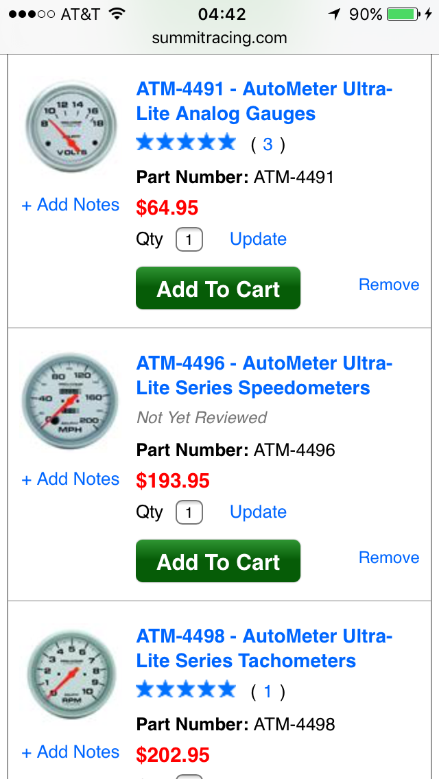

Re: Estimated hp and ET?
So here is a list of the parts I plan to get to finish off my build. Alternator, locker, wheels, and tires first. Then shifter and possibly valve body depending on how mine acts. My current valve body doesn't require vacuum modulator, kickdown linkage, and holds gear until I shift so I think the shifter is really what I need. Then gauges. Finally, I'll step up to better heads and intake. I did get my 770 Holley competition carb fixed. Anyone want to weigh in with what they think or if what I've selected will work?
Edit: could not use link
Plan to mount one size on 15x8 and other on 15x10.
I think this locker will bring down my 60' times while still allowing me to turn.
Don't think I'll need the valve body, but I found one just in case.
