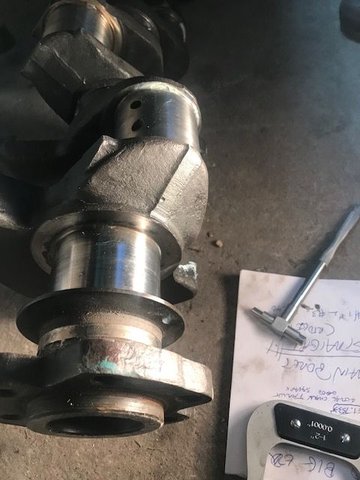

Aquired a great 355 block with perfect 4.030 bores for a song withh a steel 350 crank good rods and high compression pistons all disassembled..
Something minor ran thu this right after it was built years ago by some one else and pooched the mains and slightly scored the crank very minor ( I used to be a crankshaft grinder myself for a decade)
The seller knew little about it to my benefit.
My problem is apparently todays 2020 auto parts guys and the internet can't provide me with a byte of information I need to check out.

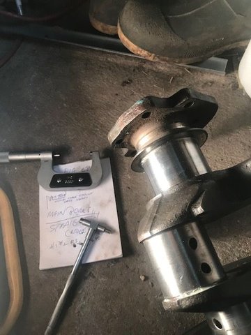

The thrust bearing that was in the block was badly worn on one side. The crank mains are .020 and look very good. Thrust is clean and was touched up with the stone but I can't figure out by how much. Great radii and near max grind BTW.
The measurement across the crankshaft thrust itself is 1.749"
A machinist at Cetus Automotive in Calgary said the stock dimension should be 1.724"
I've doubled checked twice! I have mics and snap gauges and I can read them.
What should the stock thrust width on the crankshaft itself be?
I also know for sure these mild steel chey cranks can be weld repaired on the thrust relatively easily, if need be.
BTW the block main saddles are straight as are the untouched decks.

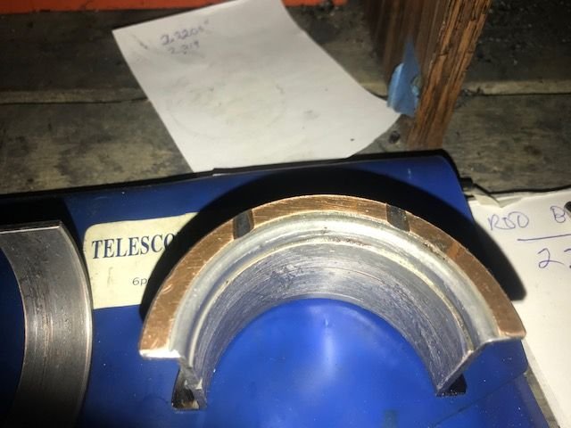

A force from the rear (super heavy-duty clutch, ballooned torque converter) would push the crankshaft forward and wear the rear flange of the thrust bearing.
I can't imagine how there could be a force from the front. Which surfaces on the bearing and crank are worn?

I do not know the history of the short block other than it sure wasn't run for long. Zero ring ridge zero piston skirt wear. To be sure its the back, clutch side of the thrust bearing worn out badly at least .020 itself. There is NO corresponding wear on the crankshaft thrust. At all. So I don't know the actual engineering factory dimension across the rear main thrust and it would be helpful.
See pics the bearing is wiped out yet the crank thrust looks fine..definitely kissed with a staone when the mains were ground....but is it acceptable? Is it ground to far? That's my question and I do have a set of main bearings coming so will find out sooner or later.

Found it myself.
Took forever to trace the numbers off the old thrust shell and find an ACL bearing catalog site with just enough info to help.
1.724 is the stock dimension. The shells are 1.718 stock and it appears +.020 and +.030 oversized thrusts are/were available and perhaps this was one. The crank thrust would be .011 (max) IF a .020 over main set with a +.020 thrust was used and that appears possible.
I'll look at welding it back carefully and having the thrust reground back to stock. Its actually obviously a lot easier to repair the steel than if it was a cast crank. Of course I could also crack open my wallet and pick up a Scat crank for about $300.00. Cdn.

This looks almost identical to my friend Doug's 400 SBC that I mentioned earlier, except that the journal surface of the bearing was fine - only the rear thrust part of the bearing was wiped out. New crank, new bearings, proper clearances, .006 thrust clearance and it happened again. Only took 1/2 hour on the test stand. Never did figure that one out.

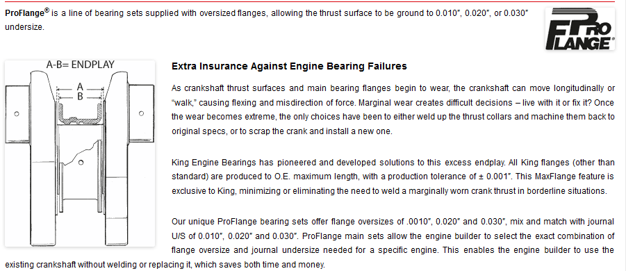

I found this on the King Proflange bearings:

Thanks for the help. I read a string by Ruskbucket from a decade ago that mentioned bearings that were available. I'll be checking that out. From my measurements with a .020 main with a .020 over size thrust I should be good to go.I should get away with about .009 end play.
Strange that happening twice on the same engine. No one likes a mystery and one would hope there's an explanation. The rear seal main bearing surface is supposed to be 1/2 thou lower than the other mains on an SBC. Maybe it wasn't enough clearance to start with??? Just spit ballin as I've never encountered that problem.
I'm pretty sure from the rest of the bearings and a few tiny marks on a piston that something minor and very fine ran thru my engine explaining the failure. He may have "dusted it" as they say in the diesel engine world when air filtration screws up.
