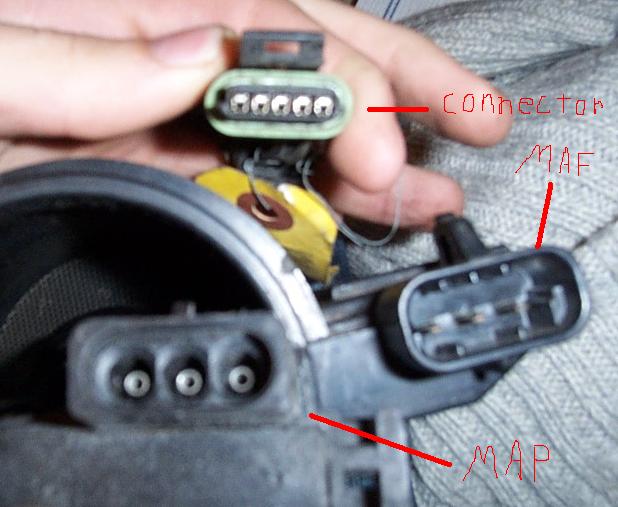

I bought an lt1 intake, MAP sensor obviously wasn't gonna fit the connector of my 87 wiring harness, So i bought a MAF sensor...it also looks like there's no way it'll fit...wtf? What MAF sensor do i need?

if you have a 87' and tpi you will need a tpi MAF sensor. the lt1 map(speed density) is not needed since you have maf. the maf you pictured if from a v6?. save yourself the trouble and get a tpi maf.

aight, thanks, i wasn't planning on trying to make it fit, i just must've spaced that it was a MAF from a v6 when i bought it....oh well, one more twist in the path to EFI
