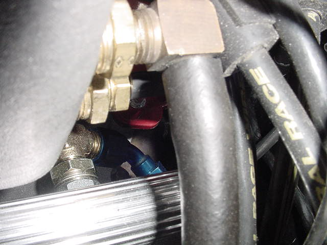

I have had the car done for a couple of months now, but i just finally got around to getting a new wire for my digital camera. If you are looking at this post and say I have already seen this pic, you are right, but the first time i messed up and i just wanted to get a couple of pics up here so everyone can see the pics without it saying something different and getting all confused. But everyone let me know what you think, everyone have a good day!

That fuel line passing over the rear of the plenum doesn't rub on the hood, does it? That could lead to some huge problems later on.

As for the fuel line rubbing on the hood, everything is clear on that, there is plenty of room under there, that was made sure of before the car even moved out of the driveway.]

the other thing i noticed was the pressure regulator mounted backwards. i guess so long as it's non adjustable it's not a big deal. if it is adjustable, then turing the screw might be a little difficult. by the way click the green banner.

You know what, you are 100% right about the AFPR, mine is adjustable and it is a pain in the A$$ to adjust it when needed to, does anyone happen to have a pic of there AFPR so i can see how it goes. I have tried to look around on the internet and find a good pic of how it goes but i just can't find one, If anyone happens to have a pic it would be greatly appreciated!!!!

Simply remove the 2 bolts and flip it the other way. You might have to redo the fuel line ends, depending on how you wanna have the line routed. Here's a pic of my return line setup:

Looks nice!!! I really like the HSR. I have been running about 48psi with 30# Accel injectors. Just flip your AFPR around to make the adjustment easier. And do something with those fuel lines. No offense, but at least try to hide them!! Just my $.02... BTW, I like those valve covers, I have the same ones in chrome...

Just to let you know, i appreciate your two cents, i just did that to get the motor together and running, i was going to take care of the fuel lines by running them on the fire wall, but i actually like the way that you can see the fuel lines, I actually think that it accents the motor, and for the AFPR getting flipped around, that is the next thing on my list to do, i don't know why i didn't do that form the get go, thanks for the remarks everyone!!!
