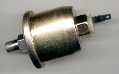

OK, this is what I got is suposed to be the "Oil Pressure Switch". I havnt looked on the back of my engine for it but when I do Ill take some more pictures of the location for further reference. Hope this helps someone.

Alex thats the one that shuts off the fuel pump on some cars when the oil pressure is really low.
What you need is called an "Oil Pressure Sending Unit" . It shoudl be gold in color and cylinder shaped.

Heres the new one. Hope this is the right one. I looked at the engine & is pretty easy to find, If you stand on the drivers side & look between the back of the engine & the firewall you will see it next to the distributor & is all covered by the wires.

That isn't the oil pressure sender.
This is what is most likely broken:
The gold cylinder shaped item is an OIL PRESSURE SENDING UNIT. That is most likely what failed and has happend to my car and many others, plenty of times.
Unless I misunderstood what you were trying to say?
The black and silver part is the oil pressure switch that turns on the fuel pump.
Just to clarify.
Hmm... That's odd, because when I swapped the black and silver part my pressure reading was fine again. And when I went to autozone and asked for an "oil pressure sending unit," the black and silver part was what was sold to me.

Hmm is right, Thre are "some" pressure switches with the senders built in. (more pins in the connector)
I thought they were only used on LT-1s.
But I've been wrong before.
The pics represent what I have currently on my L98.

My "silver and black" piece has 3 pins, and based on the wiring diagram it seemed to be doing both jobs, but I can't verify that.

The oil pressure sending unit changed depending on the year car you have. On the newer thirdgens (not sure what year the change was, but 89 sounds about right), the sending unit is no longer next to the distributor, but is located above the oil filter on the block. It will look like the black and silver piece pictured.

Problem solved! I installed the gold one and it fixed it.

Well, I decided to pull the oil pressure sending unit to see if that's my problem. I had to jack the car up to be able to get under it as I couldn't get it off from the top side. Also, when I pulled the unit off, there was oil coming out of the part where the wires plugged into. I'm not an expert, but that doesn't seem normal. What do you guys think? I just finished pulling it out, so I'll have to wait till morning to get the replacement. Hopefully they have it at AutoZone!

Well, it worked. Pressure goes right up to 30 without fluctuating. I'm a little concerned about the replacement sender tho. It looked nowhere near the quality of the original part - has way more plastic. I guess now I need to drain off a little of that oil I added.

This is what you need to know,
Sensor connector:
  1. One-wire is oil sending sensor for gauge. Thread must make contact with block to complete the circuit.
  2. Two-wire sensor is a power switch which is in parallel with the fuel pump relay. It is isolated from ground - Sparky, ya know what happens when a hot wire touches ground!!
  3. Three-wire sensor is gauge and switch. Guess they finally figured how to put Items 1 and 2 into one unit.
So which one(s) do you have?
