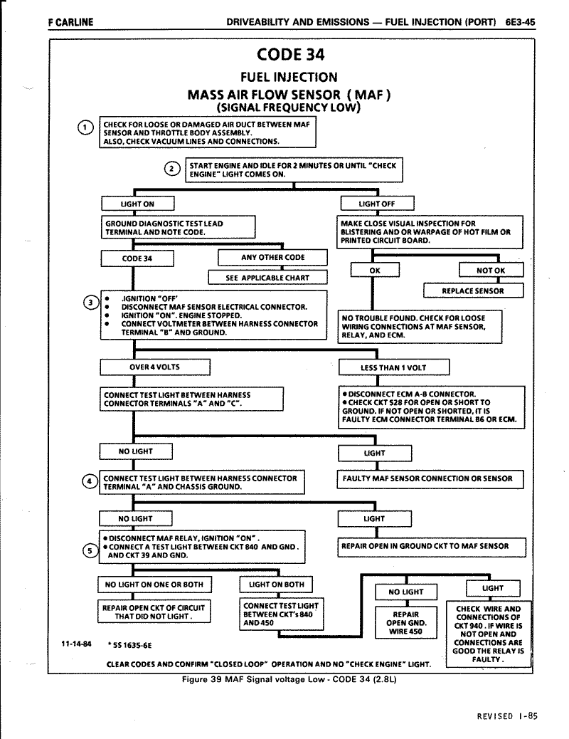

Engine: 5.7L TPI
Here is what his code 34 means along with a trouble chart for it.

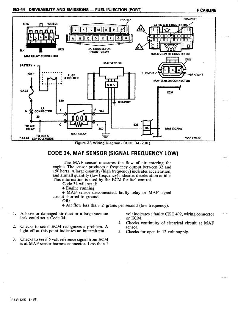

Engine: 5.7L TPI
page 2

Well, what can I say, I really appreciate what you did for me guys, thank you guys very much for all your help!!!! I just found out that the brown wire that goes to the MAF relay had not power, and following it up to its end, I noticed that the fuse was broken. I am gonna try what happened to you Joey IROC, it is a good idea to take a look to that hose in case that it could be a future problem.
