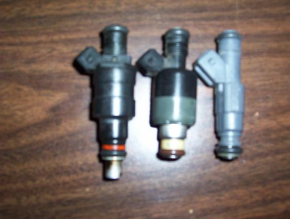

The LS1 injectors are maybe 1/16 shorter than the LT1s. Whats important is not the overall injector size, but the distance from one o ring to the other o ring. I don't see any reason why you can't use them without grinding the rail mounts if you use the injector clips. I am going to try the LS1s as soon as I get my block back from the machine shop.
Here is a pic of a 22 lb TPI injector, a 24 lb LT1 injector, and a 25 lb LS1 injector.

I guess I should be a bit more clear in which injectors I was refering to. yes the 28.5 lb/hr units will flow 24.5 lb/hr at stock pressure. the 22 lb/hr I was refering to initially was if you buy the 25lb/hr ls1 units that SLP sells. to get the 28.5 units you will have to purchase them else where. as for the griding when I put them I could still see the o-ring sticking out of the rail. I did not care for that as it might be possible to push fuel past the rail. the original injector clips won't fit and ls1 injector groove doesn't go all the way around as the stock injectors did. you can slide them up but then the injector is not fully in the manifold so you may not get the best spray pattern possible this is why I chose to take about an 1/8" off the rail mounts to better fit. to show this here is a pic of them installed before I ground down the mounts.

The LS1 injectors are rated at 4 bars, not 5, as stated above. 4 bars is 58psi. L98 and LT1 injectors are rated at 3 bars or 43.5psi. Obviously, GM is using 1 bar to be equal to 14.5psi.
Also, the LS1 injectors are exactly 0.10" shorter from o-ring to o-ring. So, I would strongly recommend that the fuel rail mounting posts be ground down 0.10" or risk a huge fire and destroying your car.
There are two fuel rated LS1 injectors, 26.4 and 28.4#/hr. It is my understanding that the SLP injectors that are for sale are the 28.4#/hr. So, just a helpful warning to those who might buy LS1 injectors off of Ebay or some other place, be careful of which model year the LS1 injectors are out of. If you got hold of the 26.4 LS1 injectors, they would flow 22.9 #/hr at 43.5psi, as opposed to 24.6#/hr.
