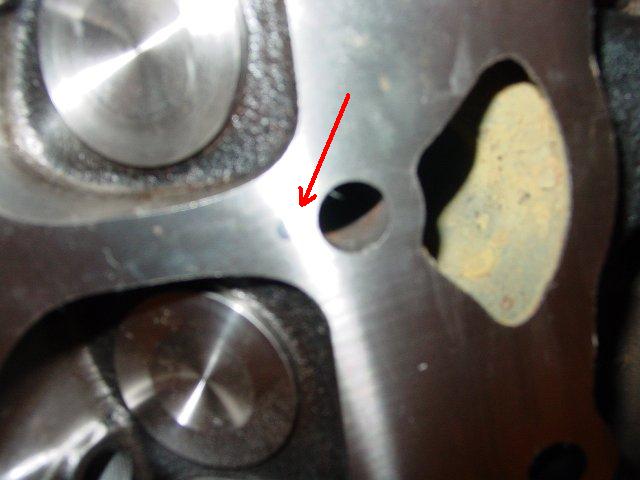

after bolt ons, there's no such thing as just ONE more part
My L98 heads turned out to be cracked after I had them magnafluxed, but they were repairable. I had them 'pinned' where they drill a hole at the end of the crack, screw a plug into it, and surface the heads flat. This is a pic of my head. The arrow points to where the pin is (you can barely see it, it's darker colored). The crack started at that bolt hole and was running toward the combustion chambers.
