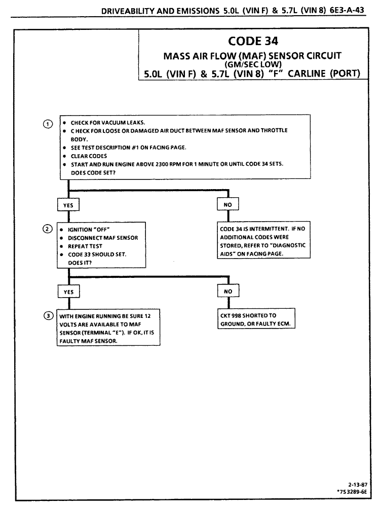

Try this chart for your code 34 and see if it helps any.

page 2

The MAF was not the problem! It was working fine all-along. The car showed a Code 34 ONLY BECAUSE OF A ROUGH IDLE! Thanks to the guy that posted the diagnoses procedure with diagrams, this was found! (Note: The MAF is supposed to receive a 5V power supply from the ECM. When I measured a low voltage as stated in my original thread, I didn't have my test set-up properly).
Now for the fix: The cause of the car shutting-off unpredictably at any speed was a BAD IGNITION PICK-UP. In addition, This car had a weak ignition coil that was making it start hard and not run as smoothly as is should. The ignition coil problem had been found first and the car stopped giving the Code 34 once that was fixed but continued to shut-off unpredictably. Once the pick-up was replaced, the car ran like new. (and continues to run like new)
