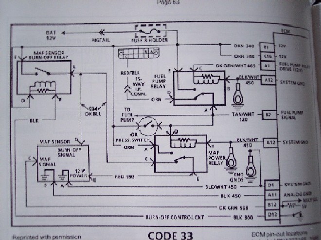

I will get you a PIC of the Circuitry for your MAF application tomarrow.

Here you go. Copy to your PC and resize it if you can't see the circuits. If that doesn't work I'll try finding a scanner.

Thanks alot. I'll give it a shot when I can get some time to troubleshoot. I didn't get a code on my way home today from work. I don't know what is going on with it.
