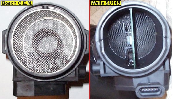

The replacement Wells SU-145 is a new part, not remanufactured. Very much like the later Hitachi, LT1, and LS1 units, it uses a thick-film transducer on a single, flat circuit card instead of the sensitive hot-wire element placed in a sampling tube inside the housing that can fail so easily. Because of the reduced switching current required since there is no wire to heat up, it also has no internal heat sink fins. In place of the round wire screens that occupy each end of the stock Bosch sensor housing, there is a single flat metal matrix at the inlet end only to delaminate air flow for a more accurate reading. The I.D. of the sensor body is larger, and the cross-sectional are of the sensor (minus the internals) is a lot larger.
Although the two are not scaled exactly the same, this may demonstrate the differences:

So now I have no use for a burn off relay and a maf power relay, so how does it get wired in? Is it a straight swap? I believe my stock bosch is a 4 pin?
Old Jul 4, 2005 | 07:57 PM
Vader's Avatar
Posts: 19,679
Likes: 316
It's a direct plug-in replacement through the same five-pin connector used by the stock Bosch MAF sensor. The power is still provided via the MAF power relay. The sensor has a dummy load and resistor/diode network that provides a signal to the ECM when the MAF power relay is energized. This "fools" the ECM into thinking a successful burn off cycle has been completed, even though it isn't necessary on this MAF. As a result, the ECM never stores a fault code.
All that's necessary is to clamp it in place of the original and plug it in.
