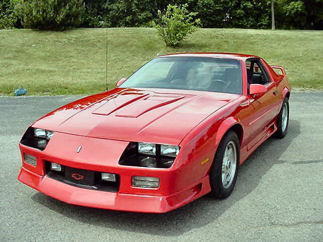

any advice including the proverbial get a gun would be great ly appreciated. I have included a pic of the car....
