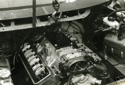

To stick with the topic, I did find another option, albeit pricey. There is a lift plate made called the "Happy Hooker" that can be attached over the plenum. It is made by TPI Specialties. They sell it for $50 and claim it is drilled for LT1, LS1, and TPI.
How To Pull a TPI Engine?-happy_hooker_1.jpg How To Pull a TPI Engine?-happy_hooker_2.jpg
Here is their link: http://www.tpis.com/
They sell on ebay as well.

Interesting. If I was planning on pulling a lot of L98/LTx/LSx engines I'd consider that. Fortunately some hardware store chain and bolts are cheaper and will fit any engine.

Agreed. I'm going to have to spend enough in tools for this project. I may just use the chains instead of the leveler or lift plate. Now if it were $25 instead of $50....

i dont see how that would attatch to a tpi motor though?
