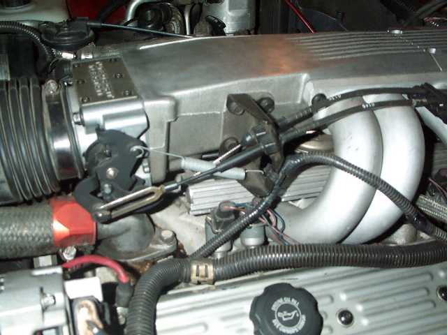

I have a stick-shift so I added one where the TV cable would be on an automatic.
Edit: This is a very old picture before I added the siamese runners.

[IMG]
[/IMG]
Don't mind the crappy install, I didn't trim the spring to look pretty because I was adjusting it.
When you get the spring DO NOT CUT IT. Fit it first, drive your car and see how it feels. Get it set first before you cut it. I found my spring at advanced auto and its one of the stiffer ones.
Its MOTORMITE 59003, Diameter 29/64", Coil lenght 2", overall 9", diameter .054"
Thats one of the many that I tried that gets my foot satisifed.
[/IMG]Don't mind the crappy install, I didn't trim the spring to look pretty because I was adjusting it.

your going to want that spring angle better. like more straight on. I would hate to hear about the binding and a stuck full throttle. instead of in front of the throttle do it from behind like carb setups.

Already tested. This binds just a tiny bit, but does not get stuck on anything. Trust me, that was the first thing that I looked at. If you look at the automatic linkeage there is really no place to hook the wire without binding on the linkeage once you go past half throtle. The whole bottom of the linkeage goes up right inbetween the accelerator cable and the TV cable. The angle is actually not bad at all, and it was the one with minimal bind. Just look at the linkeage and you will see the problems.
