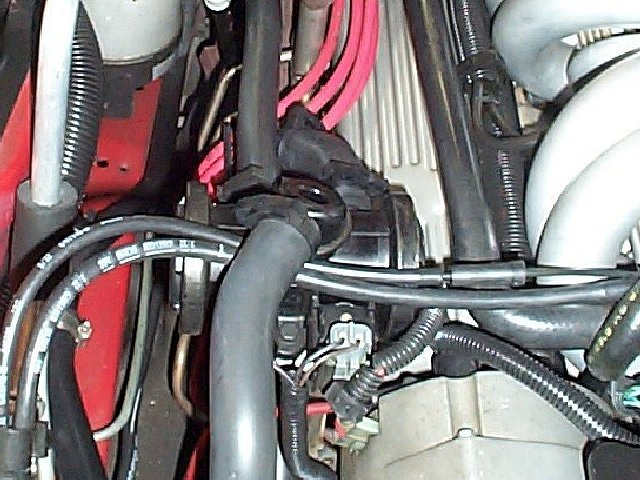

The Air Injection diverter valve can be checked with the air lines removed. As a temporary test, you can simply remove the output hose and cap the line so that no air can reach the exhaust manifolds to dilute the O² sensor gasses.
