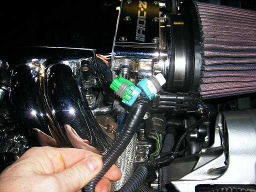

need some help knowing what and where these 2 plugs go.
now I have had my engine in for over a year now, and no problems
just would like to know, any help would be appreciated
thanks

Basically stock wiring? Am I correct in that you are not running w/a MAF sensor? Ill go take a look at mine and get some photos.

no maf this is a 90 firebird harness and engine in a camaro
speed density

okay found this from TPI Parts
the green one says (Air Port Connector, 87-92 TPI, 88-92 TBI)
the blue one is for Air Divert Connector, 87-92 TPI, 88-92 TBI
but again where do they go and what exactly are they talking about
DaySHa..........if you have pic's that would be awesome

come on now....some one has to have pictures of what these plugs go to...
90-92 350
thanks

They went to the A.I.R. diverter box near the passenger valve cover
When removing emissions equipment these are unplugged and hidden in the bay
Signals are sent to the connectors to engauge the box but not returned to the ECM so you wont have to change anything other than leave them unplugged

thanks Pocket
