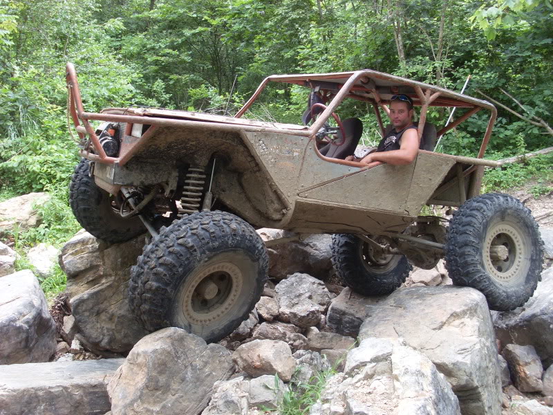

Edit: Just for kicks, a pic of the buggy.
