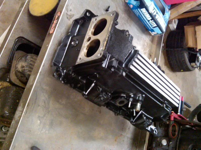

So i took out one of my LT1 intakes and cleaned it up and painted it. I also ground down the front sides where the coolant nipples will go. I also measured my vortec intake and found out that the front 4 bolts and the rear 4 bolts on the LT1 intake match up to the Vortec heads. Its basically an angled vortec intake with 4 bolts in the center. All i should have to to is angle the holes straight down on the outer 8 bolts and it will bolt right up. Now i just have to confirm the intake ports.

Here's some pics of the refinished intake.
